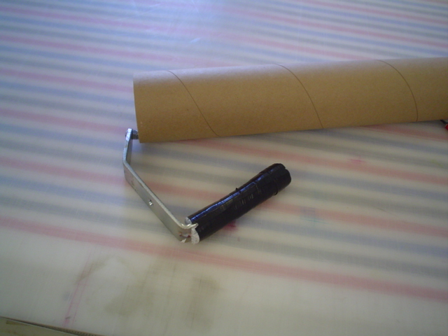

I have thought about having 2 sets of rollers for media on the back of the printer. We use one media 80% of the time and it would be nice to be able to
swap out the other roll with what ever is the flavor of the day. Replacing our printer this winter and am thinking of trying this plan.
Another thought- it is easier to handle heavy rolls with a handle to extend your reach >below> I am average size and above average age and not
as tough as I once (thought) I was.

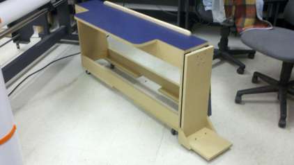

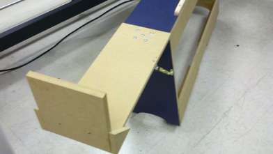

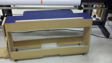

I made a cart for our shop for the same reason as you. We keep the most used media standing vertical near the printer on the plastic end pieces that the rolls come with. My cart uses these end caps to hold the roll while you tip the roll over. Now you roll the cart up to the printer and load the media. Just do the steps in reverse to remove. I hope this helps. I am trying to attach photos of the cart.
