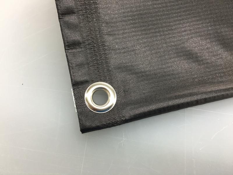

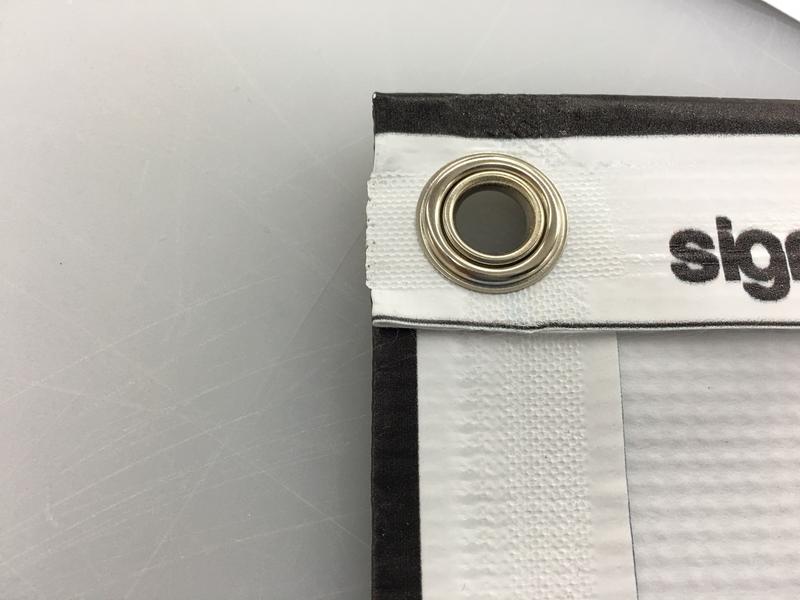

The welds are good. Only time they come apart is if you are running it too fast. Only drawback is the width of the weld is about 3/4". Would be nice if it were a little wider. I'll upload some photos on Monday. I hear they are releasing an updated machine wI the next couple weeks. Pretty sure it is going to happen with the sign show coming up.

Here you go. Machine is still working flawlessly.

Thanks for the photos.
I'd have to agree about poor welds. The bottom of the black banner doesn't even look welded. Are you really happy with it?
chrisphilipps
We sell the unit and have one in our demo room. The strength of the weld can be adjusted by using more heat or slowing it down. As for getting the weld right to the edge it can be done if you adjust the guides correctly. We have sold several units and everyone has been happy with it so far.
