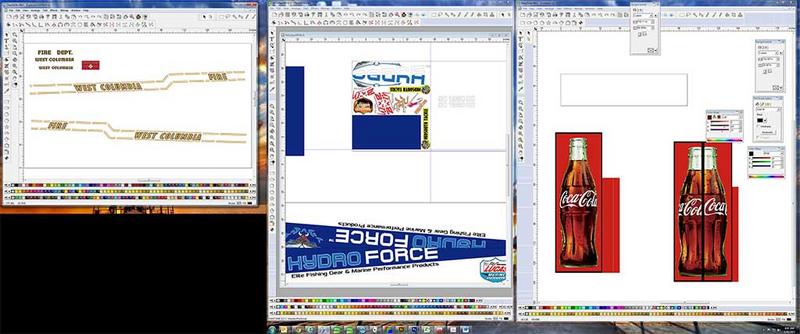

3 Instances of Flexi running all at once (2 on a 30" NEC and the far left one on a Cintiq). 2 right ones are Flexi 11 (Cloud SP6) and the left one is 8.6v2 ready to run some stuff on the Edge...... It can come in handy at times. Had to shrink the image down, I don't think the forums here will display a 3840x1600 desktop very well. lol
I'm not sure what's going on with your setup Ricky. I don't think its a Flexi issue though as even the most current version (as do older versions) can run multiple instances just fine as long as you have the licenses to do so. You have 2 difference instances installed, each with a separate license number. Can you run each of the two one at a time (not at the same time) to make sure each is functioning and using its separate license? I'm thinking it might be the licensing is somehow getting crossed up or something but it could also be something with Windows freaking out with both processes fighting for control or something. I'm really not sure though. Its always just worked for me.
