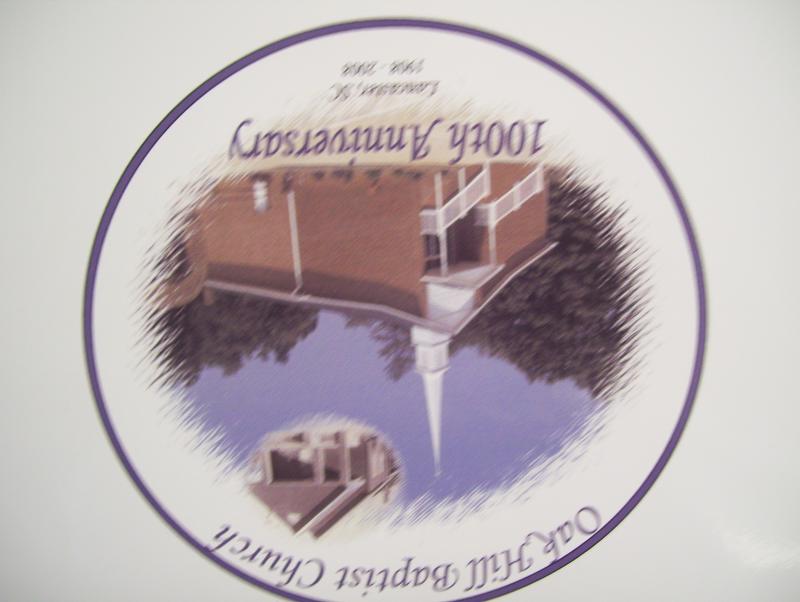

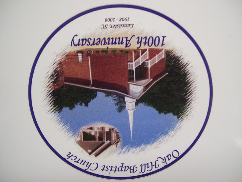

heres a look at the 2 of the options the better one is the straight jpg file.

i have had my vp-540 for a little over a week, and so far just trying to get a hang of the new programs, as i have not had any experience with corel (x3). but i am finding the exact same thing, if i import the file to corel then send to versaworks, the pic comes out lower quality with very dull colors. but when i send the file straight to versaworks, the picture comes out perfect! any thoughts on what i am doing wrong?
