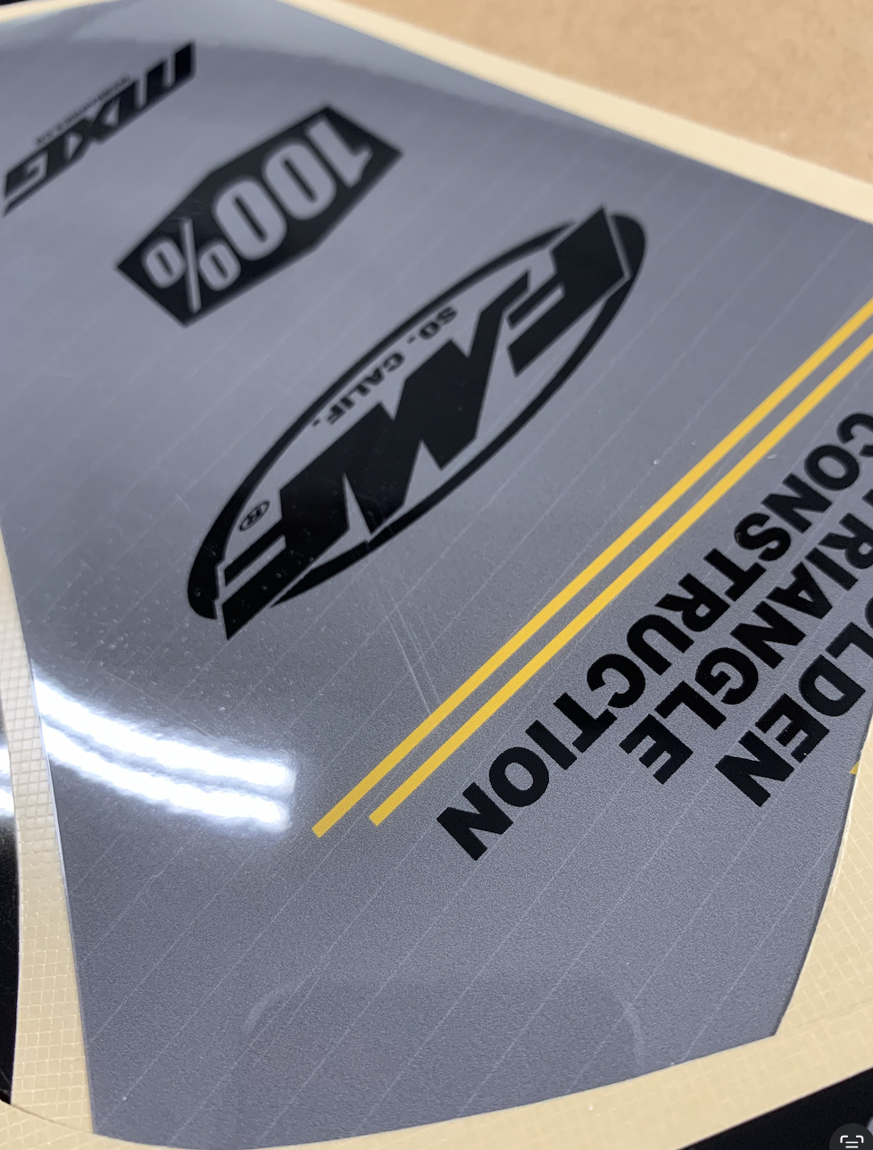

Hello,
Wondering what is causing this (attached picture) to band on S80600. Nozzles are all fine printing on 8 pass not much better on 12 pass.

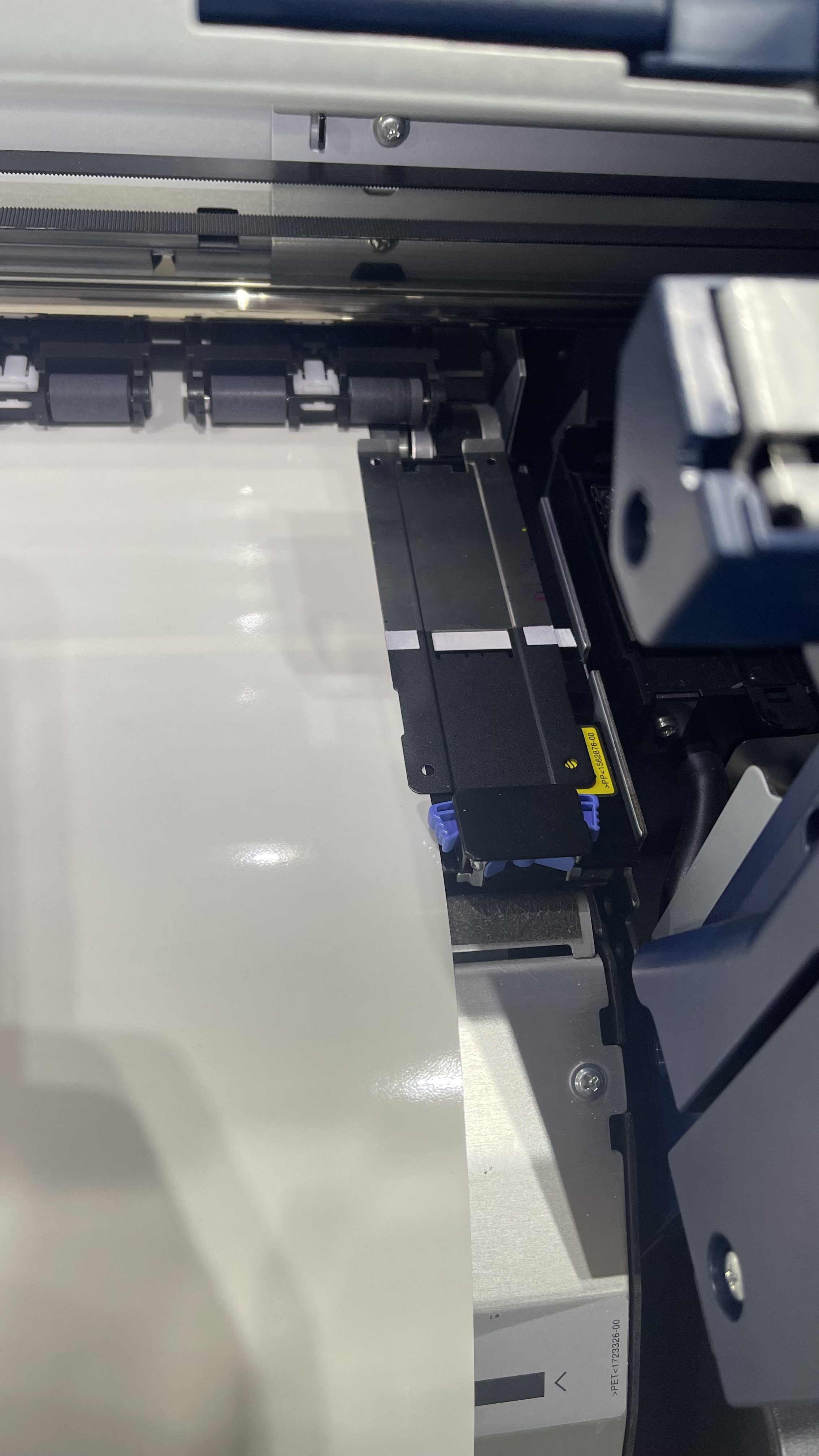

Only time I ever see this is with nozzle outs. Do a good manual clean, and double check that there is nothing that might be nicking the cyan or yellow area. I've had it where there was a small hair on media guide causing the issue, or something on the pre-spray pad. Nozzle check might look clean, but there might be one on the edge that might have been overlooked. One nozzle missing can be a pain for some colors, especially when it's really only 2 colors making it up.

This looks like you did the media adjust without the takeup, then things get warm and you put the takeup, and get this type of banding.
Nozzle banding or ink starvation banding looks a bit different.

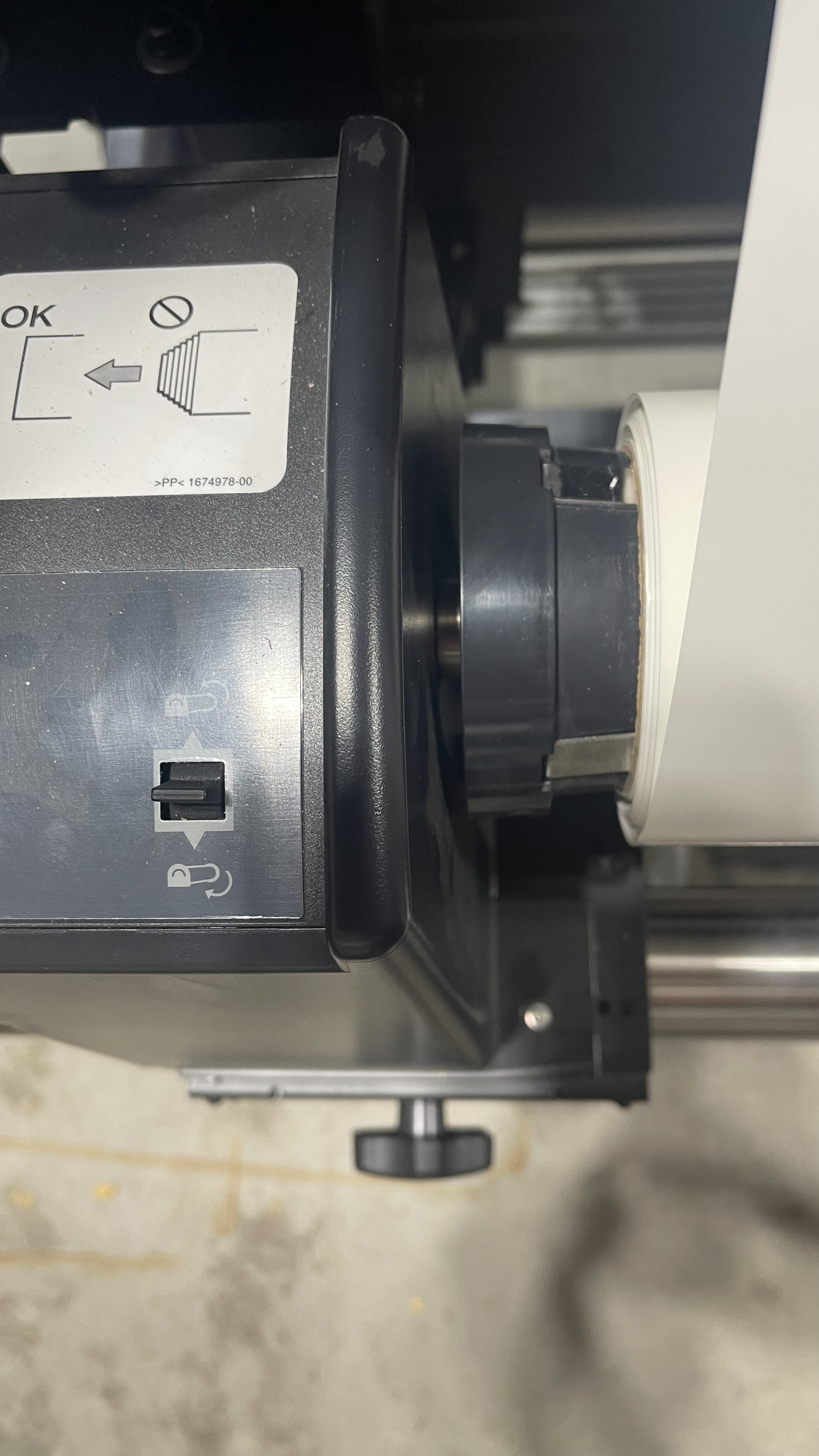

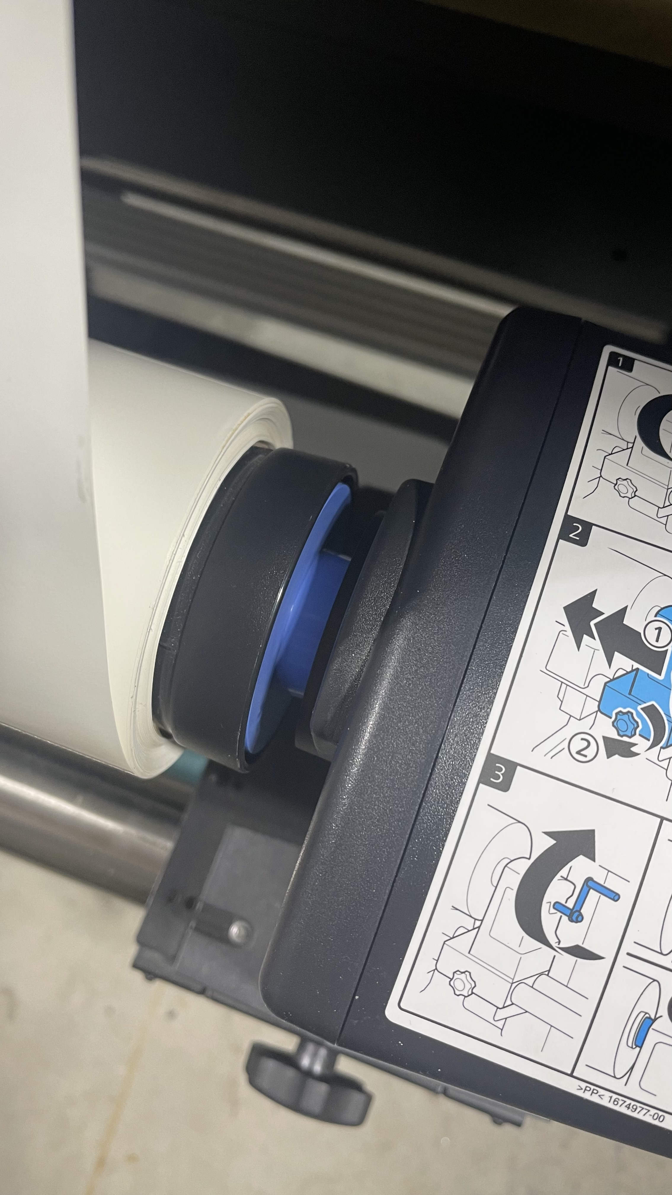

If using onyx, turn gutters on to ensure that a nozzle is not dropping. I have never performed a feed calibration while attached to TUR. Can you send a pic of the right media flange on the installed roll. Do you have that set correctly? If you load every roll of the same media, ie adhesive vine, you should not have to perform that many feed calibrations. When loading roll, make sure you push roll tightly on left flange, then I manually force right flange into other side. Then you have the grey tension flange. I will manually split that width in half bore seeing locking screw that holds right flange onto silver guide bar. Then use tensioner to bring grey flange flush with black.

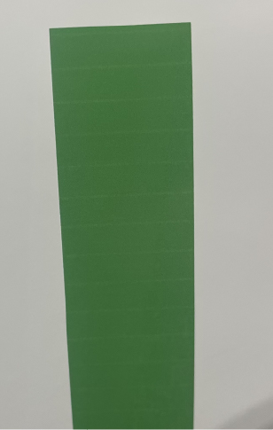

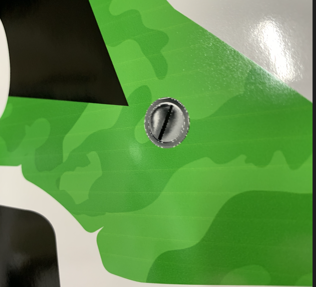

I am having the same problems. Everything is fine at first and then it starts banding in the prints. Before I could just clean it and it would go away. Now it does this on the first print after I clean everything.

The issue is multiple parts with feed calibration. They had to replace the feed motor, the alignment wheel, alignment wheel sensor, the media feed reel (on the back). First thing they did was replace the heads, and were very upset when it did it on the first print after. If you want to do a fun test, Print a 4ft ruler, with up to 1/4" markings. You will find that after about 21" the measurements are no longer accurate. This was the test I had to do to get them to realize it was not a media setting or file set up, or print head or onyx issue.
