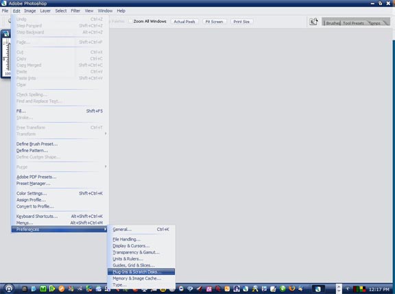

Also....
don't know if anyone touched on this...periodically I will
create a new file 1 pixel x 1 pixel @ a resolution of 1 and save that file to my C
drive. Supposedly clears out PShop stuff.

TVG, could this be a part of the problem? In Edit/Preferences/Plugins/Scratch Disks it says "Start up" in the First box. Should that be changed?

TVG, I tried changing it but it doesn't seem to give me that option. Just Start-up or C:/
When I mouse over, it won't allow changes. So where can those changes be made, do you happen to know?

Second... It helps if your scratch disk is on a different hard drive. But that is not mandatory. That scratch disk can be on ANY hard rive. And yes,, that list is where ou can set your scratch disk.
