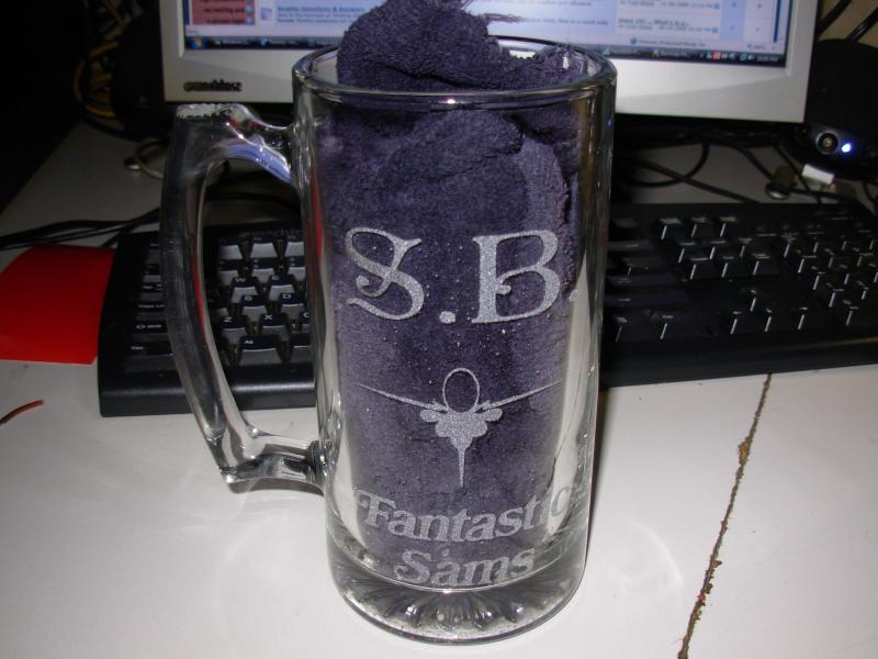

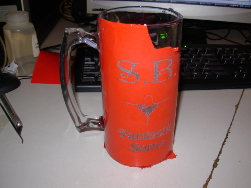

For the small stuff, Avery works goods.
Atleast it's good for something.

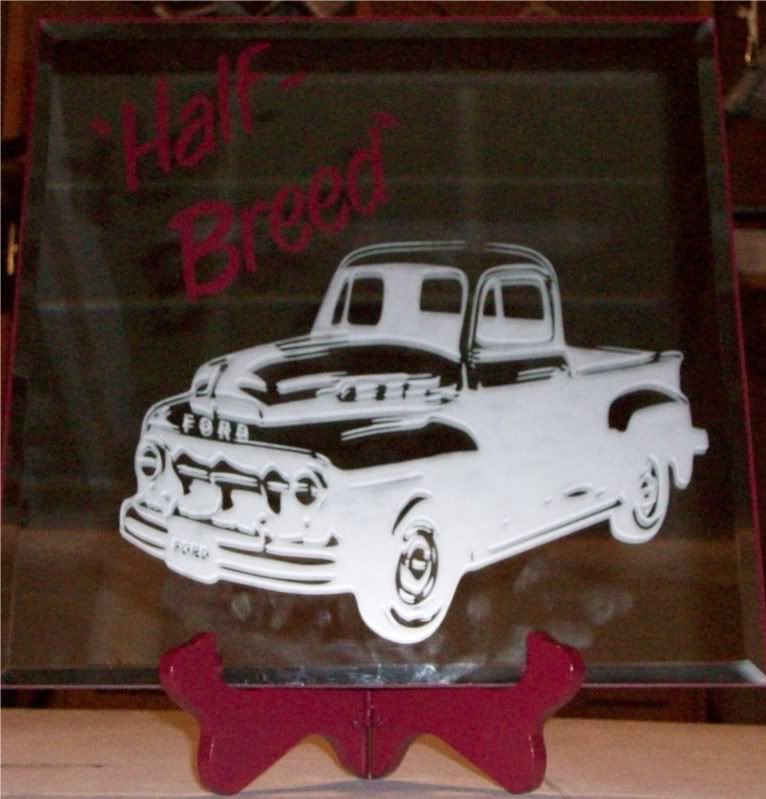

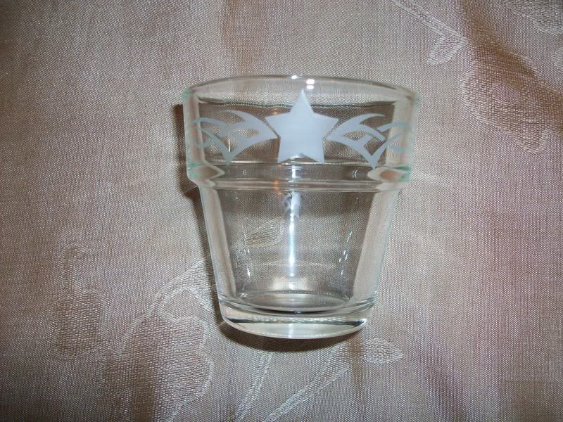

it's relatively simple to do. i just take a decal and reverse weed it and slap it on whatever i want to blast. i use a tool, if you can call it that, called an air eraser that i bought from harbor freight. i blast with 220grit aluminum oxide. comes out very smooth and leaves crisp lines. here is a mug, candleholder, wine glasses and then a mirror i did for my father in law that i blasted the truck on the front of the mirror, then i reversed the decal with the name and applied it to the back of the mirror and then blasted it and painted the name with spray paint. the picture is horrible of it, but you get the idea of what you can do.
