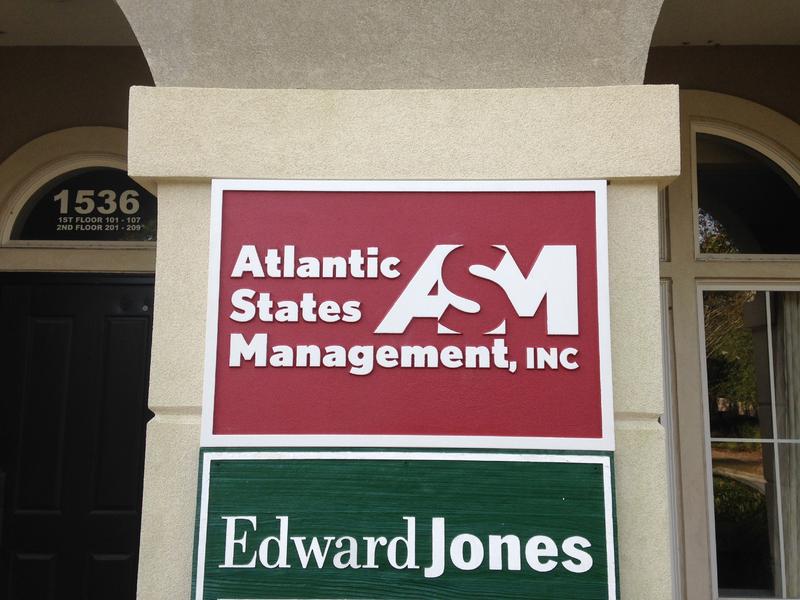

I am usually using play sand.
attachment.php
one coat of paint to hold it and two coats to seal it.
