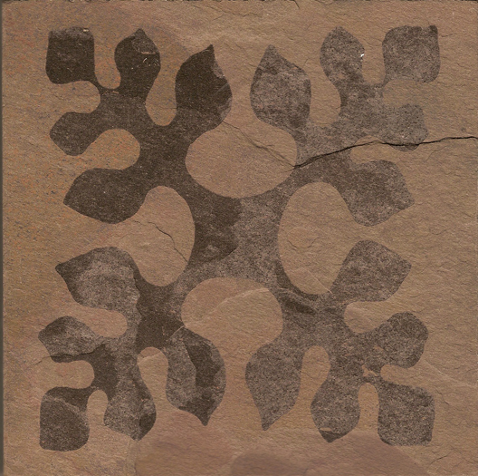

not sure if this is even relevant, but I had a laser engraving sample done on a piece of tile, that looked like slate.
It looked pretty cool to me.
It wasn't done to any depth you could even notice though.
On your slate project, I'd ask the friend if he had a scrap. Is it a dusty porous surface that will be difficult for the mask to stick to? Maybe a sealer of some kind would slightly change the color & sheen before you blast, while also giving a better surface for mask to adhere to... and then the blasted portion will have a better contrast without painting...
...OR, with better adhesion on the mask, you could then paint the blasted area through the mask with less care required on your edges. Having a scrap of extra slate would allow you to test these theories...
