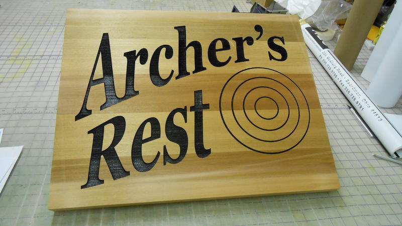

yesterday i blasted my first cedar sign.
i bought a ready-blank from Allwood.
it's looking pretty good so far, but i wanted to know, is there a standard depth?
all the blasting i've done so far, i've pretty much just gone with what i thought looked good, but i wasn't sure if there is some rule of thumb about the depth of carving?

Billy - any finished photos? :rock-n-roll:
it's not quite finished yet. but here is where it stands right now
we're going to add color to the target and put some arrows in the bullseye

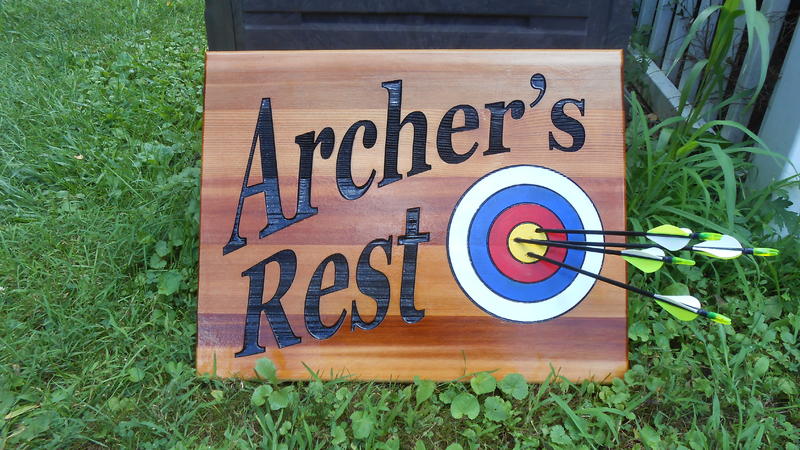

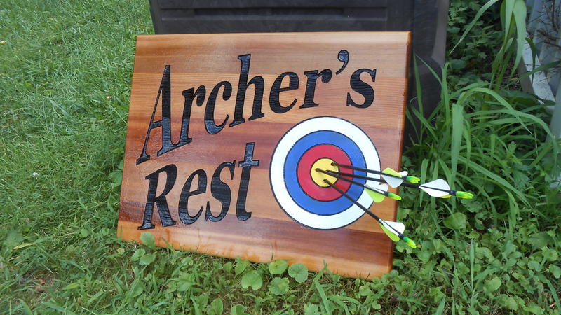

Final product!!!
had some requests for a photo of the finished product. here it is folks. first attempt at blasted cedar.
customer loved it
