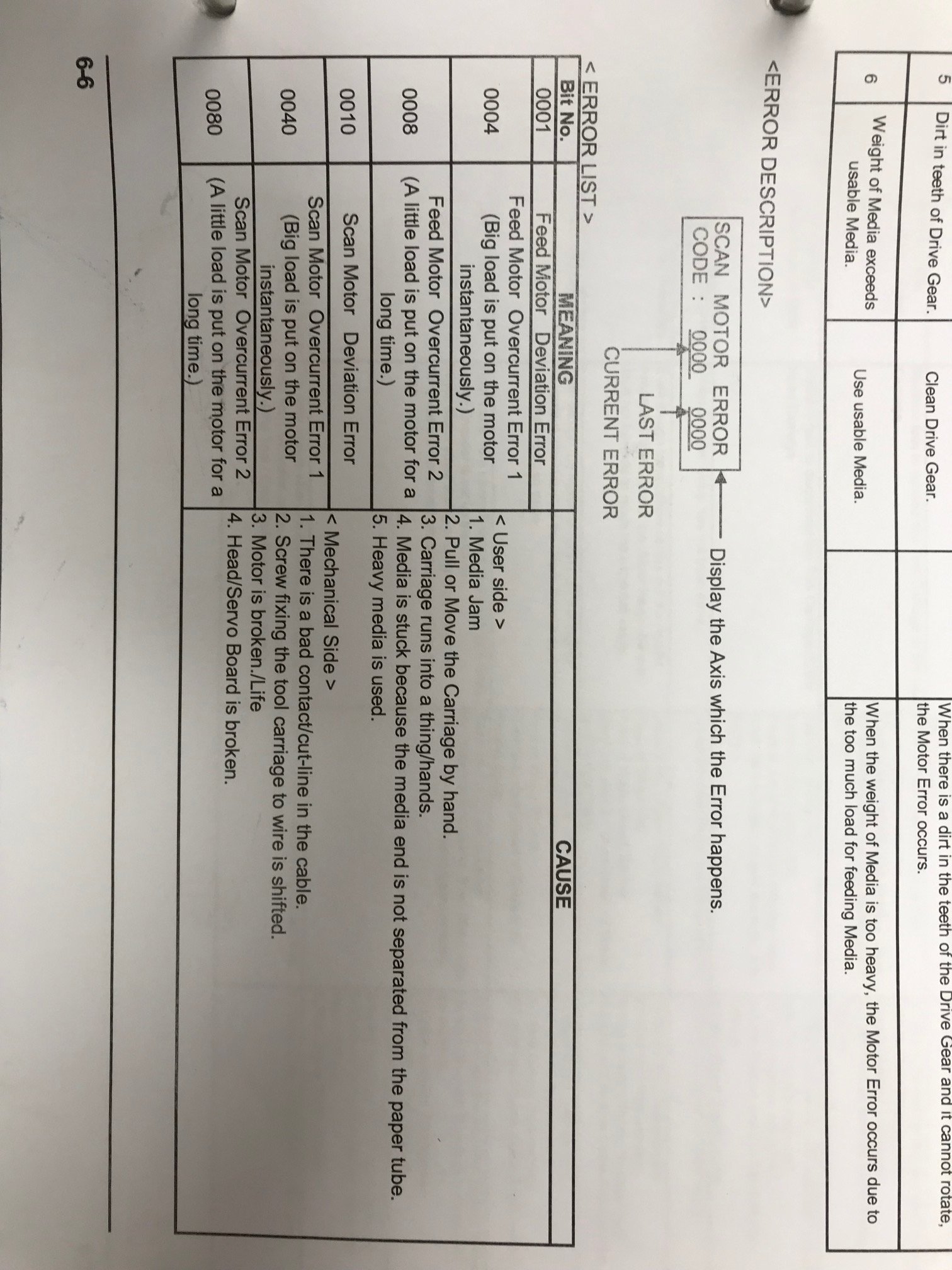

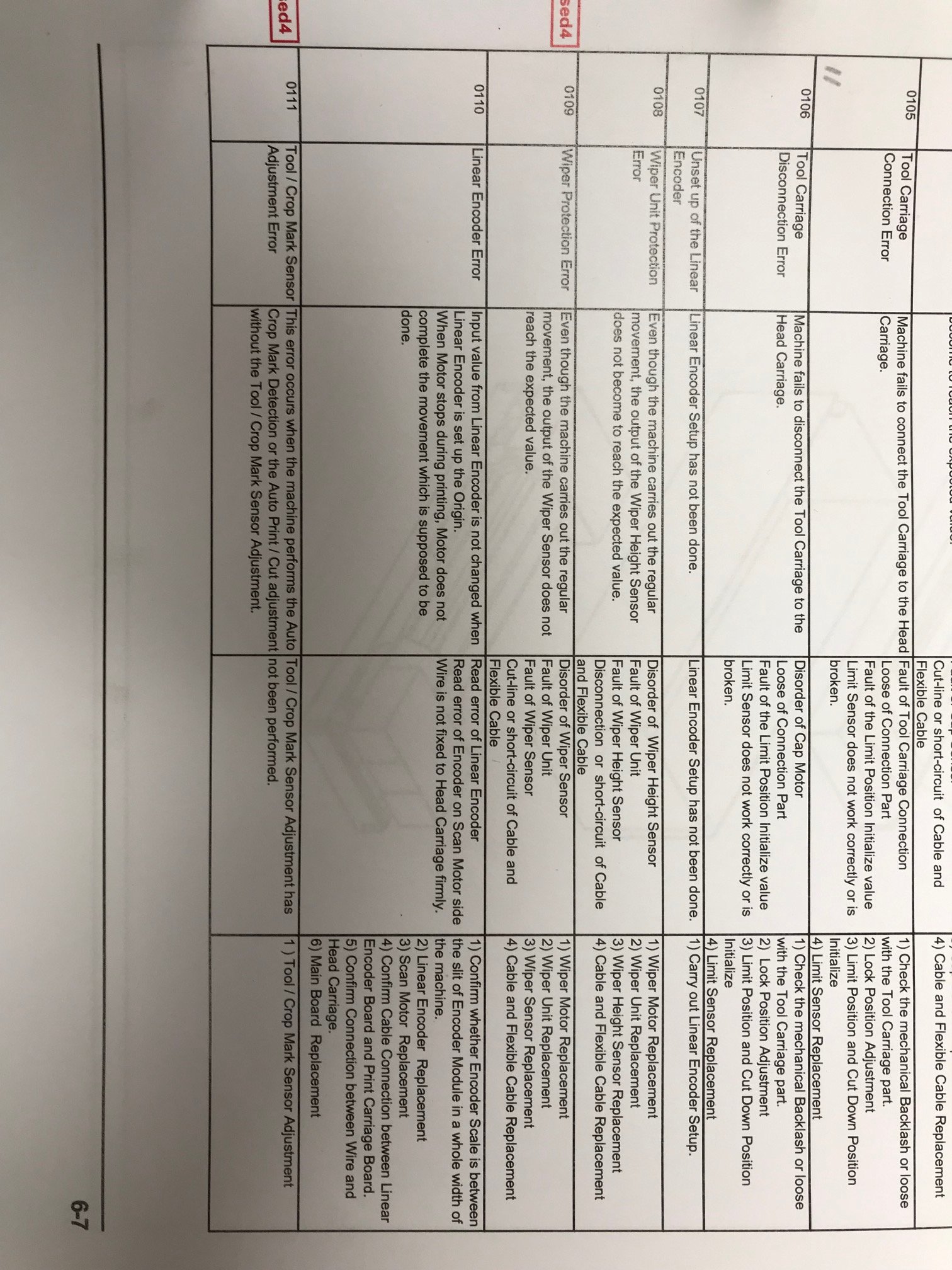

0010 is the scan motor deviation error
see images from service notes
