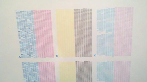

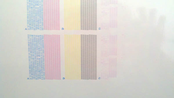

I got my dampers switched. The first few test prints, no change. Did some cleanings. Eventually my lm gave out completely. And my lc slowly started magenta with about half the nozzles showing on the test print. I have done a zillion test prints and cleanings. My lm ( now in the right place) is coming through half way and what is supposed to me lc is only showing 7 tiny specs on the test print and they are still magenta. Would this have clogged the heads that bad.
Melissam2505
Here is a test print soon after switching the colors and what I am getting now after many other prints and cleanings.
