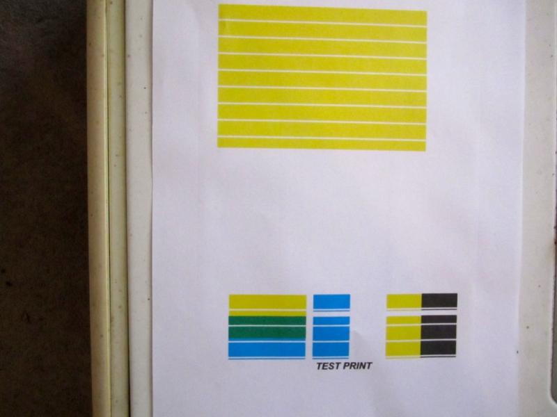

Example Print of Red Red Square
Here is a picture of what I get when I attempt to print a 3" X 5" Red square & the output from flexi's test print.

I think it's clogging in heads but try this:
-Get a new dampers for M&Lm you can switch a work dampers from your head to ensure that dampers work or not .
-the ink level inside dampers must be around half pull ink by syringe from dampers .
-probably there are clogging in the head put cleaning liquid on the cap let the head set on it few minute then few cleaning from menu test print see what happen.
-try push cleaning liquid in M&Lm head to fix the clogging if its not open you nee new heads.
If it's to expensive replace 2 heads you can replace one head and print CMYK without Lm Lc.

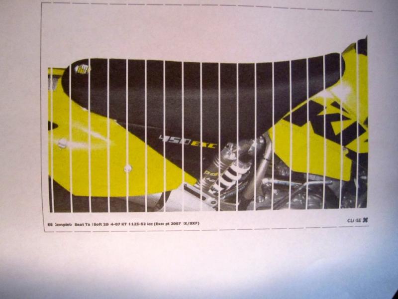

Blank Lines in the printed output..
Thanks for the unclogging suggestions... I will pick up some cleaning solution, and new dampers for the Magenta & Light Magenta. Is it ok to push the cleaning solution into the head using a syringe and tube going directly to the nipple that the damper plugs into, or should I flush the damper a push through the damper and into the head?
Also.. are the blank lines showing in all of my printouts (see below) a result of the missing M/Lm ?
thanks again everyone... I'm getting closer.
madsign25
Push cleaning solution direct to nipple by syringe it's make pressure on the nozzle to open good .The banding if the test print for other color perfect clean the encoder strip and encoder sensor by alcohol not cleaning solution it's make damage then from menu do bidirection calibration and print adjust here user manual.

Don't do your test print from a Rip, use the test print button on the printer. This will print the 6 colors and you can then see what jets are working. You will see missing bars in the test print and that will show blocked jets. I assume all the dampers are about half full of ink?
Draw ink into the heads by way of attaching a syringe and small length of tubing direct to the captop (where the white line goes to the pump). Make sure the heads are parked when you draw ink. If you hear air and no ink comes into the syringe then there is an air leak some where. Make sure power is off when moving the heads off the captops to attach the tube and reset the heads back onto the capping station.
It could be that the drain line on that side may be plugged and not recharging the head.
madsign25
I'm never note your test print I look now the other head clogging so you have banding ,note that your test print not print on the same line that mean cap problem fix cap first or replace it and sure that pump tube open perfect no clogging you can by alcohol or hot water clean cap and pump tube , do that before flushing head mybe it's just easy and work .do test print from printer not rip when work with head flushing disconnect the power cable .

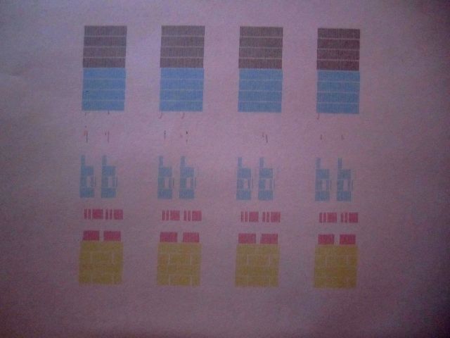

The capping station was brand new when I received this printer, the sponges were clean white and all the drain lines on it were clear. There is ink ejecting through both ink drain lines from the bottom of the capping station out into the drain bottle. Can you please detail what else you recommend in way of adjusting the capping station,
After sitting in the ink dampened sponges for several hours, and a few powerful cleans I started getting a bit out of the light magenta jets, and even a few (I know *FEW*) bits of lines from the magenta nozzles. (see print test below).

Test print:
