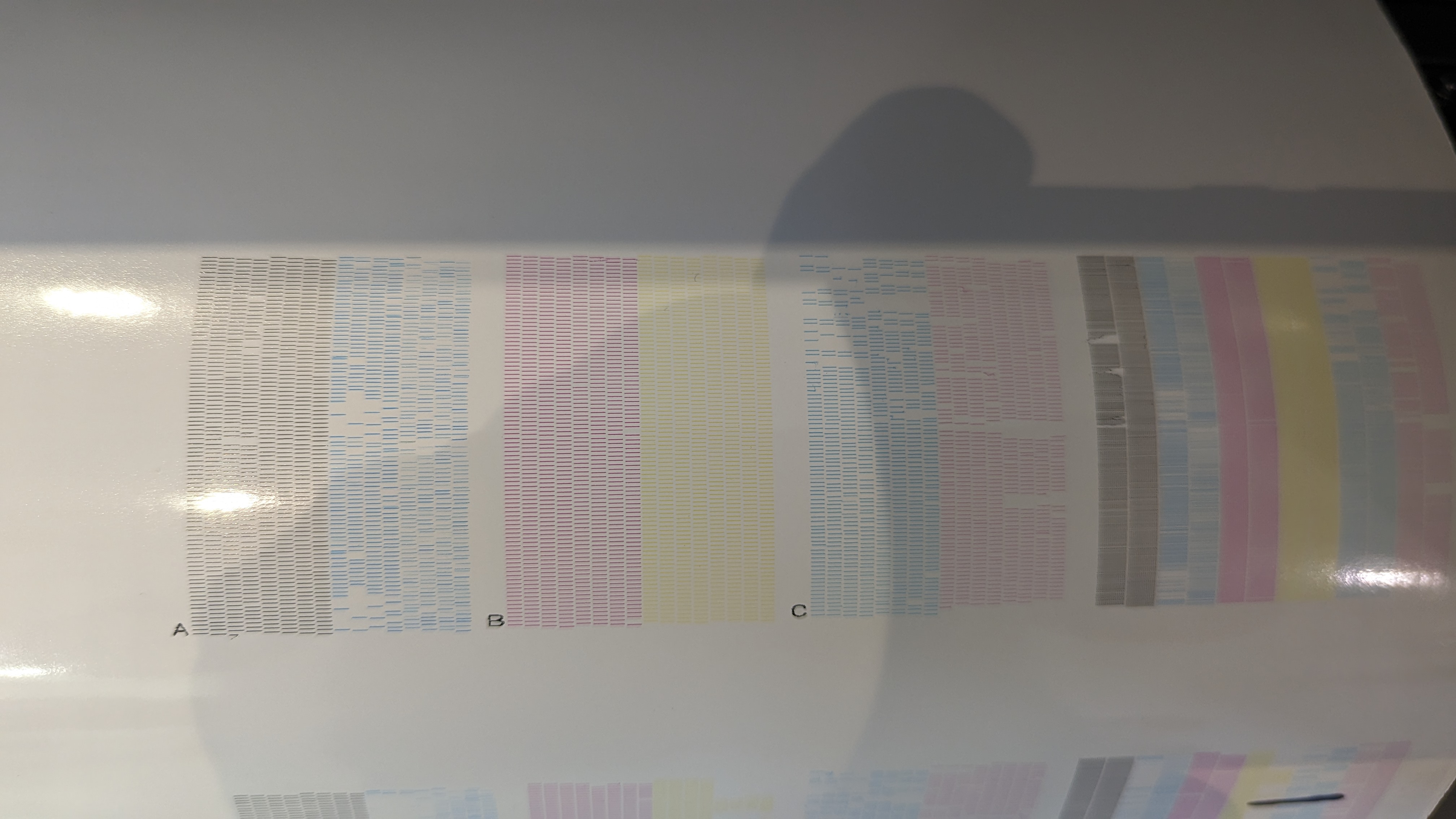

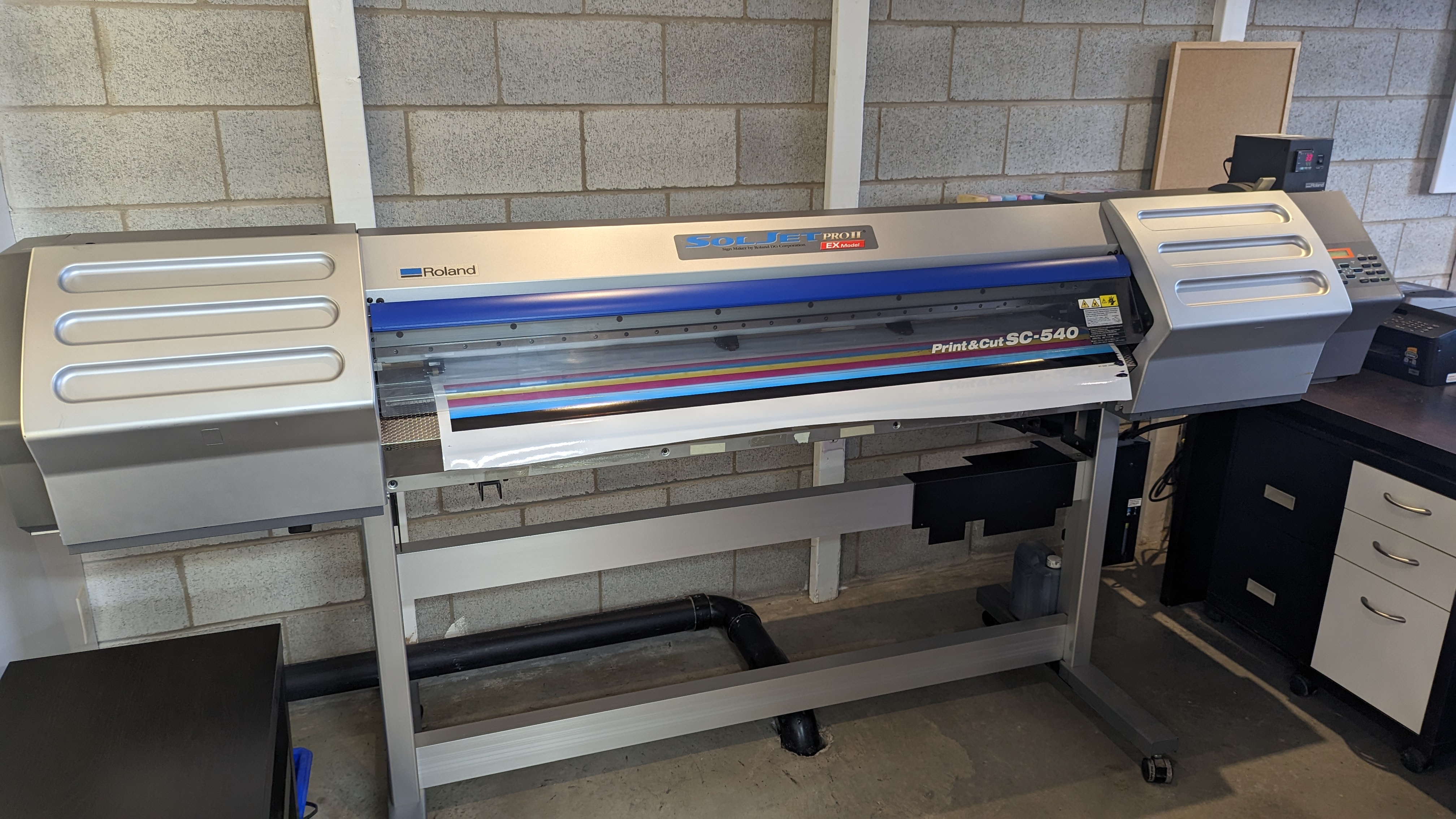

I have an old sc540ex (still working but bad printing) that I'm thinking of dismantling. There's still a few good head and would like to know if there is a special fluid to inject so they can sit for a few months. I can flush them with washing fluid but it will dry... I also have an xc540 working fine and they would be backup part for it.

the manufacturers use a "transport liquid " or storage liquid, but the head is tested with aqueous inks
there is no guarantee that at least a few piezo's will not stick, open or shut regardless of how the head is flushed.
what i do (at my own risk) is flush the printhead with the chinese knockoff of the print head doctor & then, take a 1qt pyrex with airtight rubber lid
i tie a few stainless steel nuts together to make standoffs, set the head on top of these, and fill the container with cleaning fluid or flush, so the printhead surface (the part you clean) is "under water" by about 1/8" or so, but the electronics are not. then fill the nipples on the manifold with flush as well
i top off the fluid as needed

With Rolands, not sure if it's the proper way, but couldn't you load them up with cleaning cartridges and use them to flush and pump out all the ink for longer term storage?
Solventinkjet
DIY Printer Fixing Guide
You can just flush the system with the cleaning solution as DL Signs signs mentioned. I can't remember what it's called on Roland machines but there should be some sort of discharge and flush function. It empties out the flush afterward so you just have empty lines. It can sit like that for a long time.
