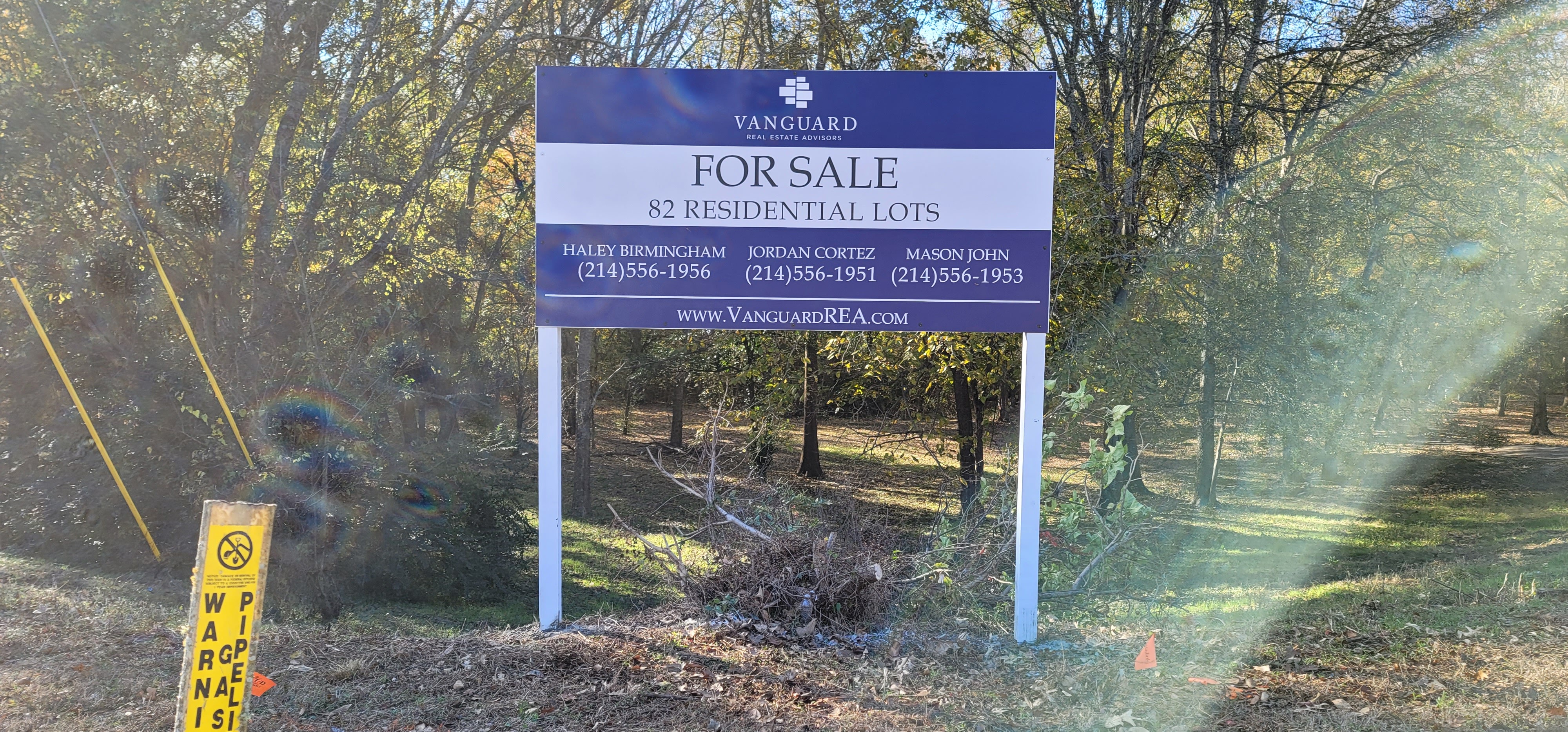

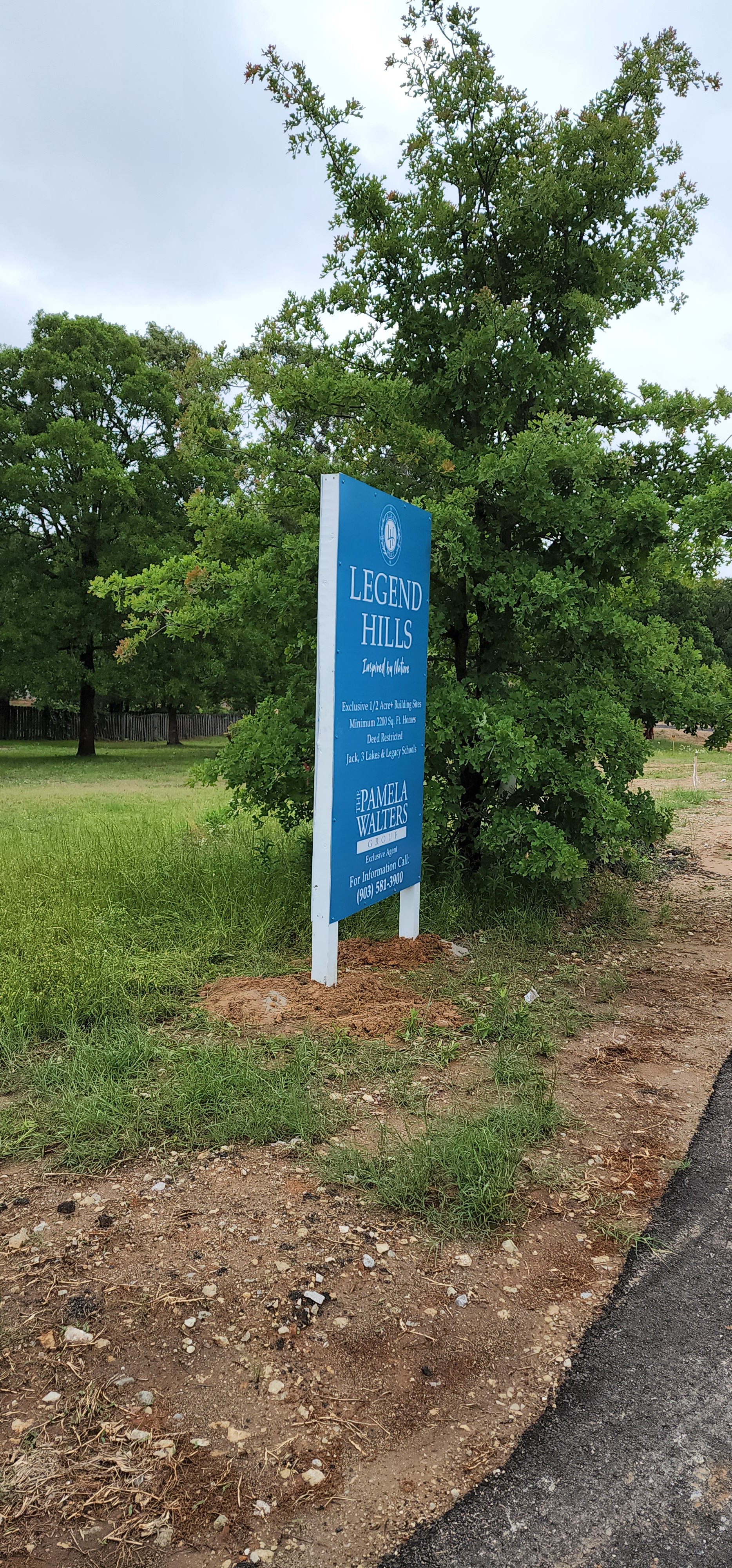

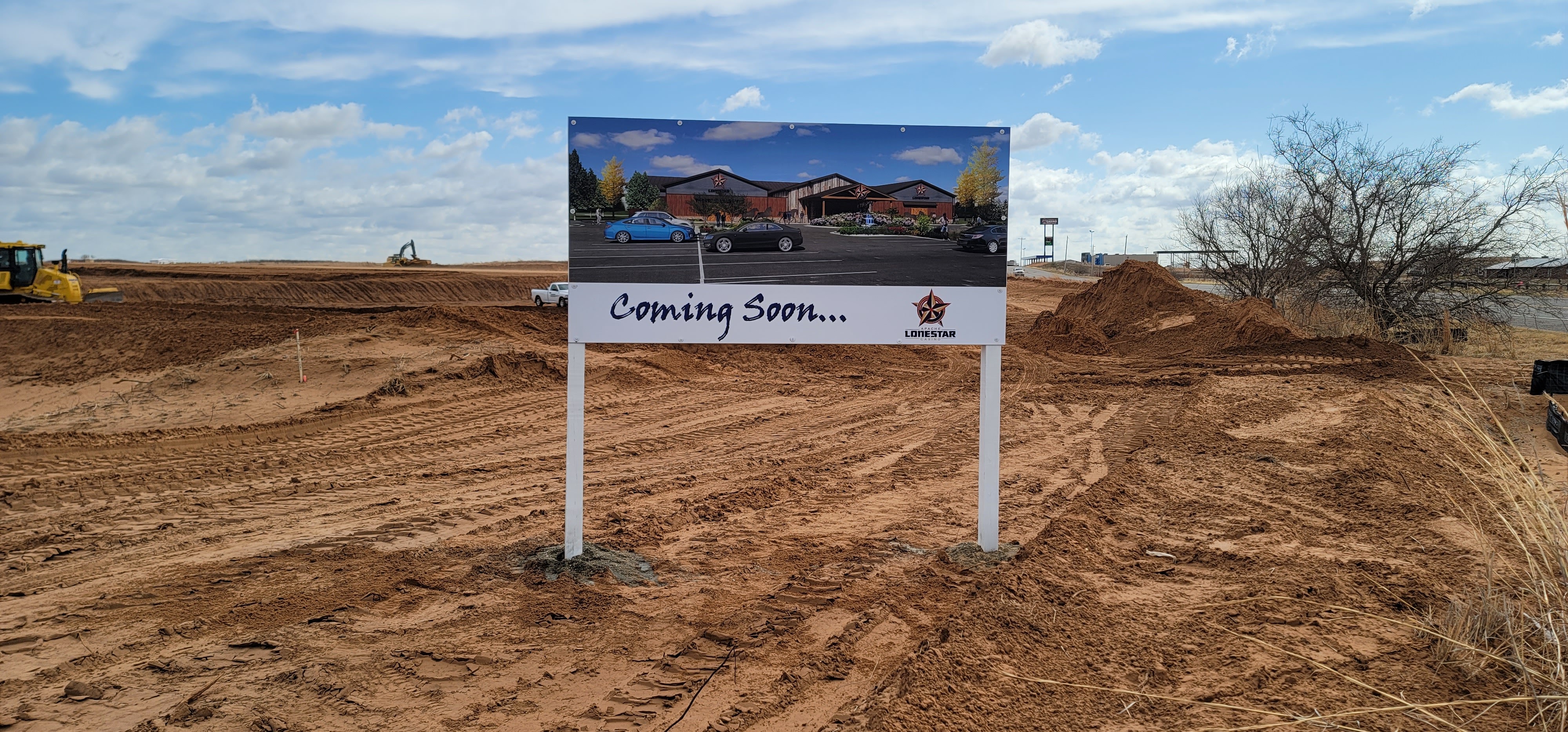

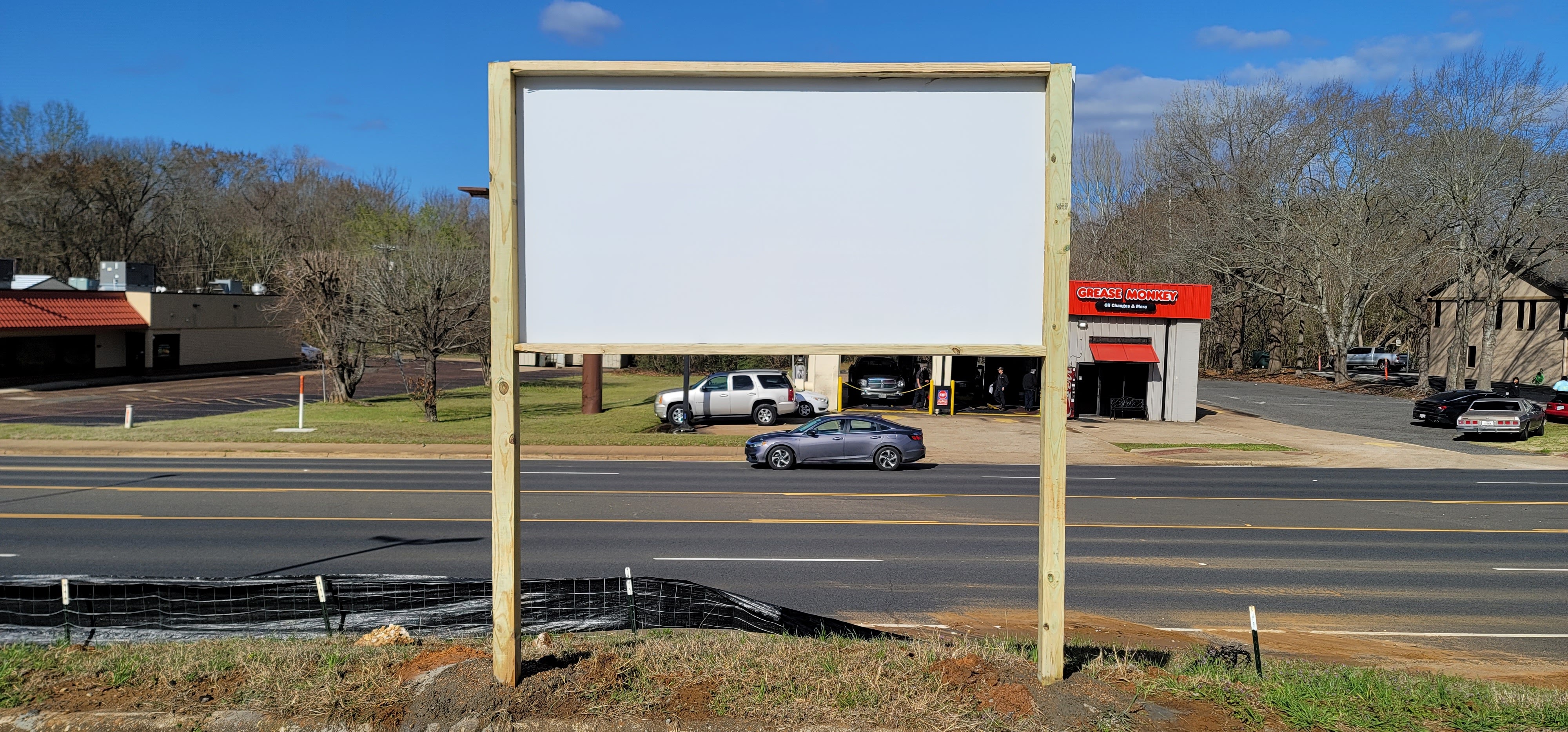

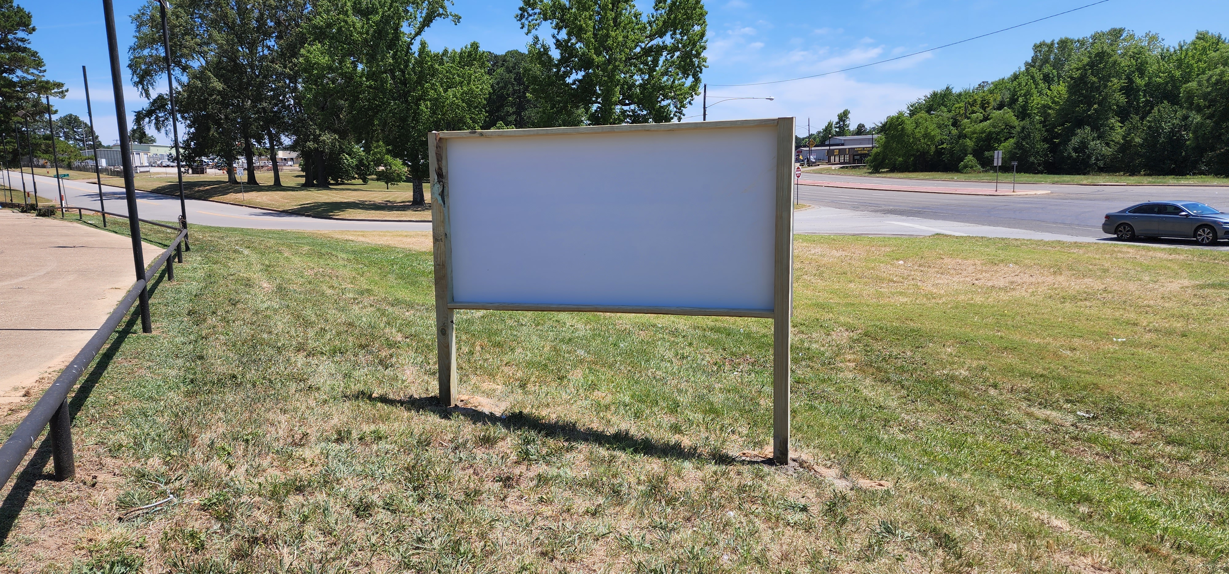

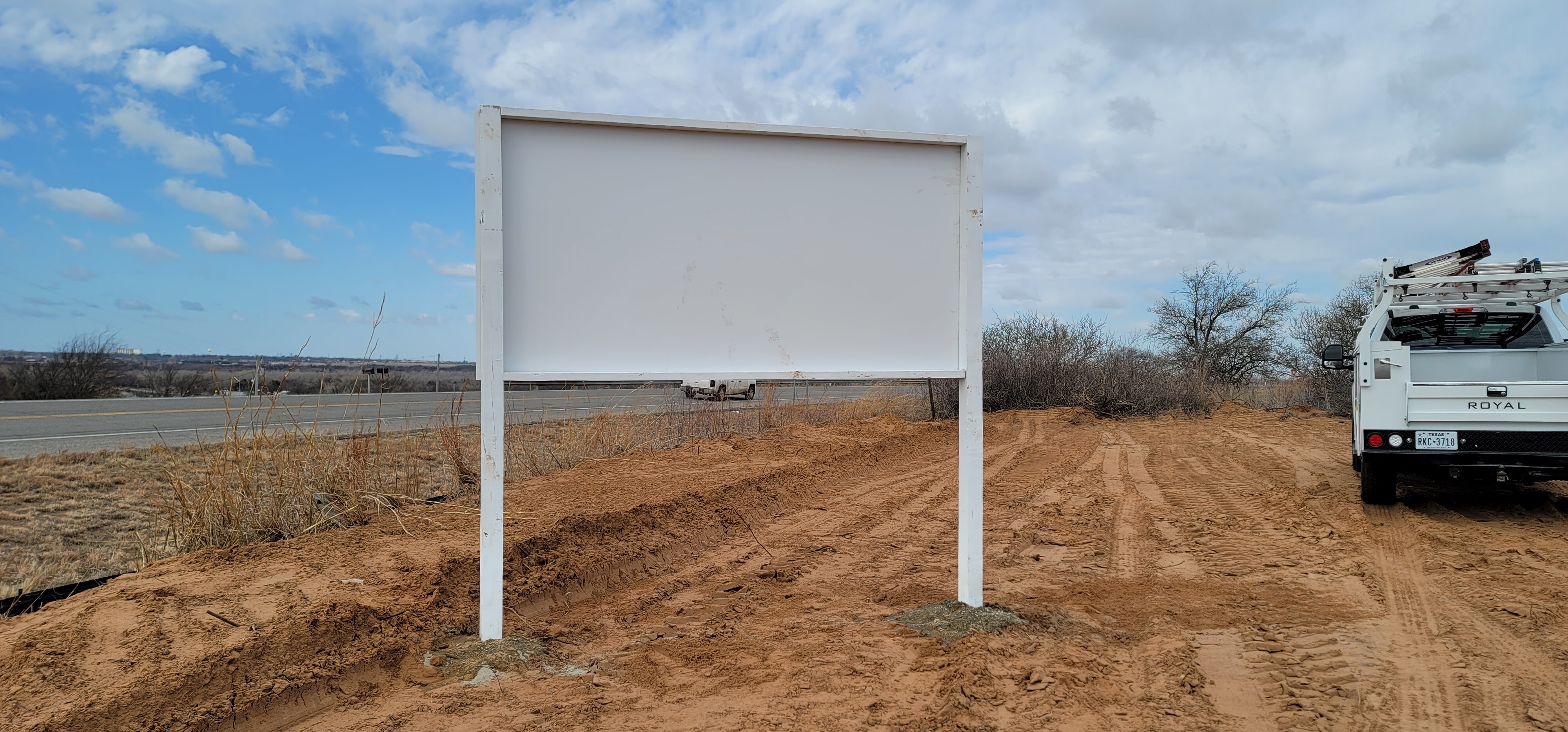

The simplest answer is to use a wood frame with 4x4s and two 2x4s. I first put two 4x4s on the ground, then put two 2x4 (cut to 88") in between them and use 6" long wood screws to fasten them together. Then put the ACM face on it and use painted fasteners and washers every 2' around the entire face. Then, with the sign in place on the ground, I drill two holes with an auger attached to drill (or post hole diggers if ground is rocky) and then lift the sign up into the holes. Slap a bag of concrete in there and level and I'm done in about 30 mins.
With 3mm ACM you need some sort of horizontal support. 6mm you might can get away with no support. Using MDO you don't need supports at all.
As for the back of the sign, you can pre-paint the wood to match and it looks better. For double sided signs, I'll flip over the frame on the ground (using a price of coro to protect the other side) and attach the other face to it.

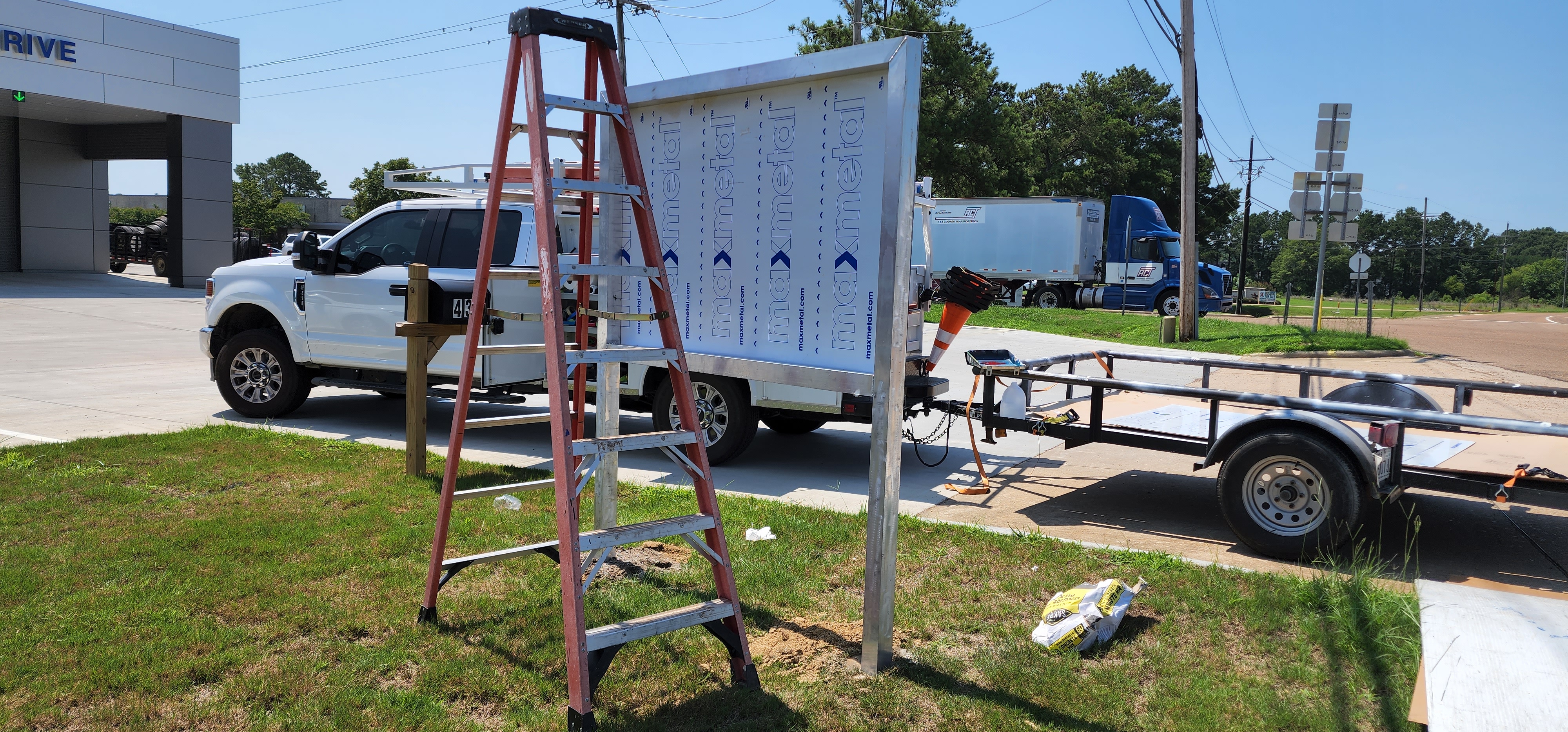

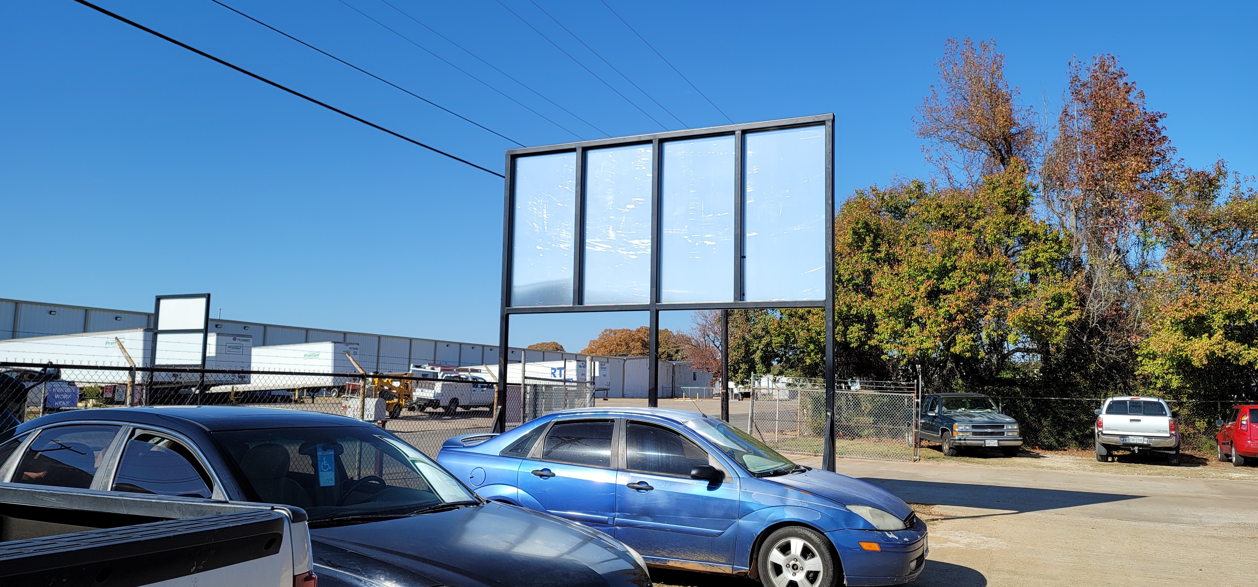

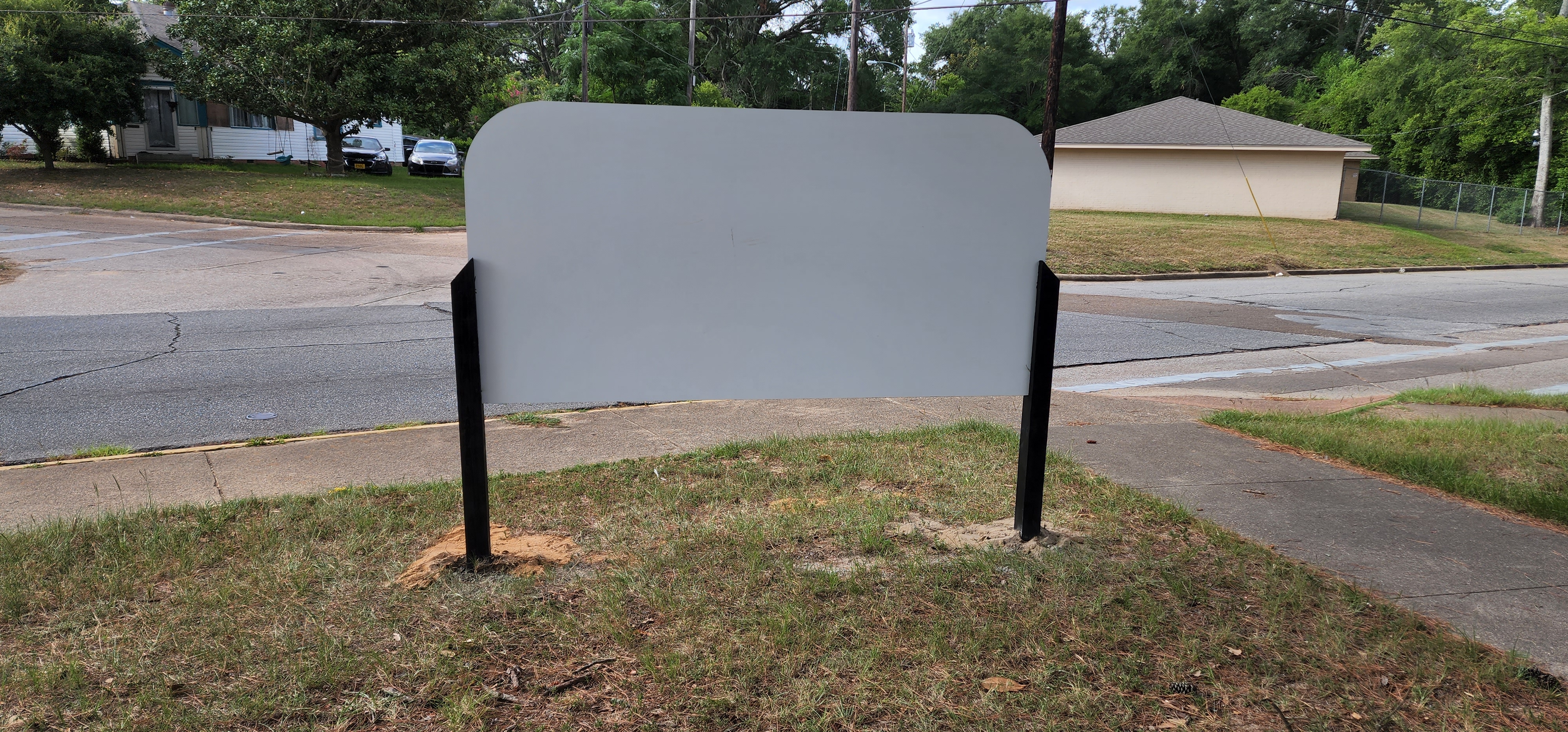

You can also use ACM on metal frame for something more permanent
ACM can also be used on large frames like this one BUT... This was only a single sided frame so we had to add blank panels to the back to prevent blowout. You can also use 080.

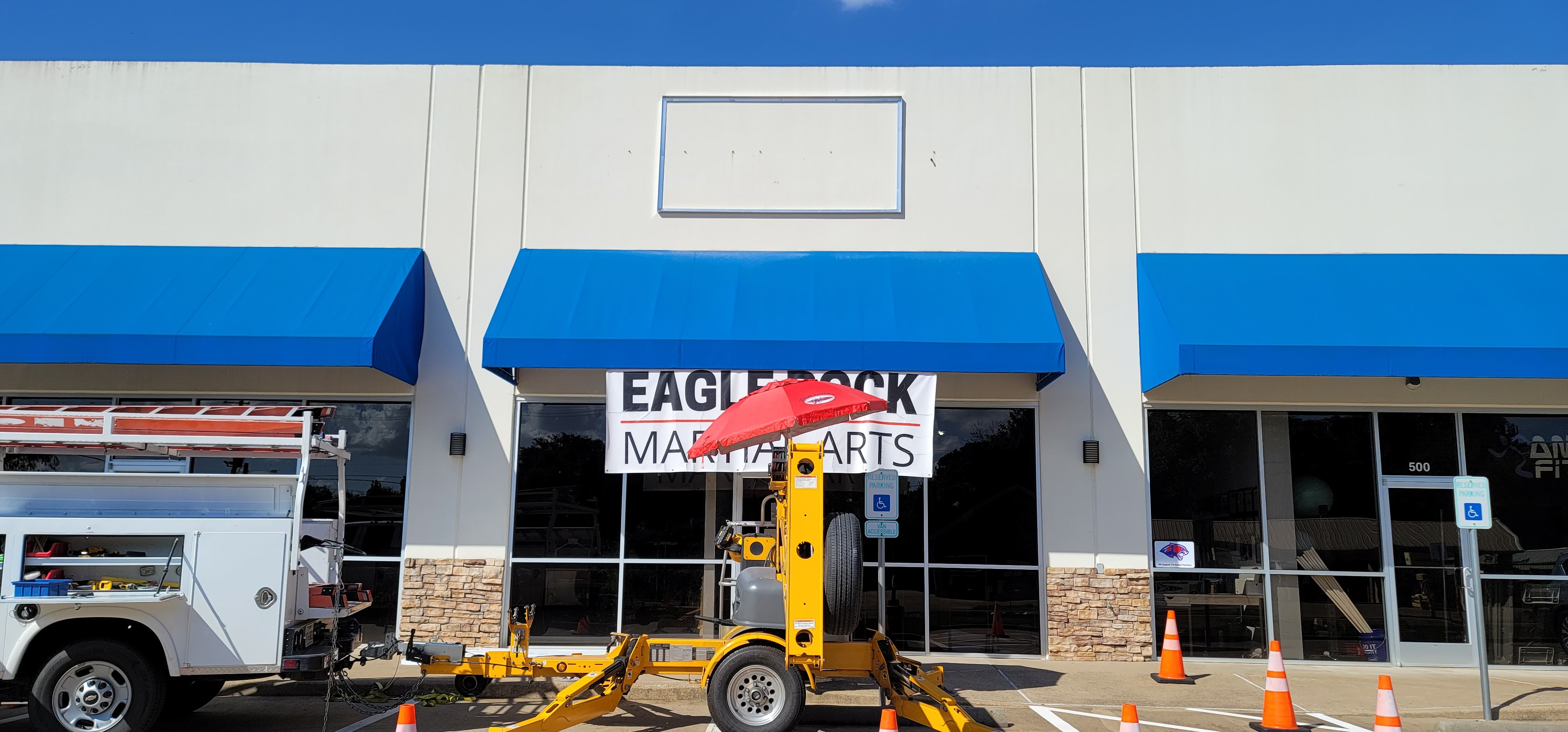

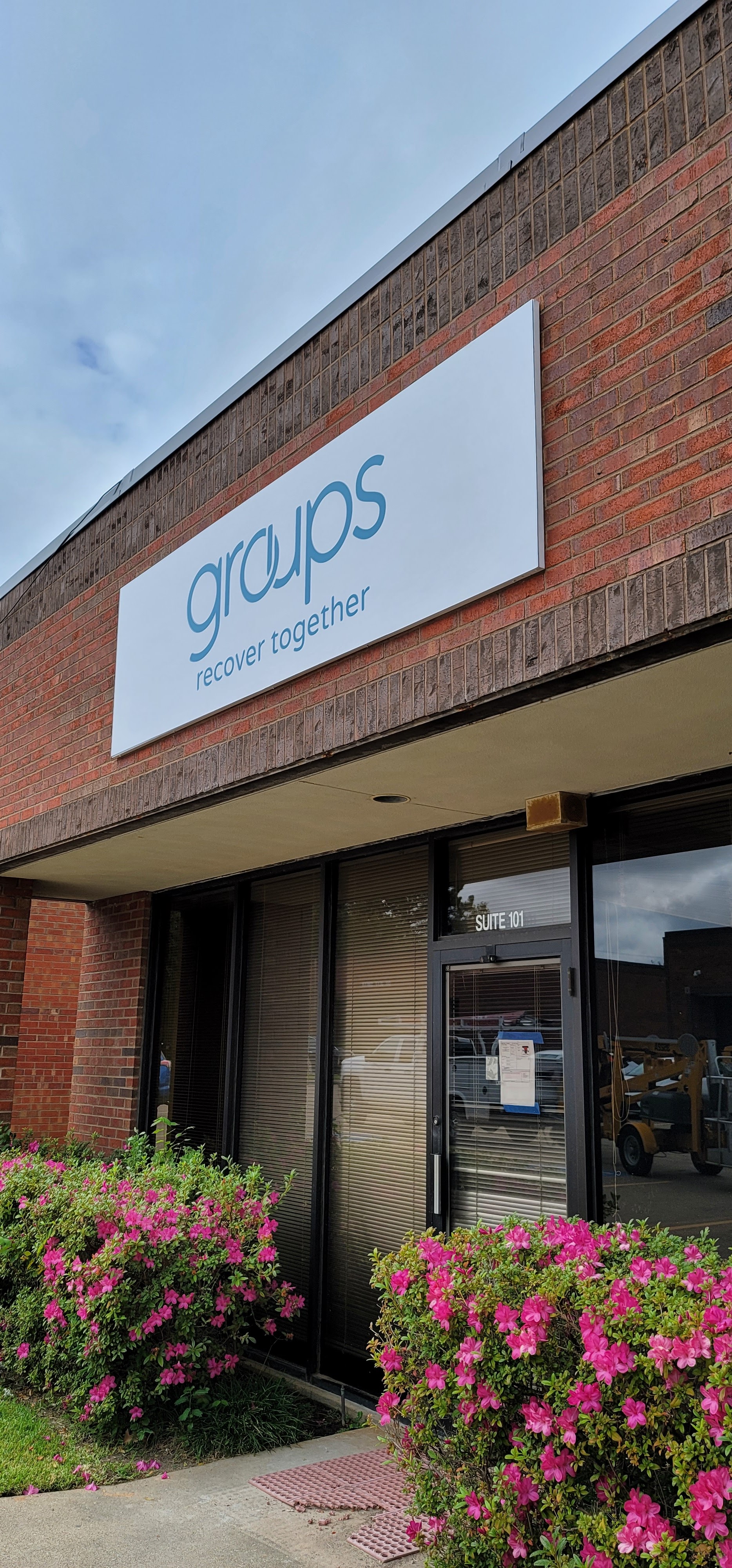

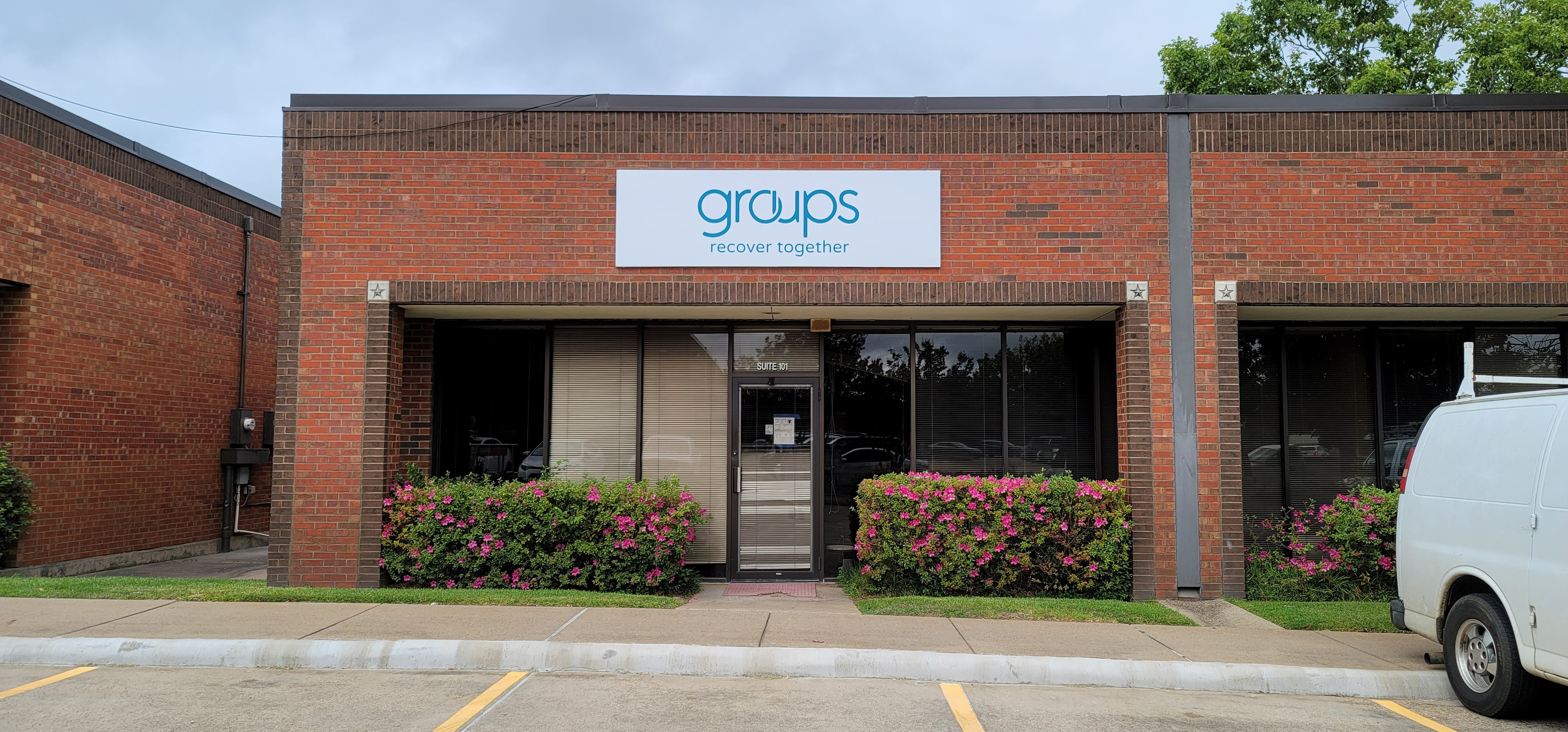

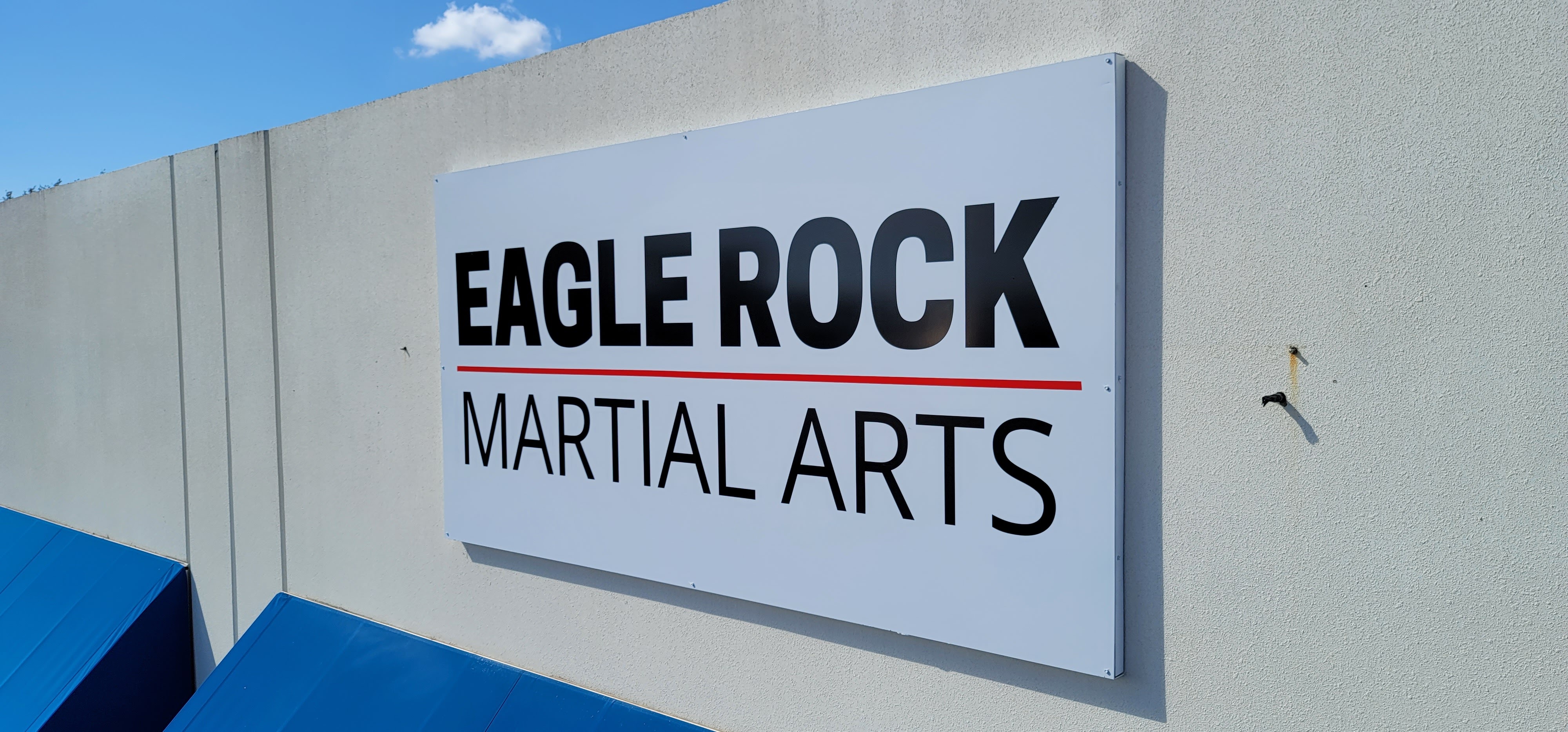

For wall signs, you can add aluminum angle, painted to match.. or get the really tick skinned stuff and bend it, but that is heavy and a PITA to install when you could go with 063 or something.

How is the ACM attached to the angle on the wall with this one? Do you glue more angle to the back of the ACP? curious which adhesive
Yes. I just use VHB now. I've come across many old signs with just VHB that you have to destroy to separate. Maybe our climate allows VHB to work.
