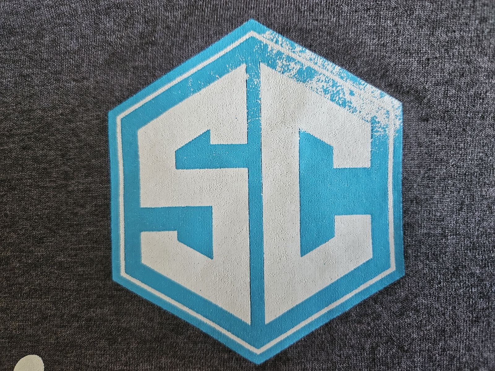

Just got some company shirts printed from a local company. Response, attentiveness, turnaround time and pricing were all really good.
Washed a couple shirts (inside out) once and already have ink coming off.

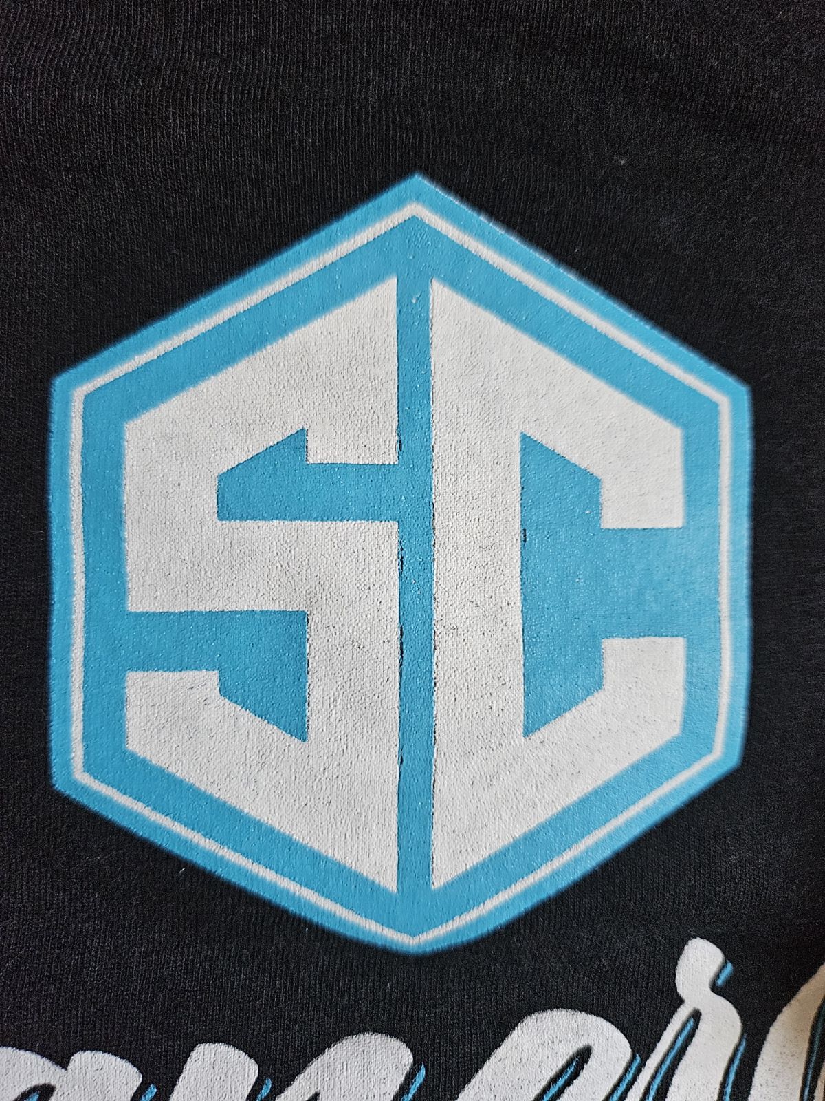

My first impression when we received the shirts was that blue ink didn't cover white base very well, but I didn't expect this after one wash. (Had lots of specs of white showing through, registration wasn't perfect etc)
We've had shirts printed before and have never seen anything like this, am I wrong in assuming that the printer didn't do a great job here?
First pic shows a ton of blue ink that came off, second pic just shows some cracks/gap in the ink after one wash as well. This logo is around 4" tall.
I'm going to give the printer the opportunity to address the issue, and I really hope they do, just wondering what other shops think of this.

I've not had an incredibly large number of shirts screen-printed, but I've had enough variety to say that I've never seen that happen before. And I generally order an extra shirt for myself to wear and wash plenty of times just to keep an eye on any quality issues. I'm not a hands-on expert in screen-printing garments, but maybe not enough time (or not enough heat) in the curing / drying phase?

The ink didn't hit the correct temperature to cure(320 degrees) or the white ink got too hot between flashing and didn't allow the blue to stick to the white. The quality of the "good" print is not good at all. The white isn't covering the black shirt. The colors aren't lined up. Sorry to see this. My employees get pissed at me because I'm a perfectionist but this is another good reminder as to why I'm such a hard ass on the quality of our screen printing. I wouldn't allow that kind of quality print to go out of my shop.

Now that we're looking at them closer, the quality of the print is pretty shitty on all of them. Going to email them now and see how they respond.
Thanks for the feedback, was hoping to hear from someone in the industry. We don't screen-print or deal with garments but I also wouldn't let something like that leave my shop.

Exactly what Black Star said. My bet is on the white being over-cured with the flash, resulting in the blue not adhering to it, but it really could go either way. If you stretch the print, does it crack at all?
Also, the white is NOT smooth (it should be), and the blue looks like a ridiculously thick deposit of ink. Basically, this reminds me of my first week of trying to screen print. Give them the chance to do better, but if they can't get your money back and go elsewhere.

The white wasn't gelled enough before the blue went down and was peeled off from the blue screen. Then went it went through the dryer, it wasn't cured at 320 degrees long enough. If they are good shop they will replace them. Might have been a new pressman, but they shouldn't have let it go out the door and yes someone saw this when they came off the dryer. Just talk to them and let them make it right.
