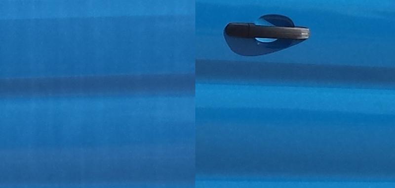

So I printed part of a van wrap on what was left of a roll of Avery 1005 and the rest I printed on a new roll of 1105.
You can clearly see the difference of what they did with the receptivity on the printing surface with the new 1105.
Same ink cartridges, same day, same temps, same printer, same profile settings, same humidity, barometric pressure blah blah...the only difference was the vinyl.
See if you can guess which one is which. :)

The one to the right must be the better stuff, cause the door handle looks very realistic, while the pic on the left...... it's hard to make out the handle at all. :covereyes:

Yeah, I tried getting the same spot on the vehicle without getting customers info or logo in the pic. It's the same spot on art but driver side had no door, pass had swing open...hence handle.

As for expecting them to be the same...a little variance is one thing with slight white points effecting the color. But the ink banding on one vs no banding on the other is completely different. That's the "receptivity" I was talking about. Big difference.

On my monitor, left hand picture is showing some minor lack of consistancy due to ink absorbtion... I see vertical zebra pattern (or maybe is just weird reflections in the background. Anyway, Avery have had some sort of issue with quality consistancy from batch to batch. Hope they finally find a cure...

That is exactly what you are seeing. I can't say if it is due to different batches or different models 1005 vs 1105 because both are true in this case.
