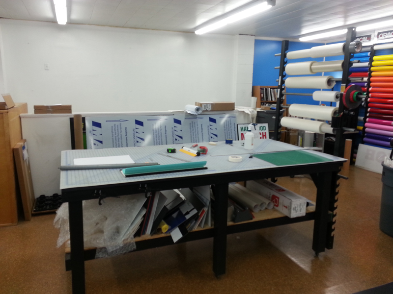

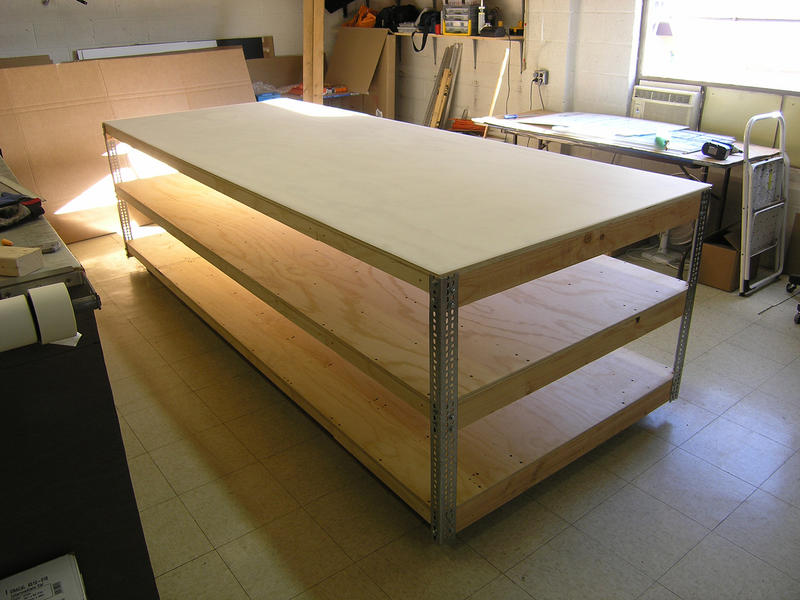

Our table for reference. It's 10' x 4' x 3'H, w/ locking casters. It's been improved since this pic was taken:
This is ours. We have another one that's identical to it. They are made with 4x4 legs and a 2x4 framework for the shelf and top. Then we put 3/4" MDO on top with a sheet of 1/8" ACM on top of that. The one pictured has a cutting mat, the other doesn't. The one pictured also has the nifty vinyl/tape rack shown. Before anyone asks, I have no clue where to get another rack like it. We got lucky and found it used with a bunch of clothing racks on Craigslist. It works great for keeping rolls of material handy. We put casters on it that are small but very strong. They just don't roll easy, which I find to be perfect as there is no need to lock the casters, ever. And when you need to move it, it rolls easy enough. Aside from that, I'm 6'1" and the table is 39.5 inches tall and I think it works perfectly for me.

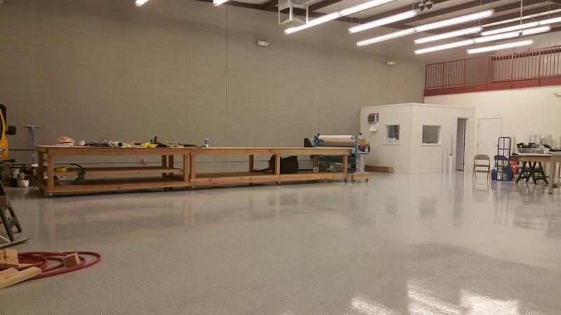

We have a 5'x25' table. The part with a top and bottom shelf separates from the other section. The section with 2 shelves is 9' long, so we can store coro and other full sheet media on those 2 shelves. We can also take that section and roll it somewhere else when we're installing a wrap or whatever. I still need to paint the thing, but we've only been in this shop for 2 weeks. We'll get there lol.

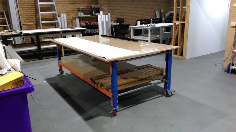

We just moved into a new shop too.
I got sick of rickety wooden benches and got a couple of these made from pallet racking.
Heavy and a bit hard to get rolling but these will last forever.

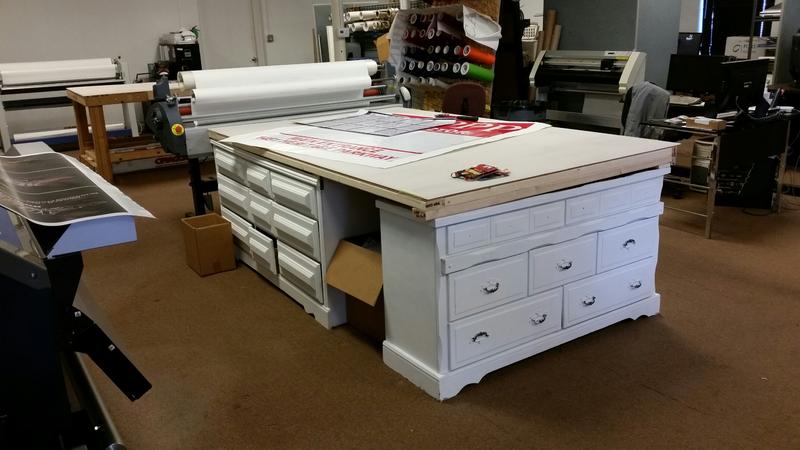

Ours is pretty ugly but functional. 2 old dressers we found on the side of the road and painted white.. The floor isn't very level so we had to level the top with wood.. 5'x10'
