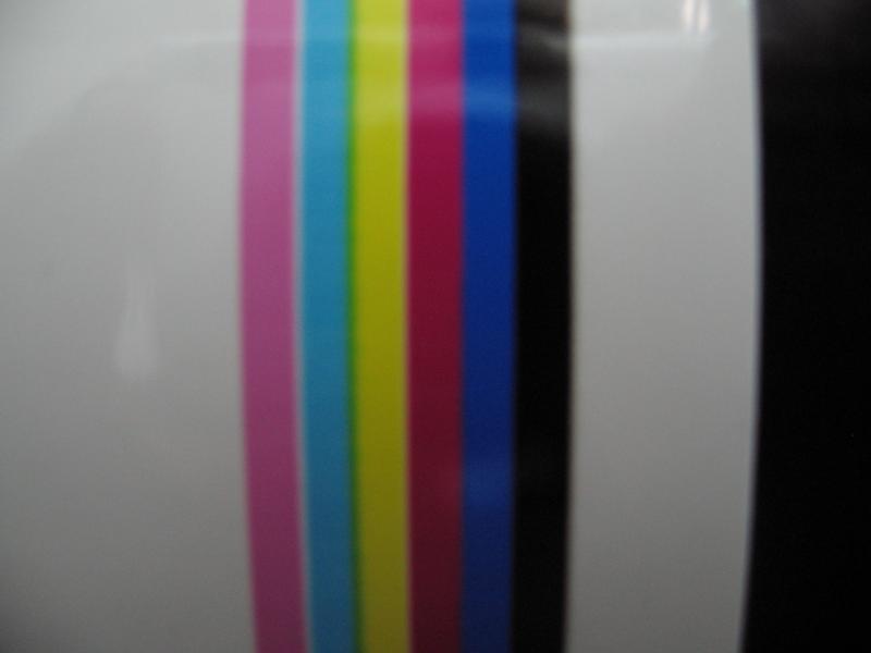

Ive got a seiko 64s, had a few issues with it as a bought it second (my first solvent printer).
I had the M head replaced a few months ago but am having problems with the LC head, When i print black text i can see a Cyan mist around it and also when looking at the colour bar the LC bleeds into the yellow and leaves a white gap the other side of the LC. Do you rekon its a mechanical alignment fault or do you think it may be another damaged head?

mechanical head adjustment...there's an expensive tool for it, or you can just tweak it trial and error style...unscrew and move Lc head a smidge to the left
Bill Modzel
Actually, you can probably fix that in the head alignment menu. The trouble is, the manual is almost useless. The information is there but choosing which test pattern to print and adjust too is not fully explained.
I would do some searching before I loosened any screws.
