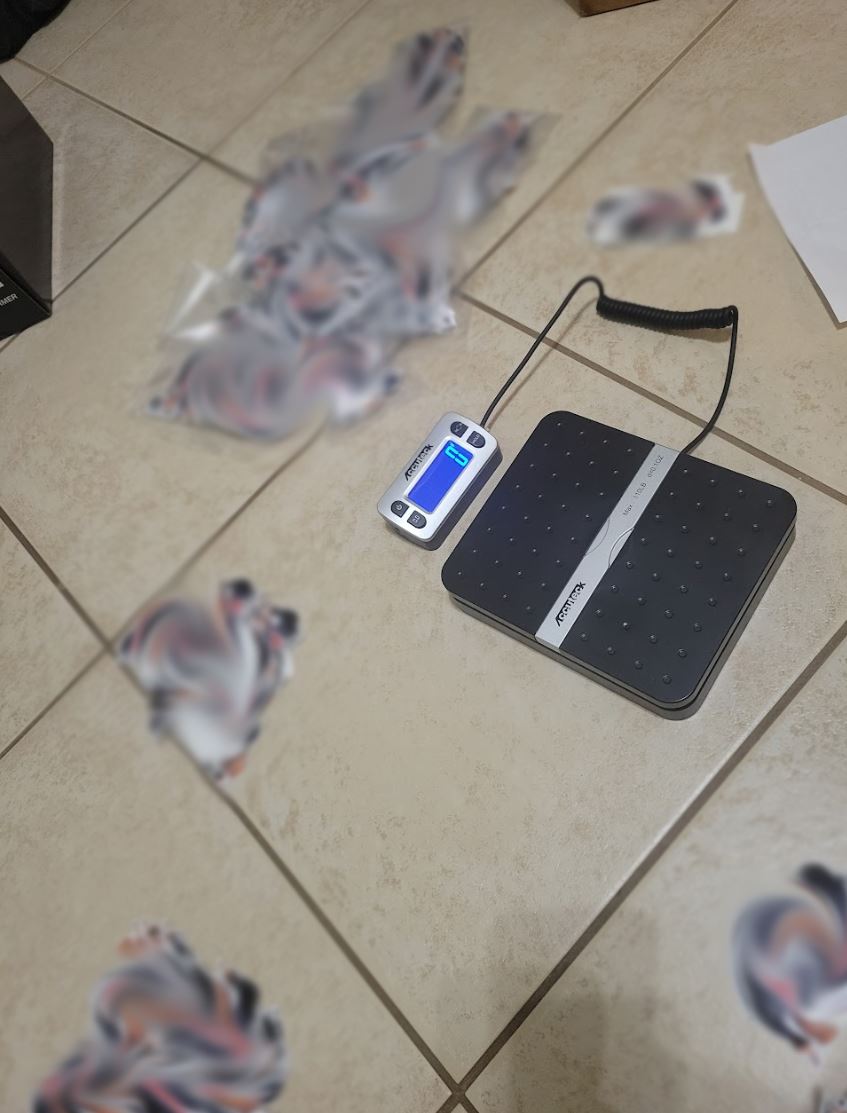

Scale is working great, just finished some Sunday night testing at home

Scale is working great, 76 grams = 102 stickers consistently. Very fast to weigh them out

2 people were able to bag up the stickers today using a scale in about 4hrs, 1000 baggies x 100 stickers per back . Was easier/faster than I was expecting
