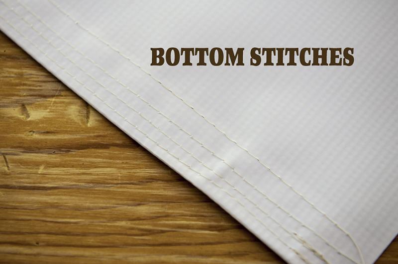

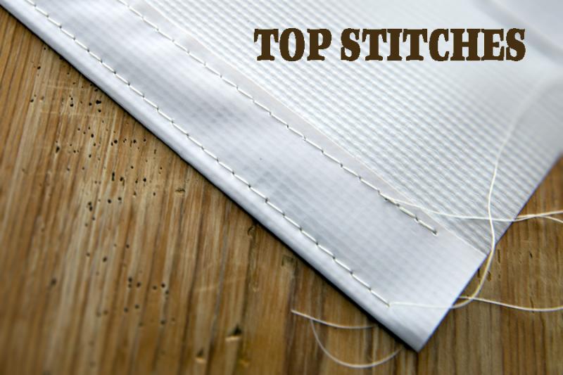

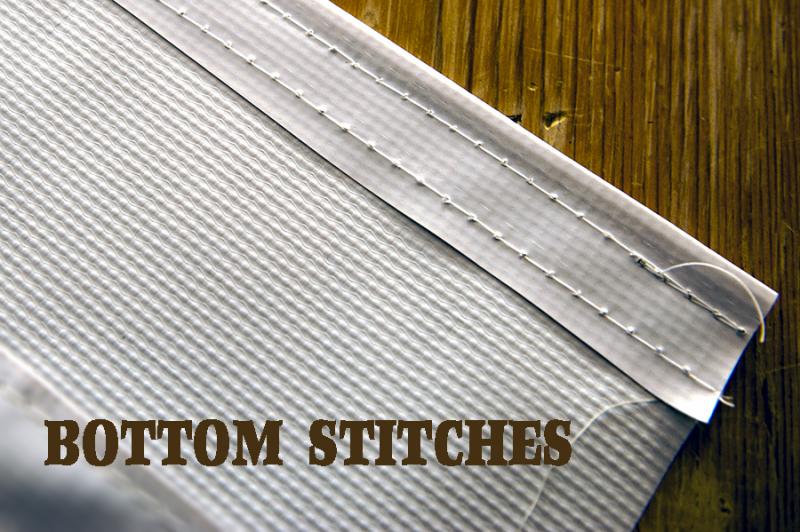

The machine came with two large spools of V69 Dacron Boned Poly thread (white), and a Schmetz 150 needle installed. I sewed a test hem of 15oz banner and the top stitches look good, but I don't think the bottom stitches look right, (see attached photos).
I will order some black thread because I think that will look better on fully printed banners.
Question, when using black thread on the top of the banner do you also need to load black in the bobbin (for the back stiches)?
What do you think about the back stitches?
Do I need to adjust the tension on the bobbin?
HELP.............

Yes, your tension is not right. When it's right, the stitch meets in the middle of the material. On your top, it looks like it's going all the way through and the bottom is just a straight line. That's a tension issue.

Agreed. We always use the same color in both the bottom and top. It does look like your upper tension is too low. Might have to play with the upper and lower tensions a bit to get a good balance. The lower tension is adjusted with a tiny screw on the bobbin case on ours. We also do about a half inch reverse right at the start and end of a stitch to help lock the ends up good. In other words, start as normal, about a half inch in hit the reverse lever and run back to the start and let go of the reverse and go forward, at the very end, hit reverse again for about a half an inch then go forward on off the end and cut.

Are you sure the TOP tension is LOW, I was thinking the BOTTOM (bobbin) tension was to tight?
When I pull the two threads (one at a time) by hand the TOP thread is very tight and the bobbin thread feels much looser, again I don't know NOTHING about this, I will try adjusting things, I just don't want to go in the wrong direction and get WAY off TRACK...

Ok, you were right, I turned the upper tension dial 6 full turns (more) and now the stitches look about the same on the top and bottom, when I went to 7 turns, the top started to look bad.

The tension thing is the opposite of what you would think. Problems on the bottom stitch mean there is an issue with the top thread, problems with the top thread tend to mean there's an issue with the bottom thread.
It's exactly backwards of what you'd think it would be.

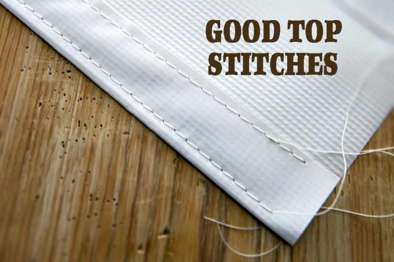

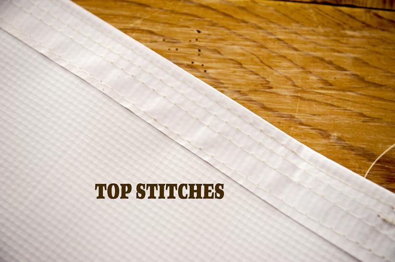

Well, I thought sewing a hem on a banner would be easy if I got the right sewing machine, (which I did), now however this tension adjusting is biting me in the but.
The guy I purchased the machine from sewed leather and tents, so the machine will handle banners without any problems, however the machine came with a #150 needle and was making nice looking stiches, I was told that needle was to BIG for vinyl, and changed it to a 110/18 and using V69 Dacron Bonded Poly thread, well then my tension was off on the bottom, the stitches looked like a straight line without any breaks, thought it was too tight so I loosened the upper tension (I was told the upper adjustment controls the bottom stitch), well then the top stitches got messed up.
Then I started to adjust the bobbin tension to fix the top stitches, this went on and on for hours, adjusting and testing, now I have both the top and bottom the SAME, but the stitches look bad to me, not like the nice stitches I have seen on other banners, see the attached photos (one photo shows the good stitches before I started to adjust tension to fix the bottom stitches).
Now the stitches are the same, however they don't look right, I'm lost, can anyone help me get back on track?
Where do you start when you get this far off track???????

I can't help you solve that, but we bought a sewing machine and I've never sew in my life. Watched the woman who sold it to us demonstrate piles of sewing, came back to the shop, couldn't get it to sew anything. Fought that thing for 2 weeks. Bought about $50 worth of various threads at local stores. Nothing. Finally ordered the recommended thread that was in the manual. It came, put it on, and we started to get some sewing happening. Tweaked the tensions and it all fell into place.
I come to the conclusion that sewing is complicated :)

I will give you one word of advice. DO NOT ADJUST THE BOBBIN TENSION.
If stitches are not coming out nicely, here is a list of things to check / adjust.
  1. Are you using new needle? Needles need to be replaced fairly often, and they are cheap enough to swap on a regularly basis.
  2. Is the needle installed properly? Check the manual for what direction the flat side is supposed to be.
  3. Rethread the entire machine, including bobbin. Consult the manual for the threading diagram.
  4. Try using a different thread in both the top and bobbin. Sewing machines can be picky with they type of thread they like.
  5. Adjust the top tension slowly until you get the perfect stitch. DO NOT TOUCH THE BOBBIN TENSION. Its set by the factory, and i've never known of a single instance where it needed to be adjusted.
  6. Make a note of the needle size, thread type, and settings once you get it dialed in.
You may have to go through this a few times before you get everything right, just don't give up!
fresh
go back to the beginning.
I think you needed to increase your top tension slightly, and that would have solved the problem. You like how the last image looks because it has a bigger hole due to the thicker needle. The needle you are using may be too small for the thread. I don't hem banners, so I'm not sure of the sizes, but I'm positive the thread you are using will have a recommended needle size.
Hopefully you'll be able to adjust the bobbin back to its original setting and start fresh with better results.
