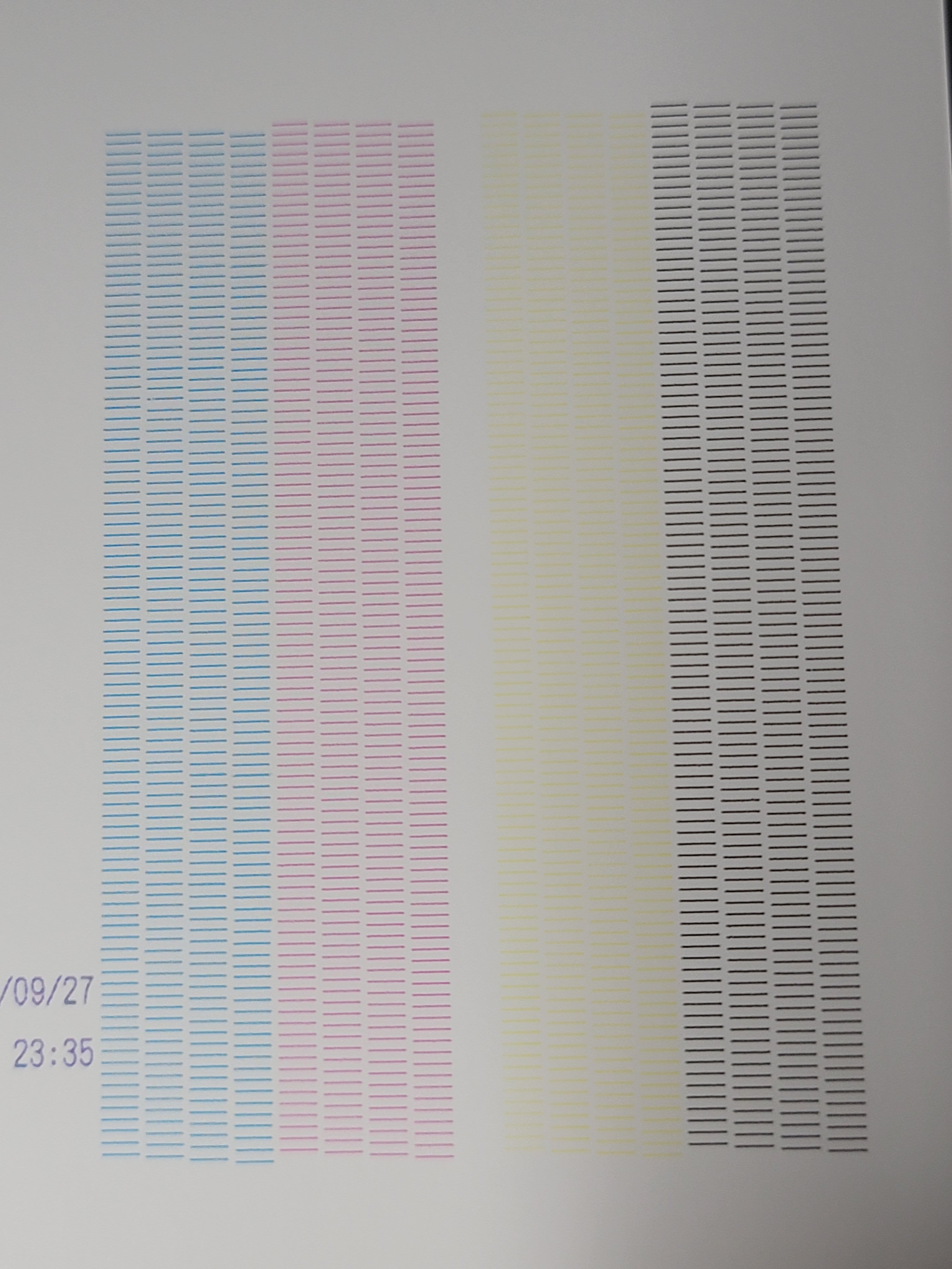

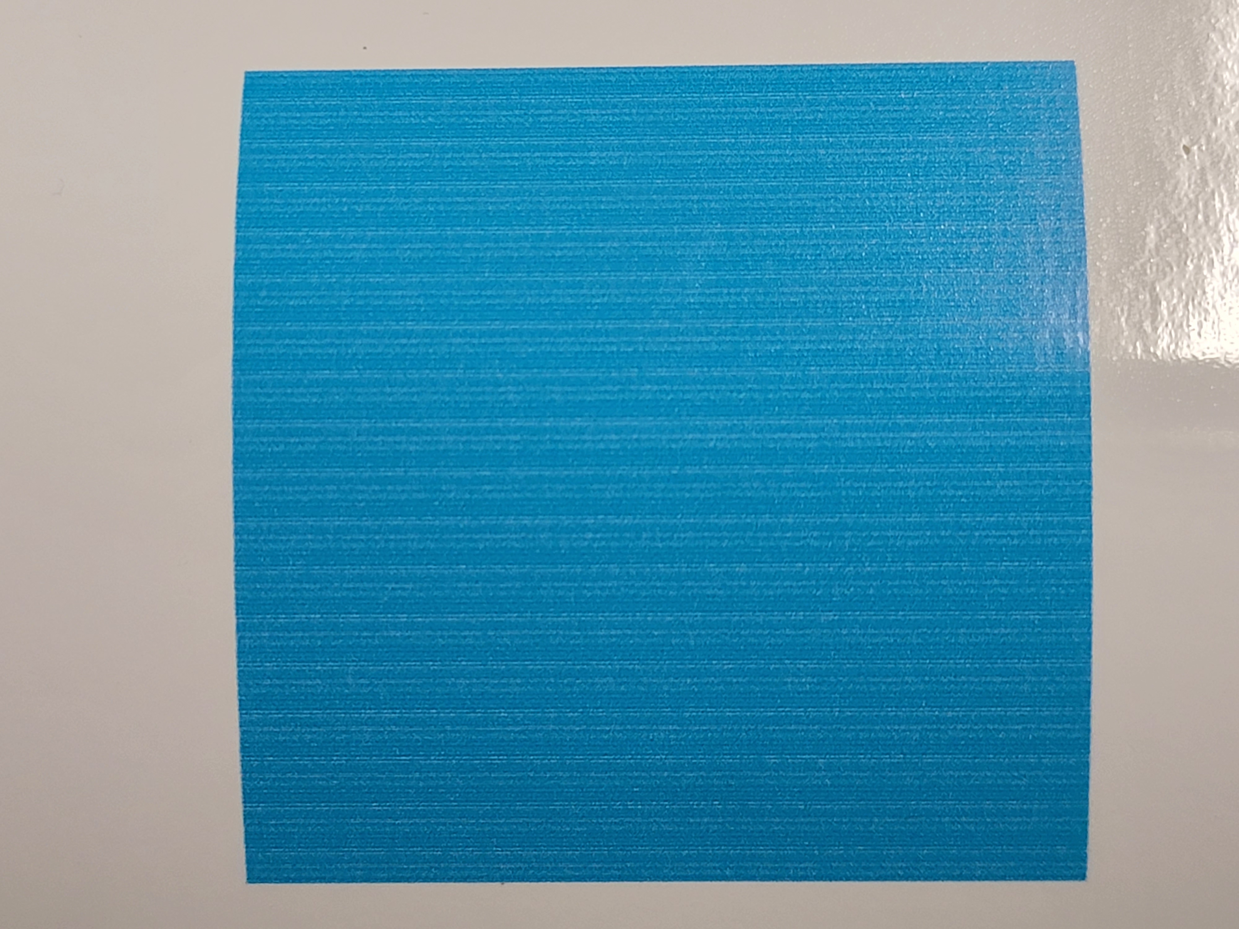

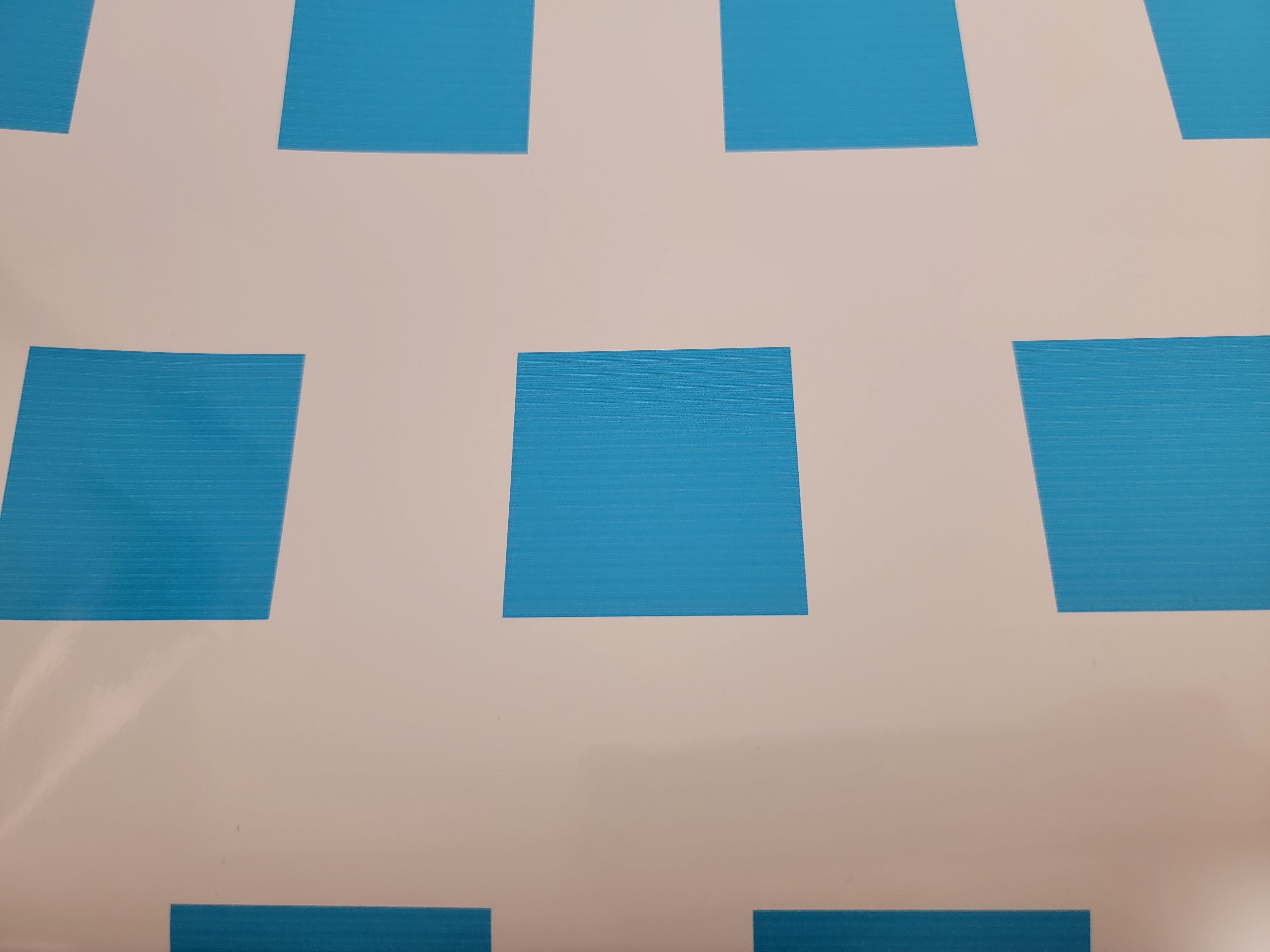

Hello,
My Roland SG-300 TR2 Cyan started printing horizontal thin white banding, it's been happening on and off since the TR2 upgrade and resolved by simply reloading the preset I saved. However I've spent 3 days trying what would typically fix it, plus adjusting different settings including profile, heat, calibration, and material gap adjustment, yet it hasn't gone away. My problem looks exactly like this https://www.signs101.com/threads/vg540-horizontal-lines.165381/ but Cyan instead.
The wiper and felt pads have been replaced and ink pouches are shaken every time the machine asks me to, both cap tops were replaced around the beginning of the year. I also do weekly manual cleanings and the printheads are spotless.

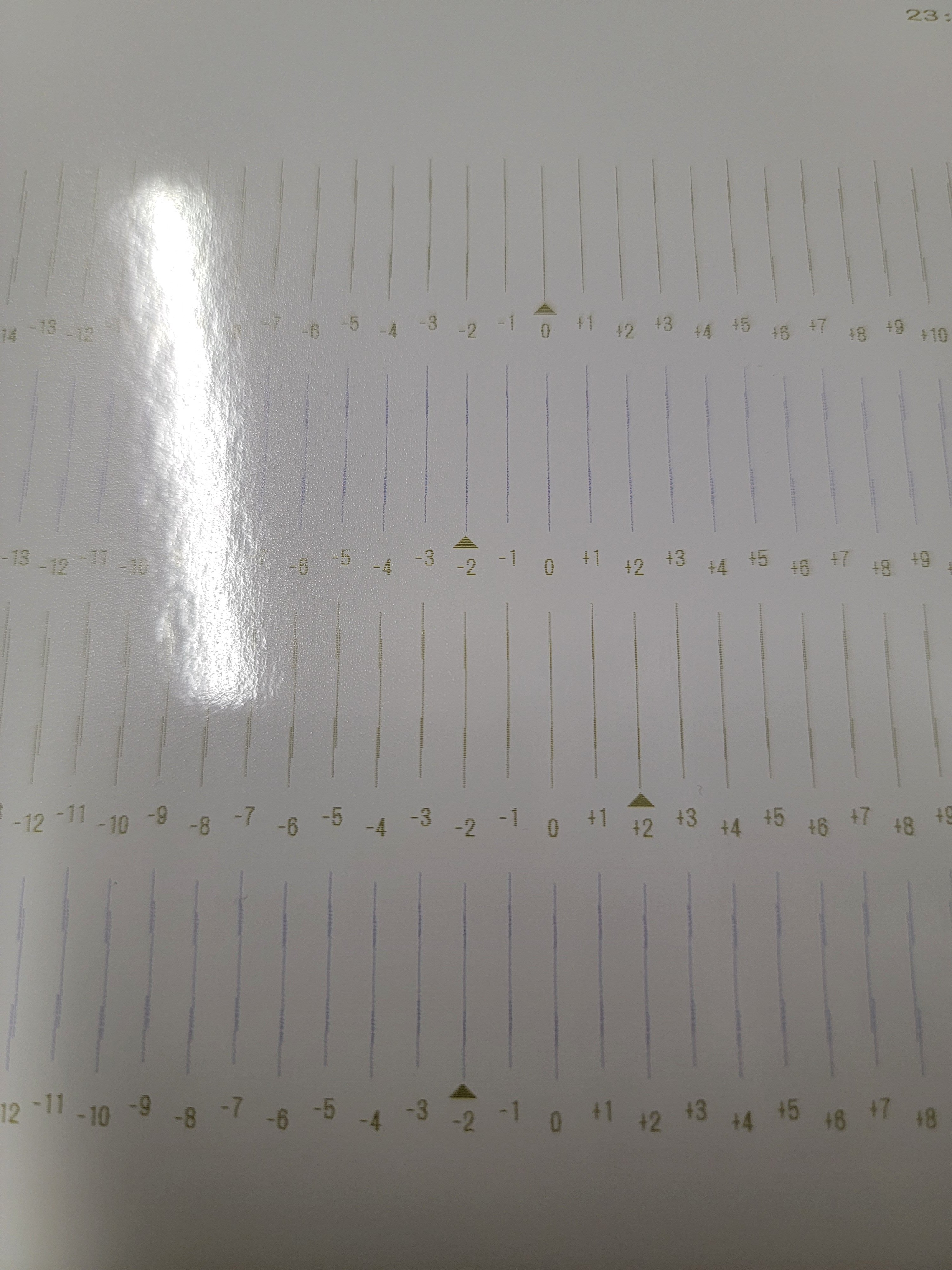

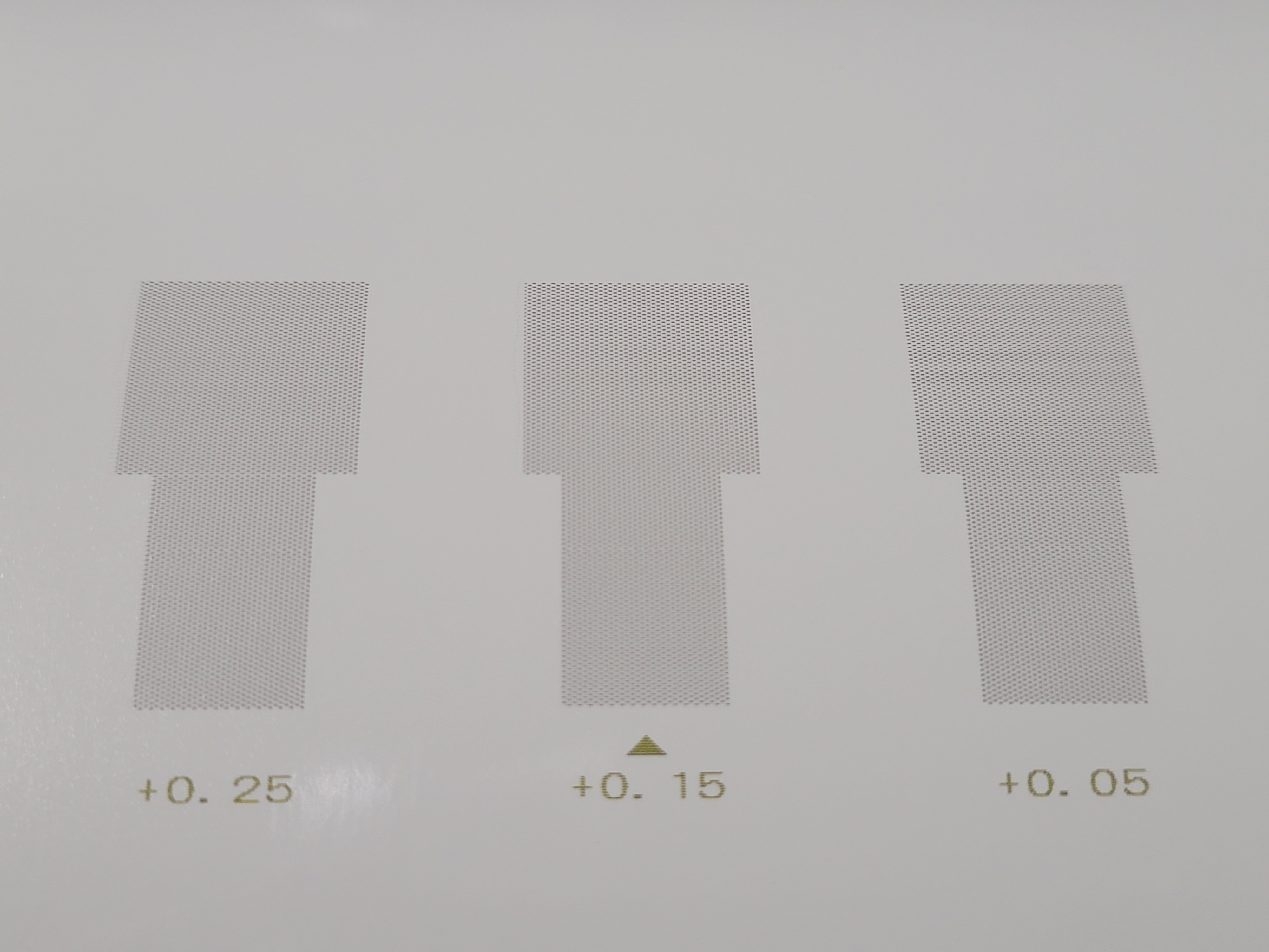

I've attached images of the calibration settings, material gap adjustment, and nozzle checks, everything seems to be in order in those regards. I'd appreciate any advice, these lines are very noticeable in my prints and I just can't send work out like that.

But it wouldn't be the head, as the test print looks great. My other guess would be the head alignment might be out a bit and might need a tech to take a peak, now that you are locked out of the service menu. I've also asked my Friend who is a Roland tech if he could take a look at the photos you showed and give me his input if he isn't too busy.

Your head seems fine for alignment so you don't need to align the printhead.
It might not help anything but I would run the cleaning cycles and the damper fill a few more times. Just to see if something is stuck somewhere.

Just heard back from my friend, this is what he had to say: "I do see a bit of waviness in the cyan. You can have a near perfect nozzle test print and still have head issues. I would suggest doing a test print in service mode and looking at the additional second lines. Also the fill pattern in service menu. I would check out the edges to see if there is any overspray"

As for the waviness, considering it's so insignificant that we both missed it, would that cause such significant lines? Does it also mean it's time to replace the print head? I can't access service mode, so I can't do much more.

I can't really say about if that would cause that much trouble, but he's never steered me wrong before. As for the fill up, I think he means to actually do the damper fill from the menu, not a cleaning, but typically, if it's at least half full, you should be okay. I don't have any experience on Mimaki, aside from hearing horror stories about them as well, from my tech friend, where he works, they sell both and he services both. He's always told me, as he knows me, that I wouldn't care for a Mimaki, as they can be very finicky and have their own extra steps to do certain things, just like Roland, but in a different way. What I would suggest, is that you go to a showroom that has operational printers, and try them out, do a few jobs (they'll usually let you, if they know you plan on buying something), that way you can see if it works for you. I can really understand about the frustration, as when the printers aren't working, it does cause a lot of stress. I personally will still stay with Roland, as the SG2's and VG2's have most of the stuff we hate about the SG's fixed. But as for a used Roland, I would still advise you to look into it, at least the service menu is still available and if you go for a VS-i model, you'll get better results and they are easier to fix, apart from the head, which can be a little tricky if you don't do it properly.
