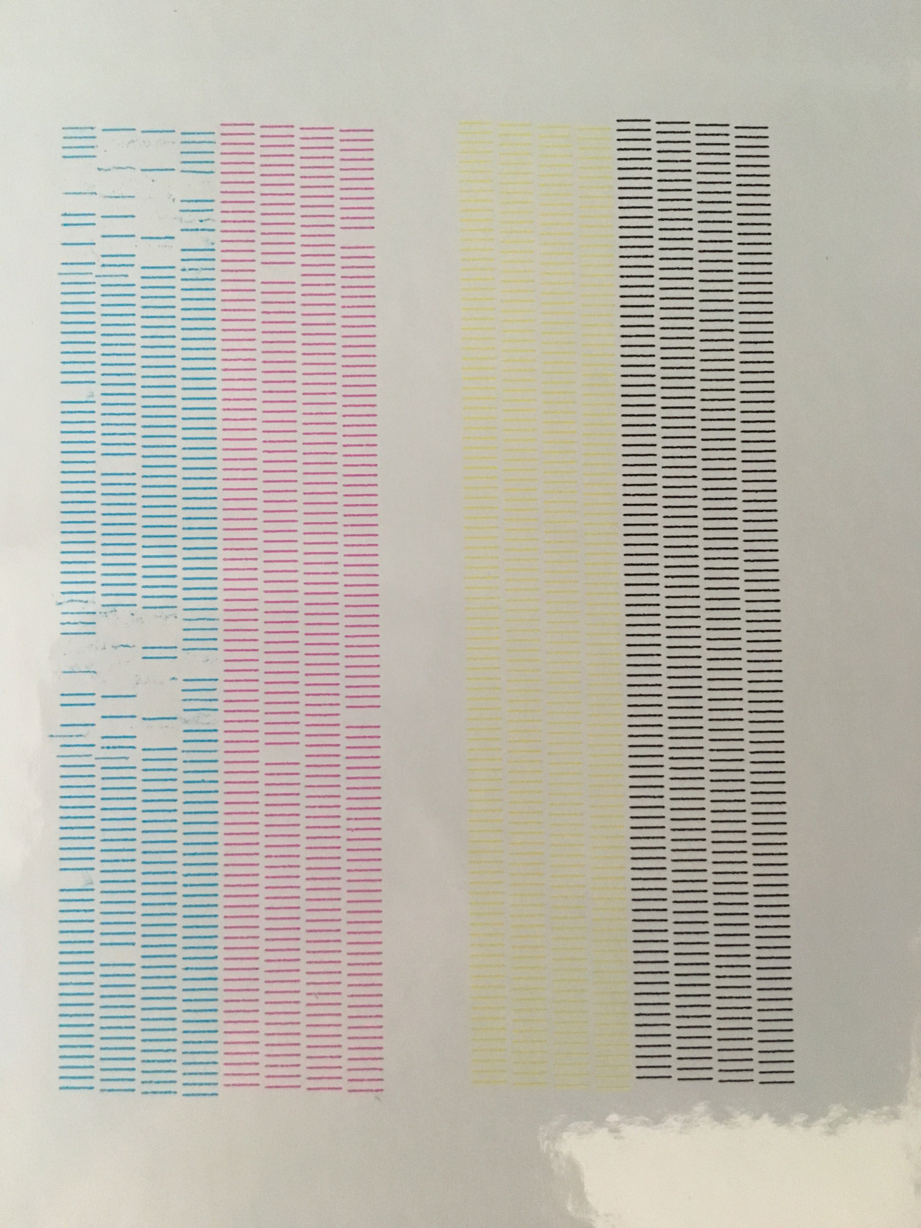

I have A Roland sg-300
But the nozzle print from blue is not Oke?!
Manual cleaning, all kind of cleaning incl the powerfull..
Changed the wimpers...
I don’t know what to do anymore.
Any suggestions?

Try an overnight head soaking (not sure how this is done on Roland 'officially', but you can always detach the cover under the capping station and close the drain tube with a clipper, fill up the capping station with cleaning liquid, unplug the machine from the mains and push the head back to its place to 'sit' in the liquid). If you had a head strike you may need new printheads.

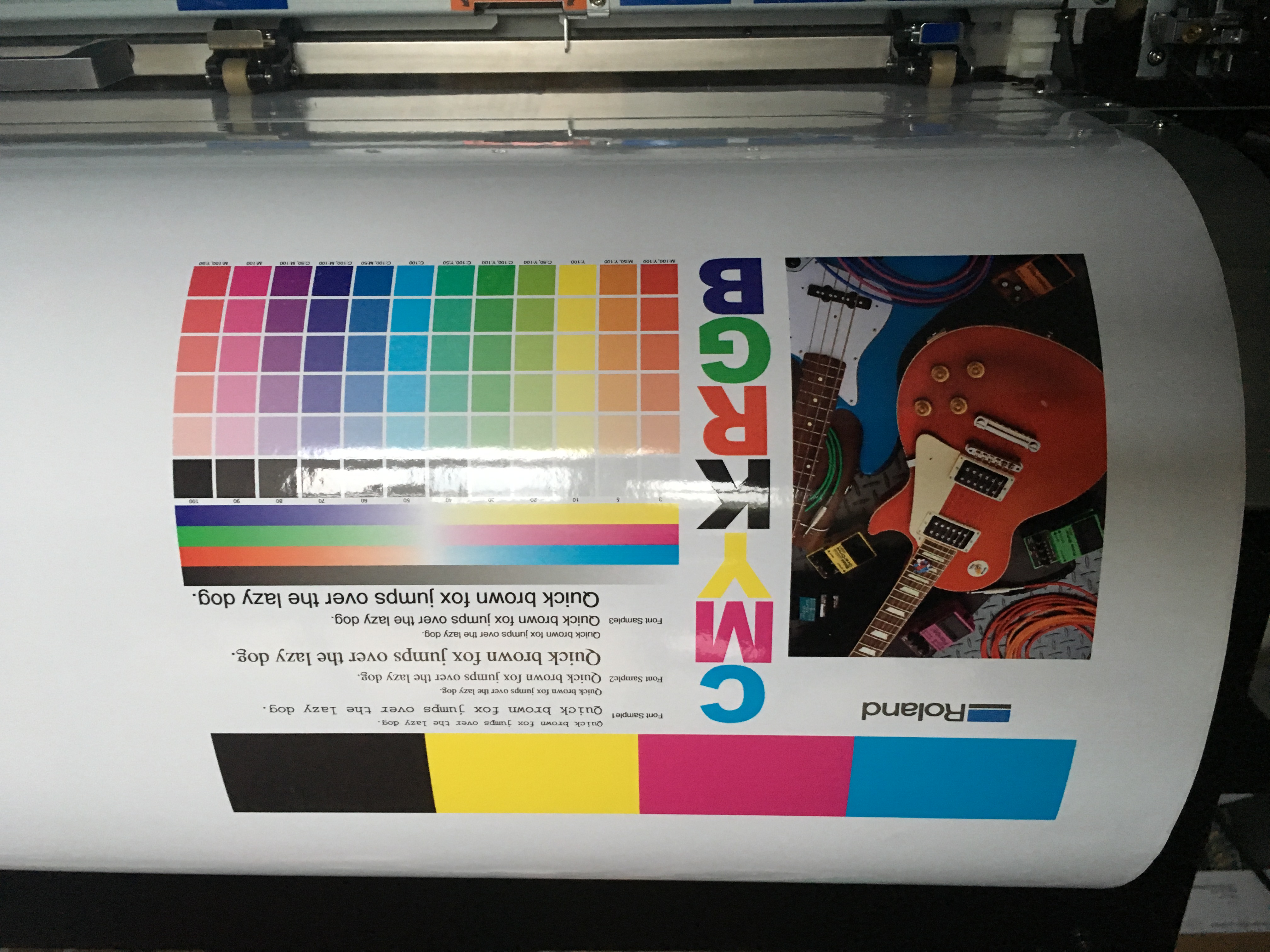

The test print is fine (black is the flash light).
