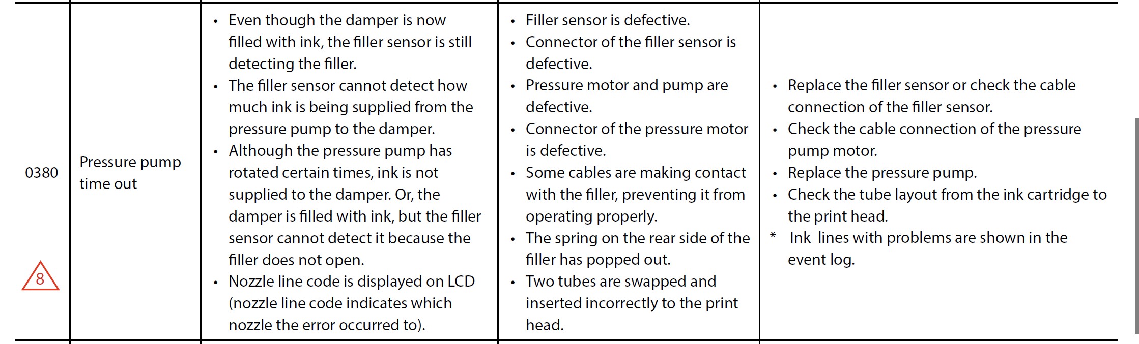

This may be a repair that you want a tech to do, depending upon your skills, as you said you are not a techie. See the attached for the possible causes. They mostly revolve around the magenta damper and its associated fill sensor. Let me know how you want to proceed...

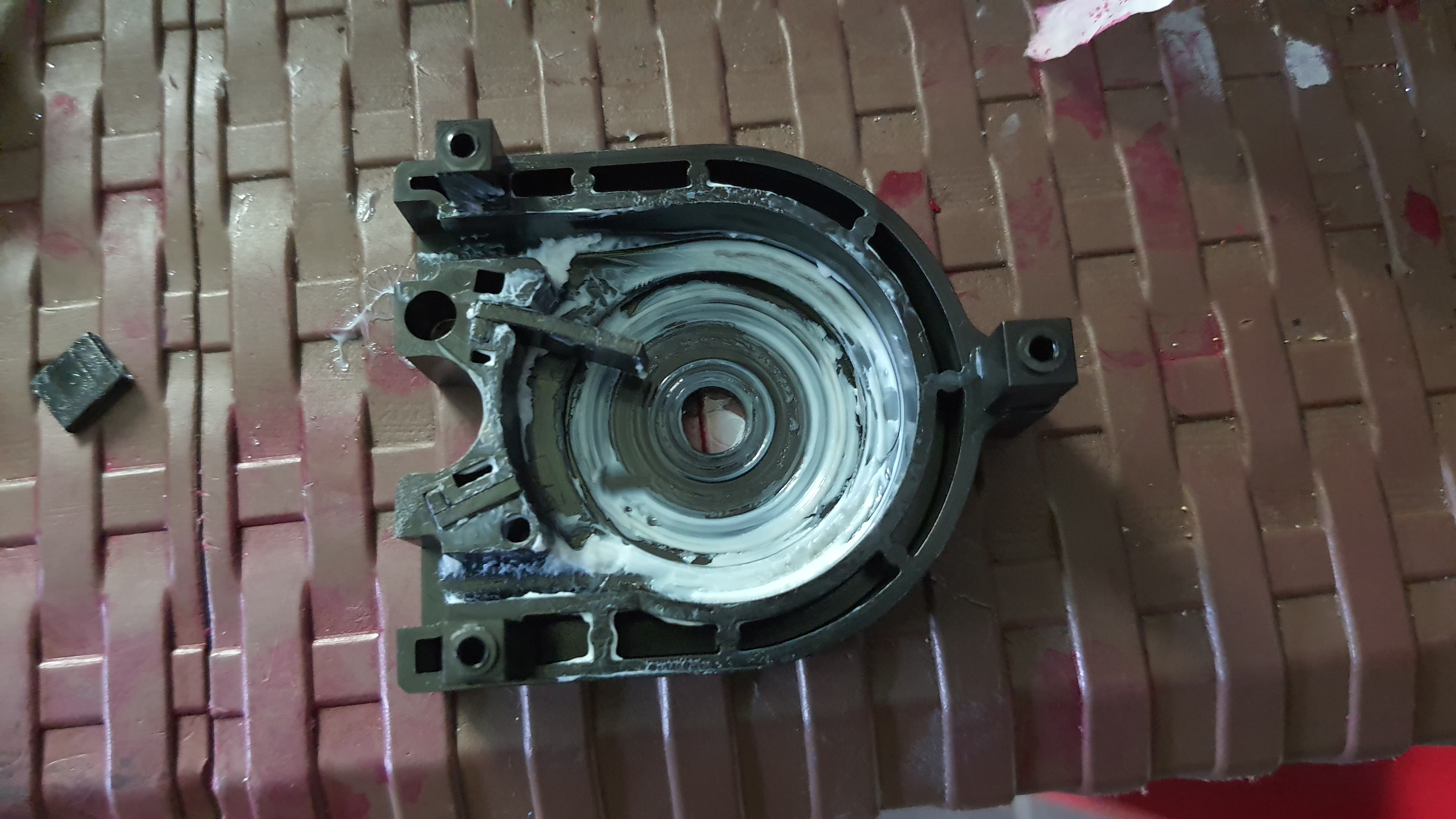

You have check your pump?I have 0380 [0040] , after check It was the pump.
