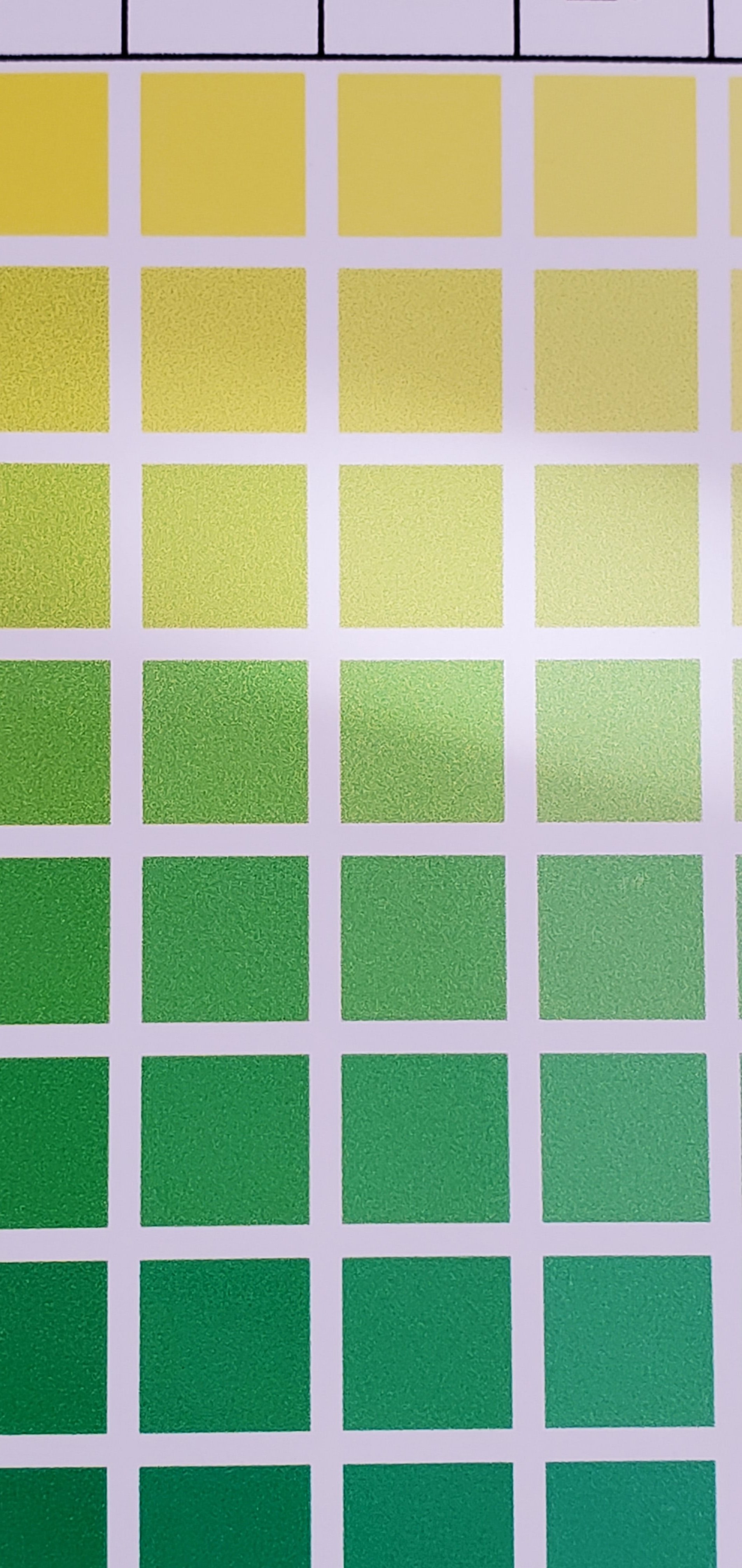

We've had this printer for only 3 months. It's brand new and has never produced solid prints.
We are extremely frustrated and are now being told by Roland techs that we are getting 'normal' prints for this machine... I find it extremely hard to believe that these are 'normal' prints.

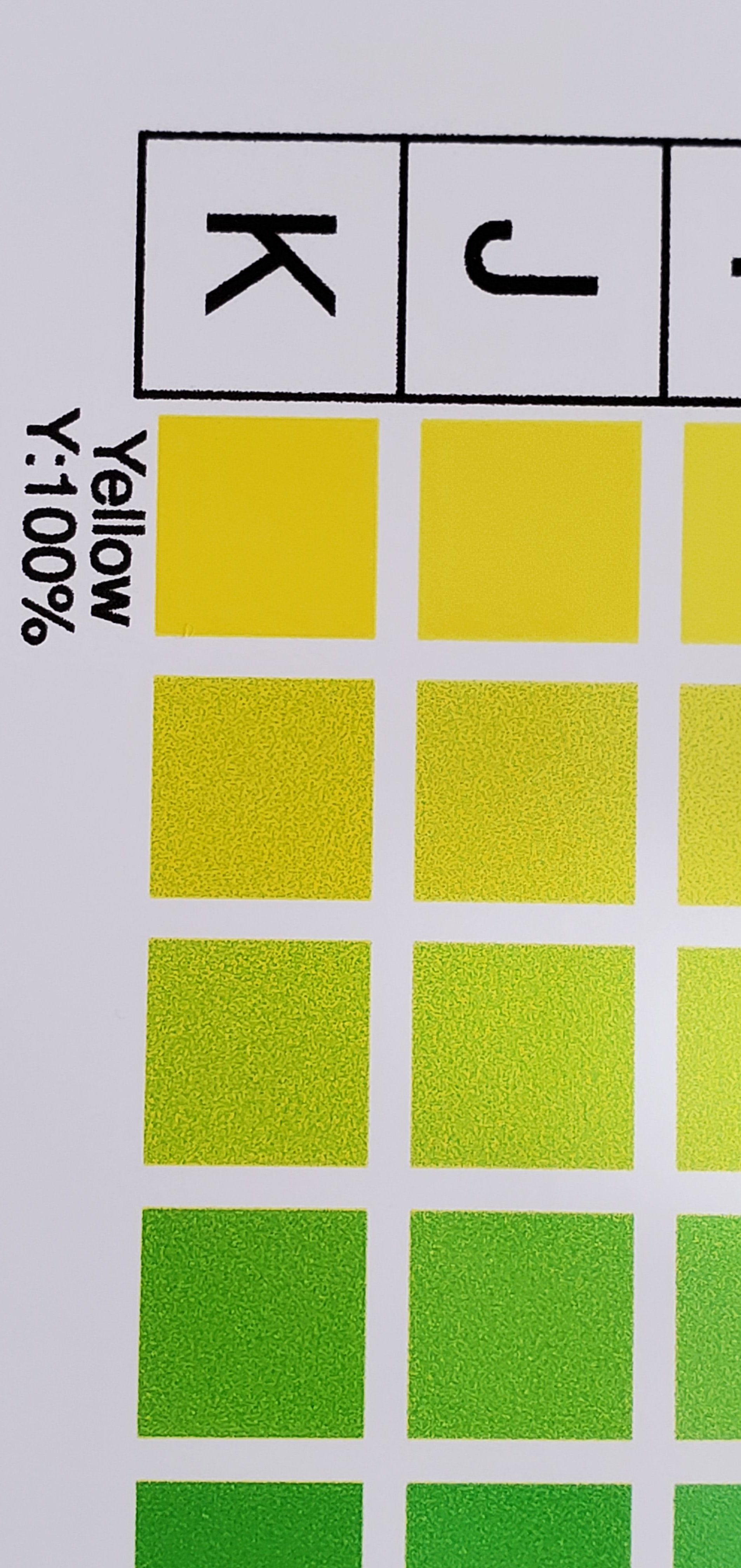

Yellow is decent at 100% - however, the yellows next to it on the chart are very splotchy with greens/blues.
Mostly all of the lighter colours are spotty and grainy.
We have tried multiple different profile settings.
Nozzle checks are good.
We have adjusted all of the calibration settings (that we have access to).
We've cleaned it many times...
Out of ideas.
Any feedback would be appreciated.

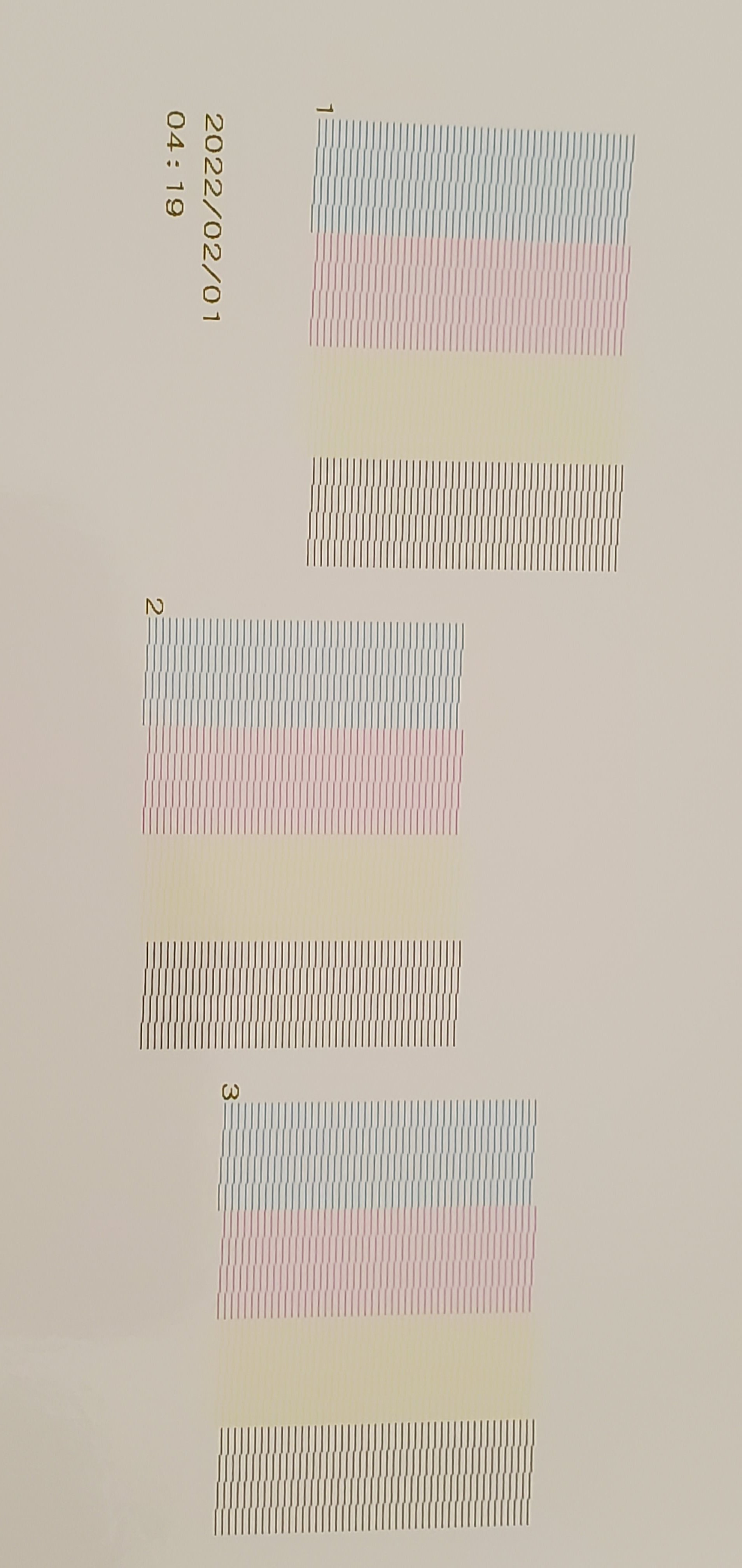

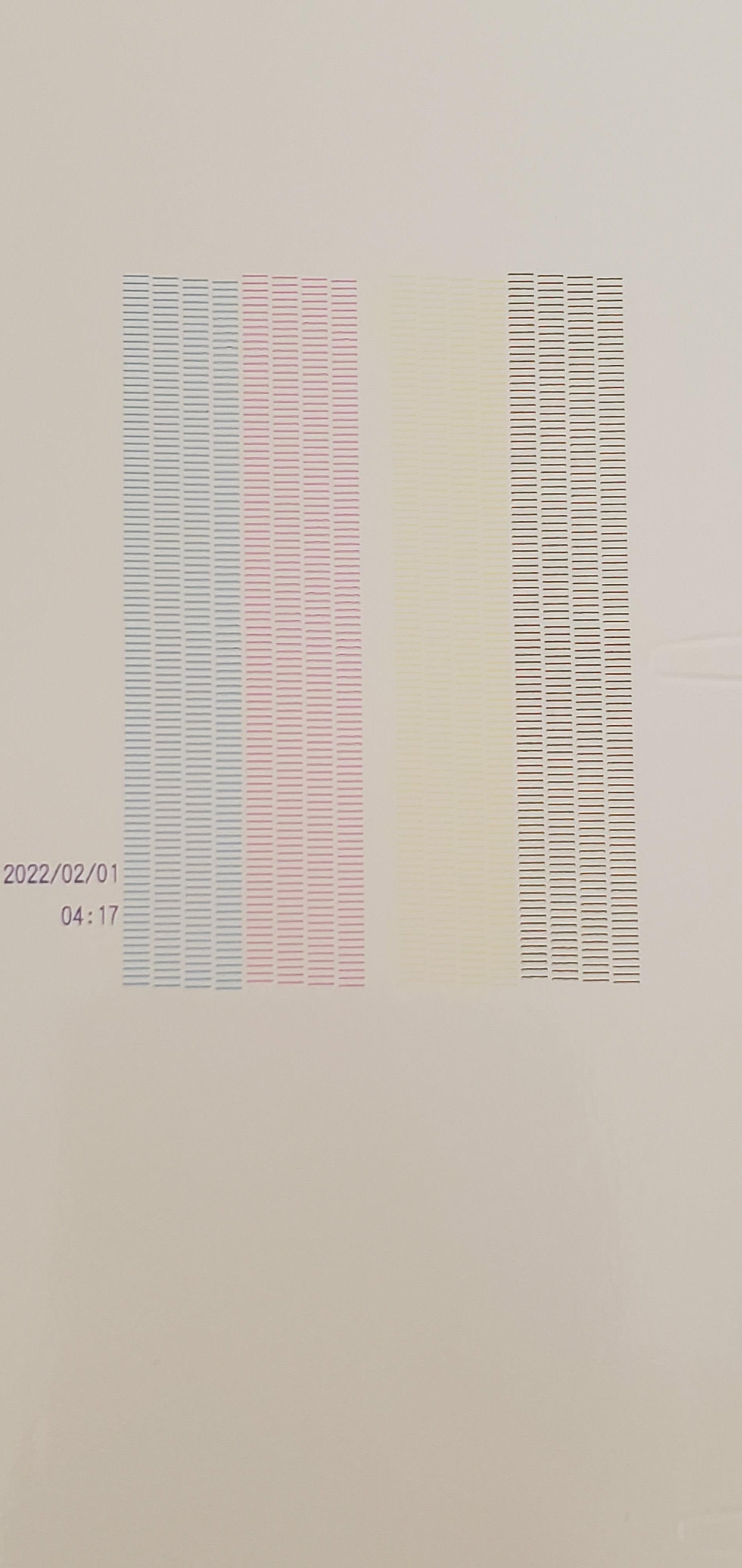

Can you post your nozzle test print?

Unfortunately the Roland tech is correct. You've posted a rather extreme closeup photos of small swatches but want to see more quality than the printer can deliver. Try getting samples from other makes and models of printers which use more inks which include light cyan and light magenta as well as higher resolution options.
Good luck.

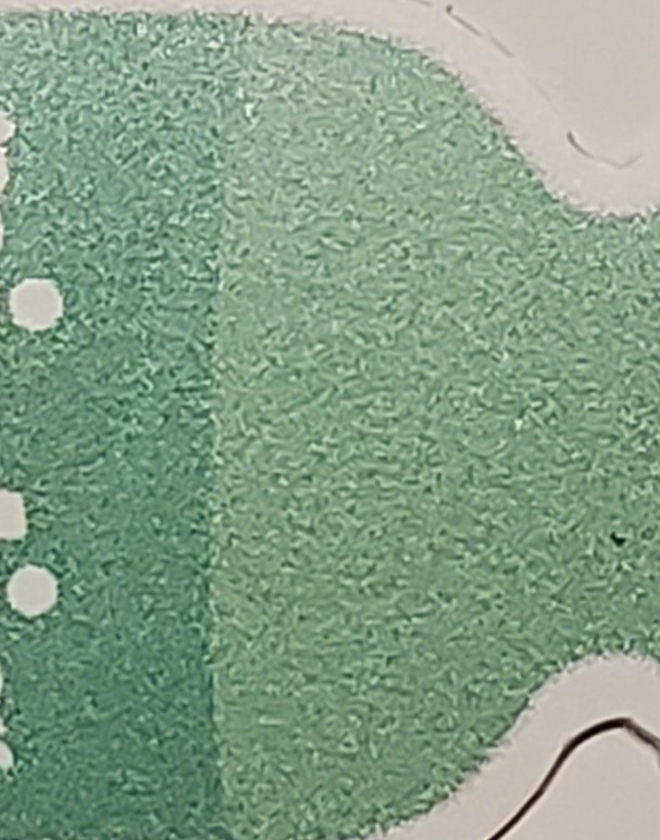

Thanks for your feedback.. I guess I just expected solid colours. Here is another photo of a recent print. I find it extremely hard to believe that this is an acceptable quality. 20220201_174923 (1).jpg

Try to consider how a printer with the four colors, CMYK, would need to make shades of a color. To make a darker yellow of 100%, the print would require another color(s) to produce more density, and thus a darker yellow. From up-close, you're seeing the other colors dithered in that yellow. Your machine is a large format printer for signs meant to seen from a distance.

I should have mentioned, it's the lighter inks available (not to mention finer resolution) on other printers which help alleviate the artifacts you're seeing.

What are your heat settings like? The dot gain looks weird on some of these photos.
And re-asking as ColorCrest has... what resolution/passes are you printing these samples at?
The black lines and text in the Roland color chart sample doesn't look crisp/clear. Apart from the dithering issues, this would worry me just as much.
