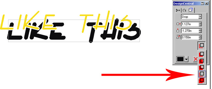

You can also do it from the Shadow module but it takes longer to figure out which settings to use than to just do it the way Ryan_Long explained.
jayhawksigns
The nice thing about doing it with the shadow module, is that if you need to change something with the text, you won't have to go through and redo the shadow.
