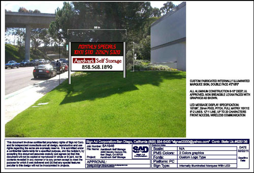

oksigns
yes exactly this I printed these off all the time on presentation board.
attachment.php

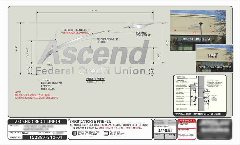

This is a sample of the mechanicals we do for most jobs.
We call out the sizes and other specification, but more importantly
our prints have scale called out and are printed to scale so that the builder or anyone else
can put a scale ruler on the print out and get the size on any part of the sign.

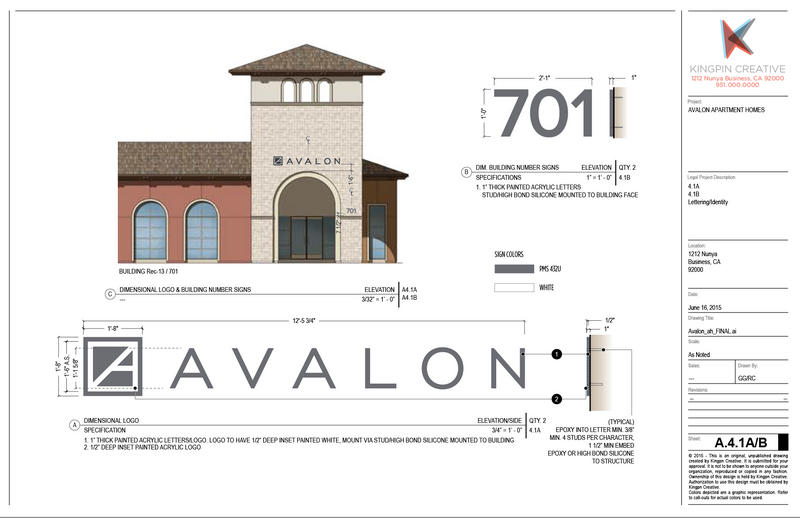

This is what our submittals look like.
Depending on your letter size, you may only need 3 studs per letter.
If the copy is exterior on a new building, they may not want to embed that deep due to waterproofing... the architect or contractor will let you know.
I know how to use Corel, but the way I design and draw these geek drawings, Illustrator with CadTools fits my workflow.
For one thing, I can design in multiple scales on a single page, layers are easier to work with, Cadtools has more options
I dig the drawing tools, dig how I can pull templates and drawings from my symbols palette I set up - in the scale I want.
Corel is a great design/sign/drafting program - this coming from a guy who designs on a Mac in Illy
But Corel does not do what I need it to do...
