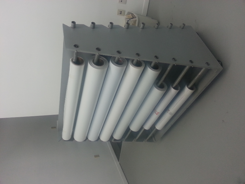

thanks, I have been looking for a way to store the plotter vinyl that was space friendly
not a fan of storing material vertical always found horizontal to work better and on a rack with wheels. keeps the edge off the floor and allows to be moved as needed
CP Signs
Hope this works. It was only $100.
CP Signs
Genericname: I love this rack. Once my new shop is set up, I'll see what kind of room I have and will probably get another one. Tx
Yeah, they're pretty great. When I first got here though, the print room was cluttered with three or four of them. I reorganized our storage, and was able to minimize it to a single rack. Good to see the extras go to a good home.

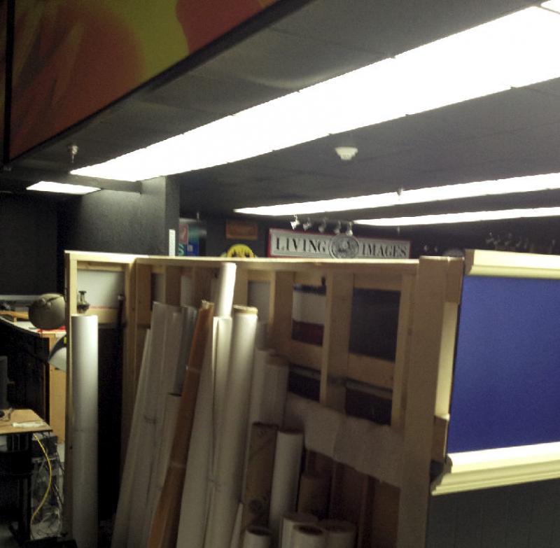

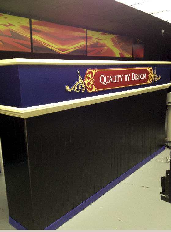

I'm just getting started. I detest mess and clutter, drives me crazy and I don't need more crazy. Here are two things I just put together for the new shop to keep things neat.
First one is a free standing vertical visual device barrier which is viewed from the front customer area. Behind it is all of my larger rolls of media for the printer.

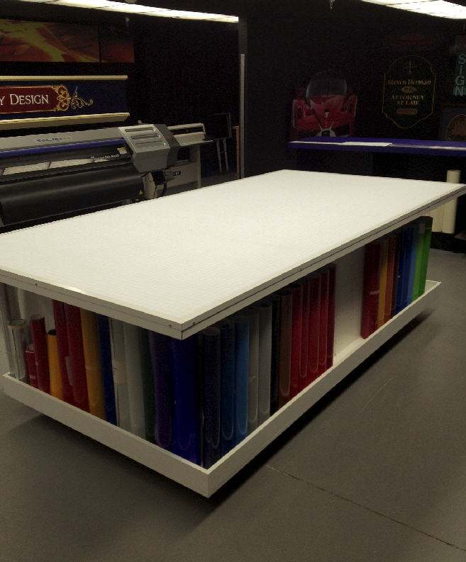

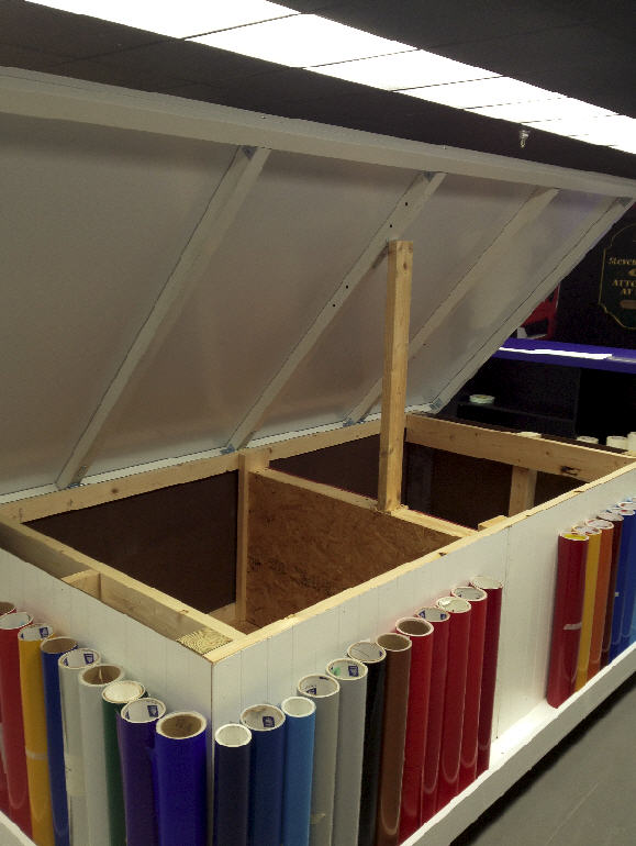

The second one is a 5'x10' weeding table with the Rhino self healing cutting mat. I built it on wheels and will store the several hundreds of drop cuts in an assortment of materials I have accumulated over the years. When a client wants to see how big a certain size is or what the material is, I can pull it out of the bargain box and sell them what's on hand. Helps to get rid of small scraps and saves time having to find and cut stock down. Around the base I have all my vinyl colors stored so the client can pick and choose the colors they want, plus it's easy and convenient storage.

Signmanic,
I really like the storage under the weeding table lid.
If you lined the inside with activated charcoal & some lime you could store a body there for months with no one catching on.....

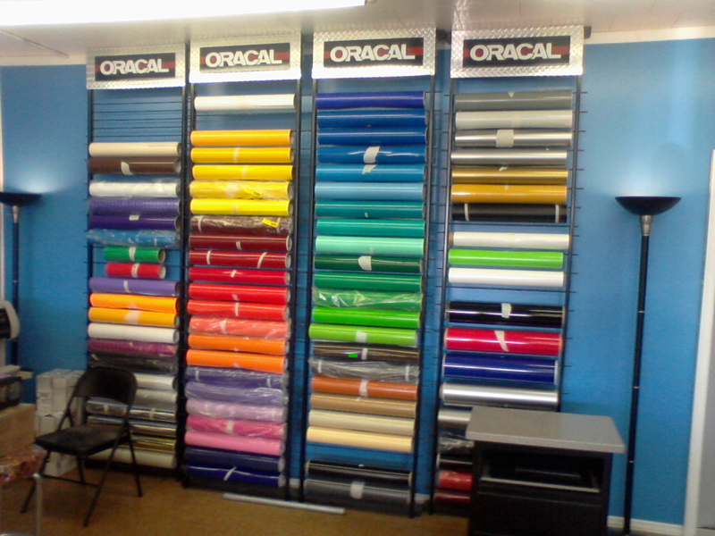

When we moved to our new location a few months ago we needed a place to store vinyl that was economical and effective because we drained our resources on renovations and our budget toward the end was pretty limited. I came up with this system that cost us about $300 to build and holds up to 96 24" x 10 yard rolls of vinyl. I used 8 bars of 14 gauge strut channel http://menards.com/main/electrical/rough-electrical/strut-supports/strut-channel-14-gauge-green-10/p-1628654-c-12477.htm and sanded and painted them black with rustoleum appliance enamel. I screwed 2x4 studs into the floor and ceiling and then drilled and bolted the channel to the studs and spaced the channels approximately 26" apart. We bought 96 1/4" steel rods cut to 30 inches long and painted them with rustoleum. The rods slip through the very large oval slots in the channels to support the rolls of vinyl. The oval slots are spaced every two inches so the slightly less than 4" rolls of vinyl fit perfectly with little space to spare. Customers can see it from our showroom space so it's an attractive way to show off our inventory. To dress it up I had 4 pieces of 1/16" diamond plate aluminum cut and I applied them to the channels with double sided foam tape. Then I made the Oracal signs from cut vinyl on foam board and attached the foam board to the aluminum with velcro pads so if we ever want to change out the graphics we can change them easily. So far they are working out very well and I love how they take up little space and look attractive as well as functional. The racks, however, are full and I have a slight overflow of vinyl that stays in boxes off in the corner. Eventually, we will probably have to add two more sections and then I think we will have more than adequate storage.

Thanks, Sign Maniac! I like yours too. It looks like another efficient way to keep rolls nice and tidy. Did you notice my awesome step stool, a.k.a. generic folding chair? Building a quality step stool will be my next project...hopefully before I break my neck.
