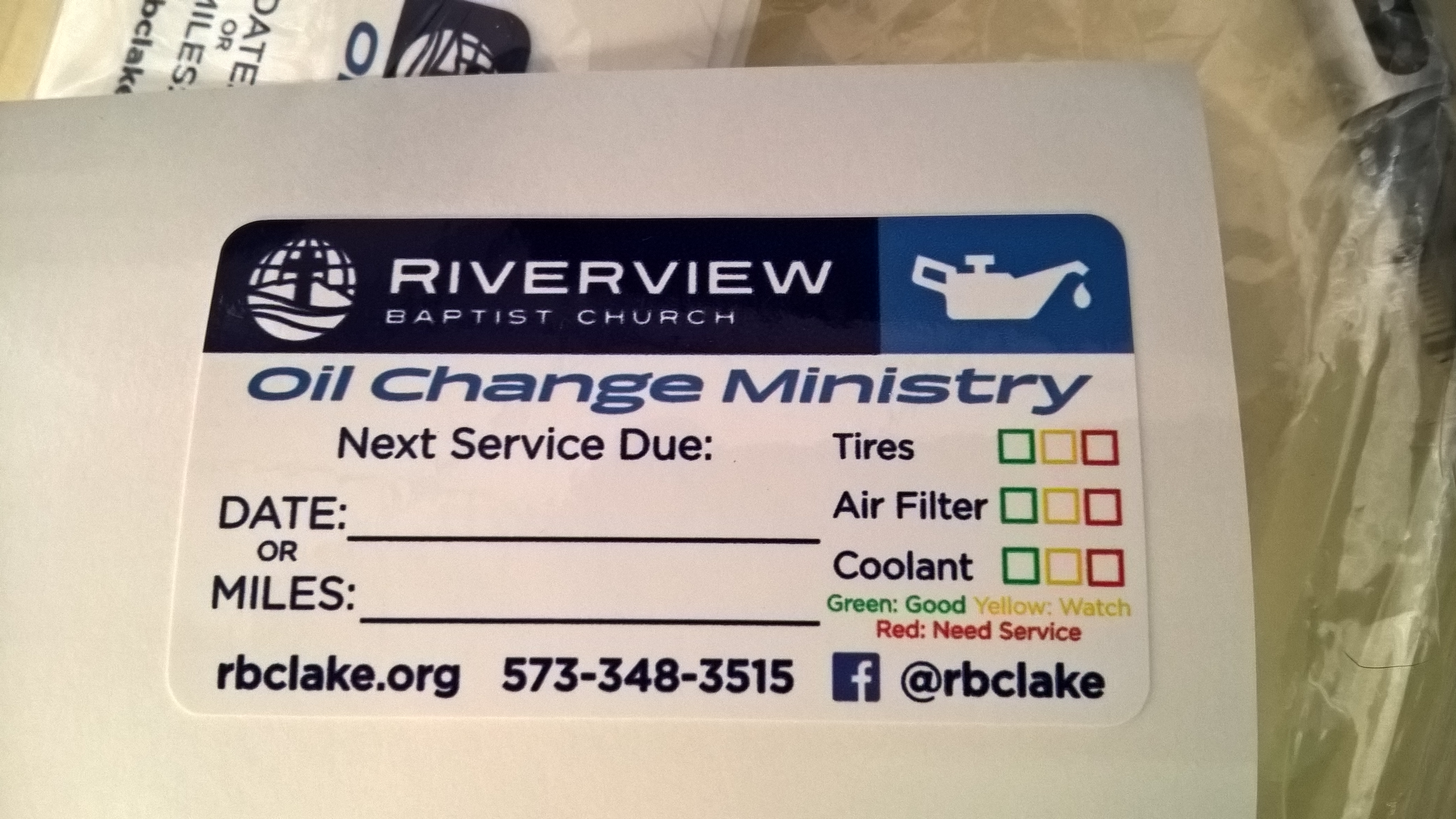

We just printed these static clings, which are 1.5"x2.75", on our S70670. Those red, green, and yellow letters are 4.5 point text. The words Baptist Church are even smaller. I didn't bother to make a new profile for the static cling, and it's a little overinked because the material doesn't have as high ink limits as our regular vinyl, but it still comes out OK. With a better profile the dark blue would be even sharper.

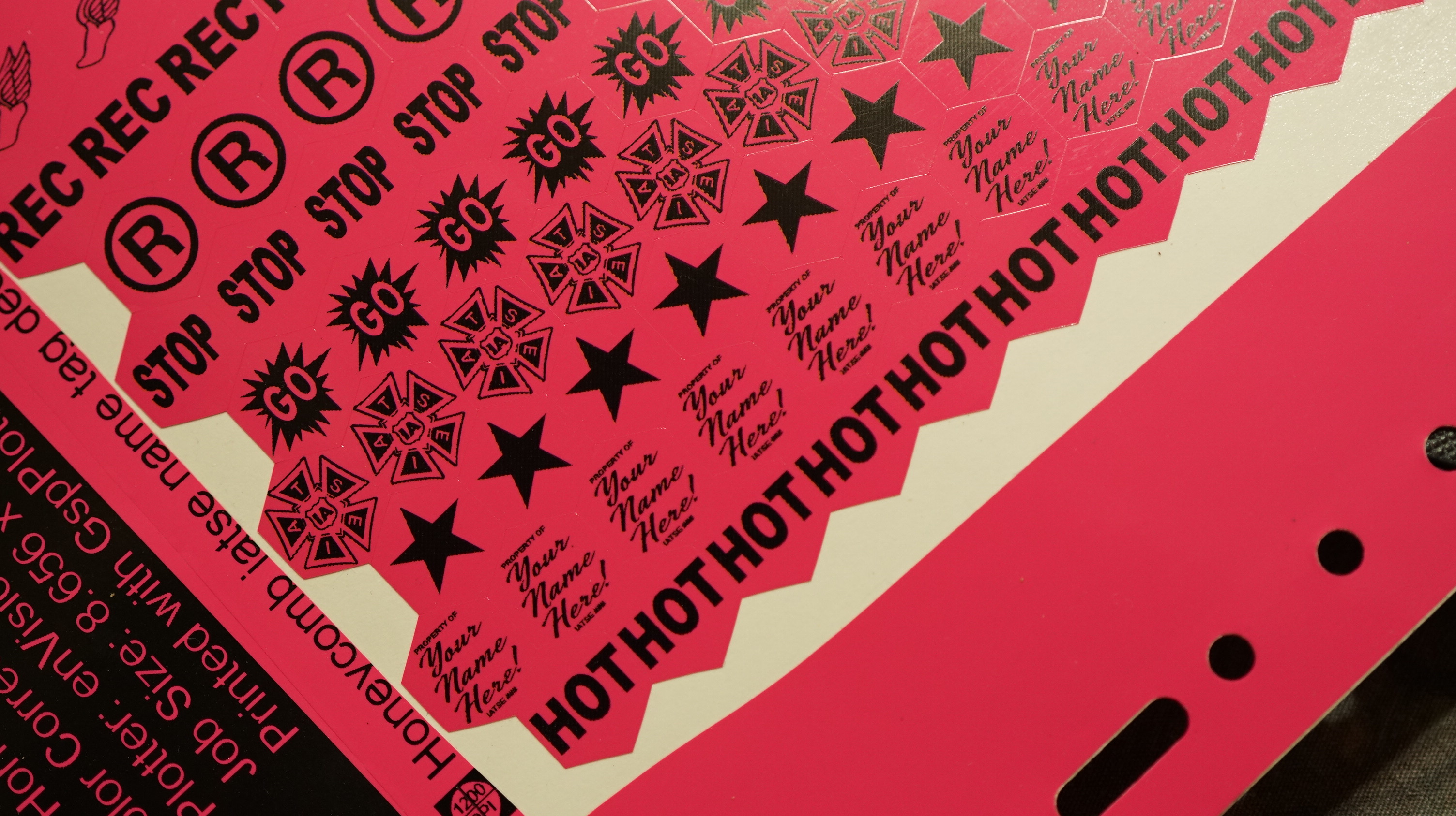

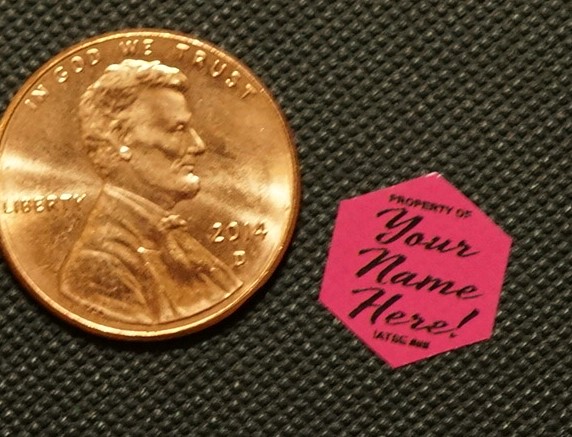

Hi, It's not from either of those printers but I'm proud of it's design so take a look and forgive me. 3/8" high hexagonal decals with minimal wasted material plus very small print so small I need a magnifier to read them.
