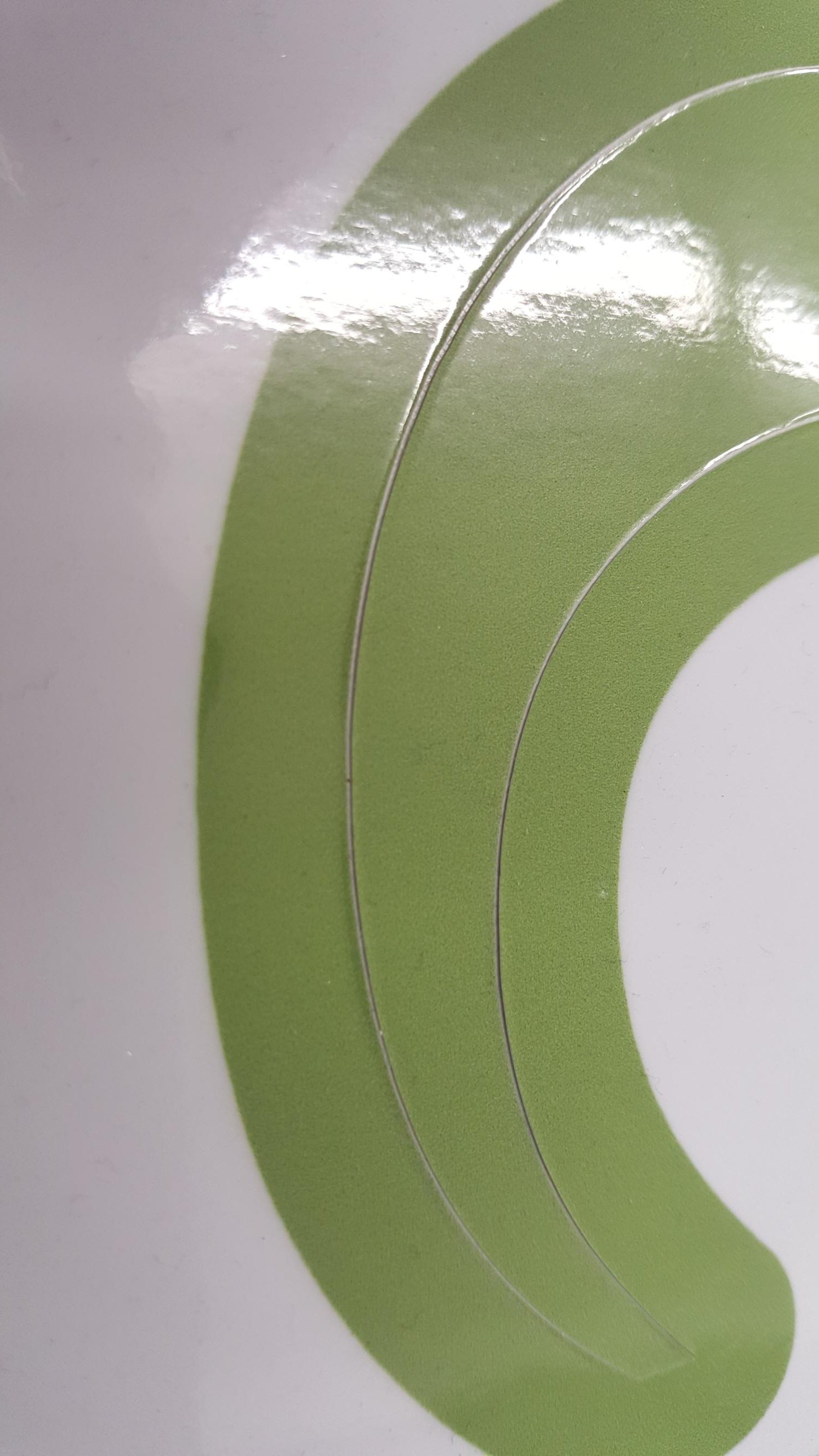

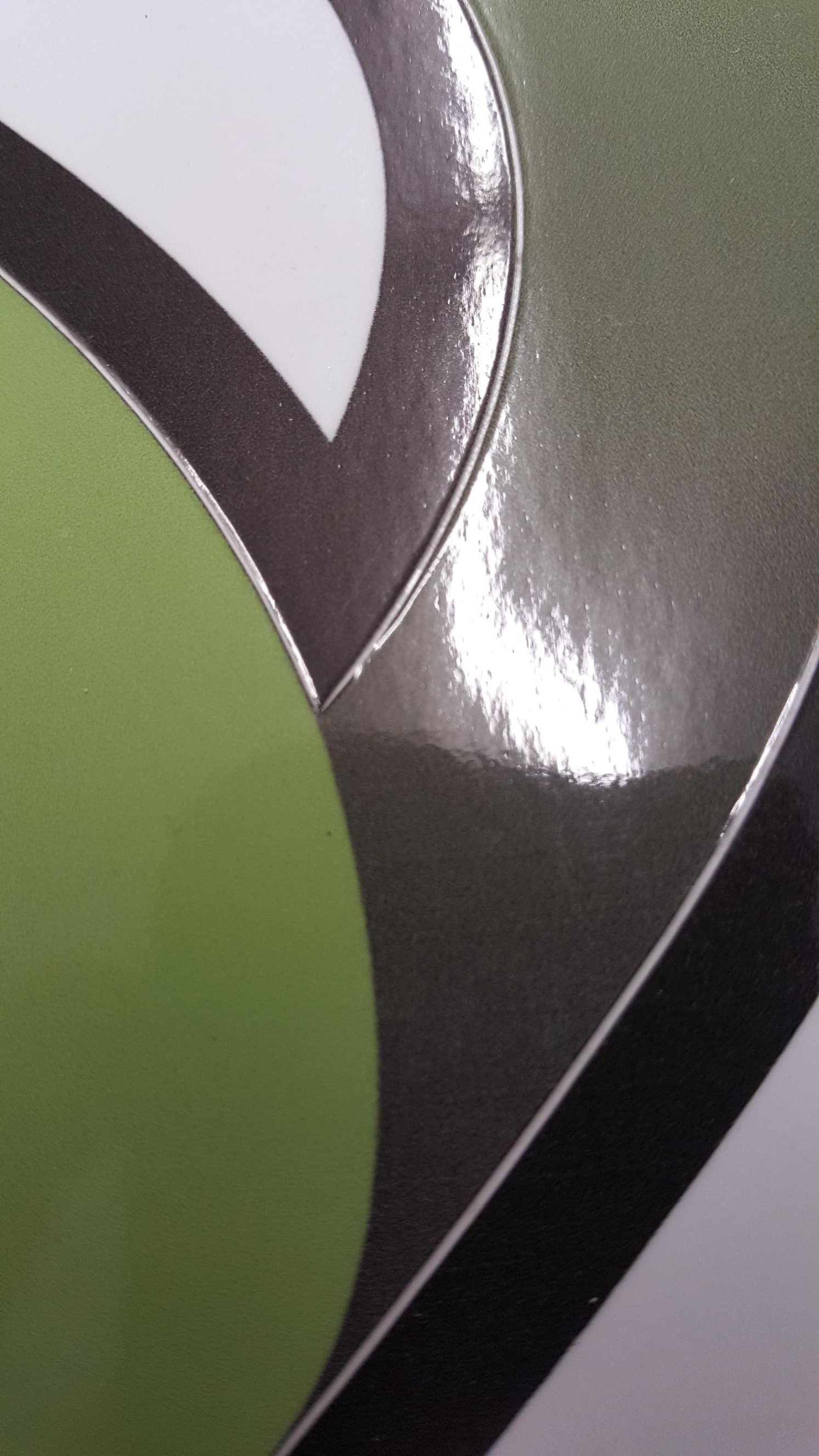

we have been having issues with some of our prints failing within the first month after install. The edges have been curling up and dirt and water have been causing them to left more. We were told it was due to over saturation so we changed our print profile. It continued to happen. Then we were told its due to much tension when laminating. We changed the tension. After another month or so we thought we were fine but we now have another job coming back saying its starting to peel up. We are at a loss of what could be causing this and our suppliers do not know what is happening either.
We had a print sit for a month or so in the shop as we waiting to do the install and we noticed it has shrunk and started to do the curl and wondering if anyone else has run into this issue. We used an orajet 3620 (i think) with oraguard 210 lam which we were told is the correct pairing. does anyone have any recommendations into why this has been happening?
Anything ideas will help.
Cheers

anything contour-cut, i only trust cast materials.
however, even though it is calendared....3620/210 boasts a 4yr durability, so it is definitely odd that it is happening to you in such a short period of time.
lamination tension could be a factor, but you've addressed it
ink saturation as well.....
my only thought is that the 3620 falls in the "static cling" vinyl category, being a water-based removeable adhesive. its not designed for longevity.
Anything contour-cut, that's intended to last longer than a few months, I'd play it "better safe than sorry", and just upgrade to the 3850/290 combo (assuming transluscent is your objective). bit pricier, but it will last.

My Mistake its the 3169RA paired with 210 , which I think is even more bizarre to fail so early

I agree that the problem stems from using a "removable" adhesive. My experience is that most of these should be called non-adhesive. I definitely wouldn't contour cut full bleed graphics with them. It's clear. it's meant to be used in rectangular sheets. Even then, you will experience premature adhesive failure--even indoors.

aye, 3169RA still a calendared vinyl with removeable (weak) adhesive..... BUT it should last more than 1month!

yes. using roland soljet pro 4 - generic setting in versa works - letting print outgas for 24hr before laminating
I'd start looking at other materials if you've tweaked your process in every other way. We use IJ35c paired with arlon 3420 satin lam. Works beautifully and stores really well. I contour cut & mask to deliver to a construction outfit that does their own vehicle installs, several months later at times. Haven't had any peeling issues or anything come back with a failure, and that's been about 5 dozen a year since 2015.
What print profile are you using for the IJ35, we have IJ35c paired it with 210 or 3m 8508 and we were told by our suppliers that it is way to aggressive for basic vehicle decals which is why they said the orajet would be better for us

Calandered vinyl and lam + solvent inks + removable adhesive = failure
Do you have the same issues on other media?
LarryB
I've noticed with Oracal rapid air if the ink goes to the edges it will always curl up over time. For this reason I never use it anymore. Also calendered vinyls will always shrink on edges.
If these are going on vehicles you need to use a cast vinyl and laminate which will not shrink.

your photo looks like pre-weed, ink saturation and lamination tension is my thought for an explanation prior to installation
ANY TIME you are using calendared, try to avoid full bleeds, we prefer to leave a minimum .125 white border
also as mentioned use a permanent adhesive
if you have to do a full bleed on ANY calendar material, try using a CAST lam, we stopped using 210 because of the shrinkage and how it forces the material to curl

Ditto.. If at all possible leave a bit of white i.e. shape-cut vehicle graphics being applied to a white trailer. Even our prints applied to white alum we cut smaller to leave the alum edge exposed.

I have used a solvent for 13 years, first a Mimaki and now an Epson, and we always cut through the color. I hate white fringe around cut decals. We have never had curling up problems except when we tried a 3M with removable Comply adhesive. Our run of the mill vinyl is GF Concept 203 and we laminate with Briteline Shield UV. On vehicles we prefer to use Avery 950 for small decals or MPI1105, both with DOL 1360 laminate.
No such thing as too aggressive for vehicle decals. Vehicle decals have to survive driving 80-90 mph, high heat, extreme cold, car washes, power washers, blasting with dirt and mud.

This is simple . you have to laminate the print after you print it and before you contour cut it. This is happening because you are not laminating your prints before you do the contour cutting.
