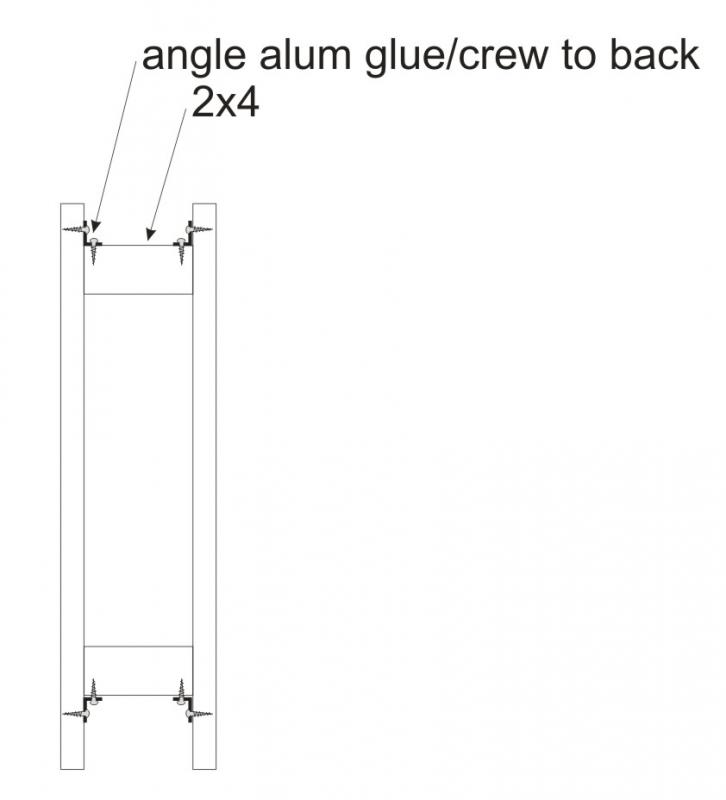

I am doing a carved sign with gold leaf and I am wondering how to install the sign without drilling into the face. I've seen a lot of different brackets but I'm not entirely sure which is the best way to go.
There will be 2 signs on each side of 2 4x4's. The signs are 3'x10' on 3/4 komacel.

like this maybe?
edit: crew = screw

What material, redwood, cedar, hdu?
countersink and fill the holes if it is in a painted area of the sign.

Cleats would be my choice. Also, be careful with Komacel. Expansion and contraction could bite you in the aZZ with the climate you have in N.Y. Especially if your background is a dark color. Make sure whatever fastener you use, can breathe...

I think you are going to have some difficulties with both the signs and install. 3'x10'x3/4" PVC on two 4"x4"s may be susceptible to cracking, especially in the winter. I would bond them to something like dibond and/or run a couple angles ot tubes across the back. This would add rigidity and give you a fastening point.

3' x 10' is a lot of weight and a lot of stress on any sign. Since you're installing on 2 x 4s I would countersink screws and fill the holes with decorative rosettes or caps like you see old Norm Abrams use in his furniture construction. Once painted they would be virtually invisible. I would have 2'x4s going cross ways as well to reduce the stress.
The customer needs to know about the dangers of the sign failing if not properly installed. You may have to stick to your guns on this one if the customer demands an installation that may fail.

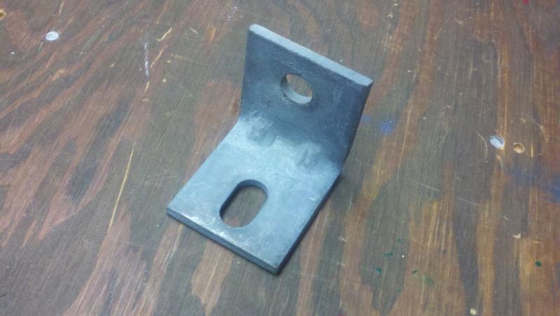

So A bracket like this one with the oblong opening (screwed to the PVC) should work?

no dont use a galvanized 2x2 L clip. Use some alum angle. And do not use 3/4" pvc for a 30sqft sign on posts. its going to warp and look like crap in under 6 months. HDU or extira is a much better substrate for outdoor sign use.
