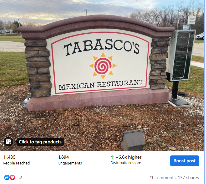

I just fell off my chair when I checked my FB this morning. I got this sign done yesterday and posted it on my FB page. Gino saved my life with bringing my little heater, sun was out but it was still a bit cool with the breeze. Two hoodies and my coat, took my coat off cuz I was getting too warm. It took me a while to heat this entire thing up with my heat gun so it stuck good - it's right up the road so I'll be keeping an eye on it. There's a couple little spots that have a wrinkle but it's sitting in the middle of a grassy area with 50' all around. Nobody will see the imperfections.
Check out the stats on this...11,435 people reached, 1,894 engagements and 137 shares. The most I ever had while in business was 2,000 people reached. I don't care what anybody says...FB is free and it's the best way to advertise.
And as you can see, Boudica and I had the same design, just different fonts LOL WOW...thank GOODNESS I was able to sell them this design vs. theirs. Thanks to everyone for your help, went better than expected!

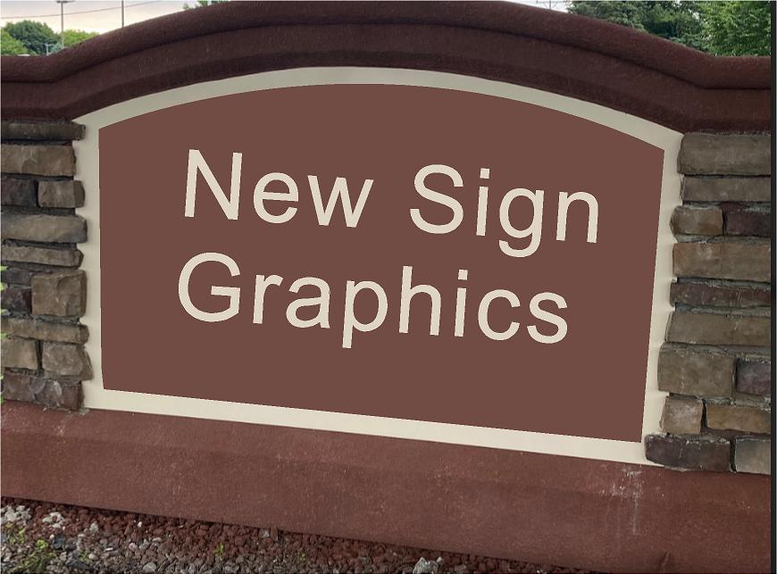

Make a new shaped panel and place over the top = 4mm - 6mm or better yet 12-13 mm see the pic
