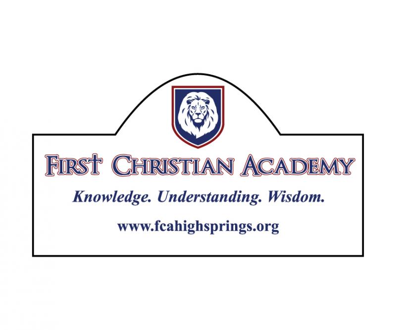

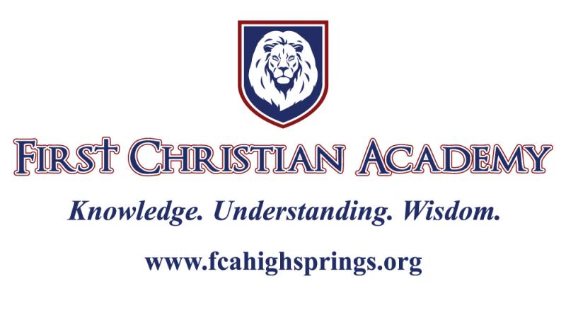

This will be my first paying job for an actual sign. I was given free reign to come up with a new design for this school. I am new at this, so anything you say will be helpful.
This is the original sign:
Here is my attempt at a redesign. The lion's head is the new logo and the school colors are red, white, and blue. My idea is to weave the school colors into the design without being to bold.
Thoughts or suggestions?
Thanx
Mike
Your layout is very nice. I would only suggest that you might want to create your layout over a whited out photo of the existing sign or recreate the shape of the sign as an outline to design within.
Is the lion clip art? It's rather nice. It appears to represent a prestigious organization, rather than a high school football team like the current lion does.
You might also try modifying the letter R so that the main copy fits together nicer. The R with it's long tail makes it appear as though the kerning is off.
Solego
The lion's head logo is a vector created by the guy who does their website. He gave it to me free to use for the sign.
I would like to have a border but am not talented enough to create the shape of the sign in illustrator.

Your not talented enough to push a few nodes around in AI, but your designing signs?
Take a break from "designing" play around with illustrator for a few days and learn the raw basics. Drawing out a basic shape for a sign like that should take about 3 minutes and it's REALLY something you should have in a proof for your client.

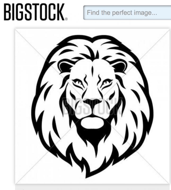

The website guy must work for Bigstock as a designer.

I like what you did, but please kern those couple letters! Ive seen alot worse and I dig the font you chose. Good job imo

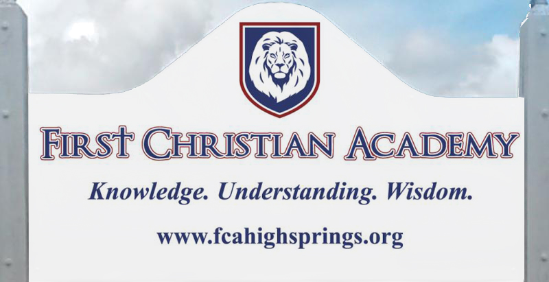

I took the overwhelming advice and worked on the kerning. It only took me an hour. How does it look?
