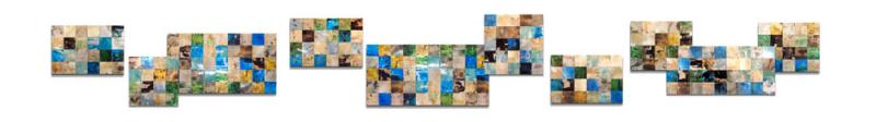

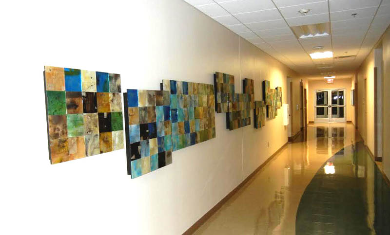

i have a set of panels that were installed at the Sierra Providence Hospital in El Paso a few weeks ago. my shop is located in the houston area (11 hour drive).

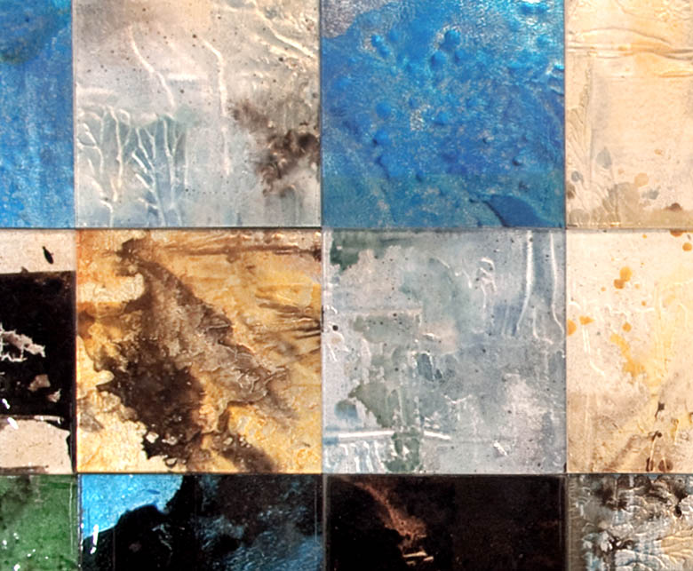

two different adhesives were used on this project. 8 panels got sika-bond. never had an issue with this adhesive.
two panels were glued with an untested adhesive because we had to deliver to a truck the next day and it was past midnight (rush order).
i have gotten word that there are tiles that have fallen off these panels. the buyer refuses to send me photos of the extent of the damage. just keeps requesting that i
confirm a date that i will fly or drive to el paso to "view the space" to repair on site or something far more complex.
is there anyone that is in the el paso area that has a slow week that might be interested in a site visit/photo shoot/possible repair?

i used about a 1/2" high blop of sika-bond on each corner and then a small "x" in the middle. sika-bond cures in about 3 hours. the alternative adhesive just never cured, so i pulled them up and added lexel silicone. works well but it's much slower than sika-bond. we then headed to the dock with the pieces. the offending panels were not acting right so the frame shop manager swore by gorilla glue cynoacrylate (kind of slow thick-ish super glue). i pulled them AGAIN and placed this super glue at the corners so that it would well up at the intersections. how these pieces are falling off in that each tile weighs nothing with three different glues in the same spot and that the pro installer didn't see any sign of an issue while installing is beyond me. but now weeks later i've got word that gravity is ripping these lightweight tiles off. perhaps they were transported wrong or in a 120F evinronment?
