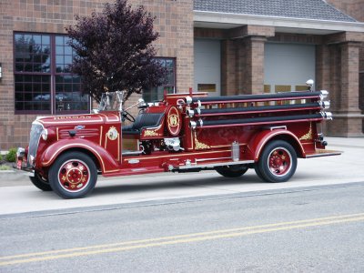

I have been looking for a pic of this truck forever, it's the best I can do.
This was done by Billy Beckner of Canonsburg, PA, for the Herman VFC.
It's all gold, all hand done, and breathtaking.
