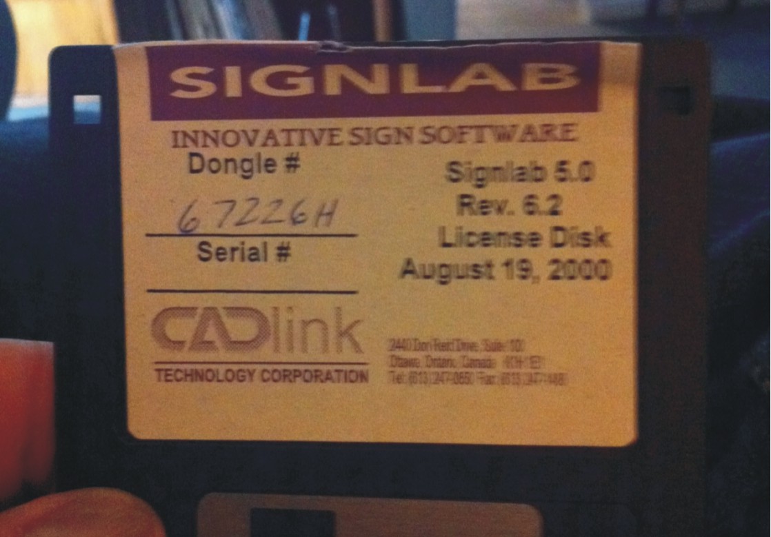

There you go. I have been working in SL for quite some time. Just had to re-install it to my desktop station, getting to where I can do it in my sleep but I still learn new tricks all the time. Just a nosy question, why not print from signlab using vpm? You might get a kick out of attached pic. Found it cleaning out old boxes the other day.
haha I have my 3.5" disks too!!! I still use that oild font book it came with. I don't have this computer set up with the printer, but I don't have the print package either....but what does VPM stand for?
Visual Production manager. Comes with print package.
