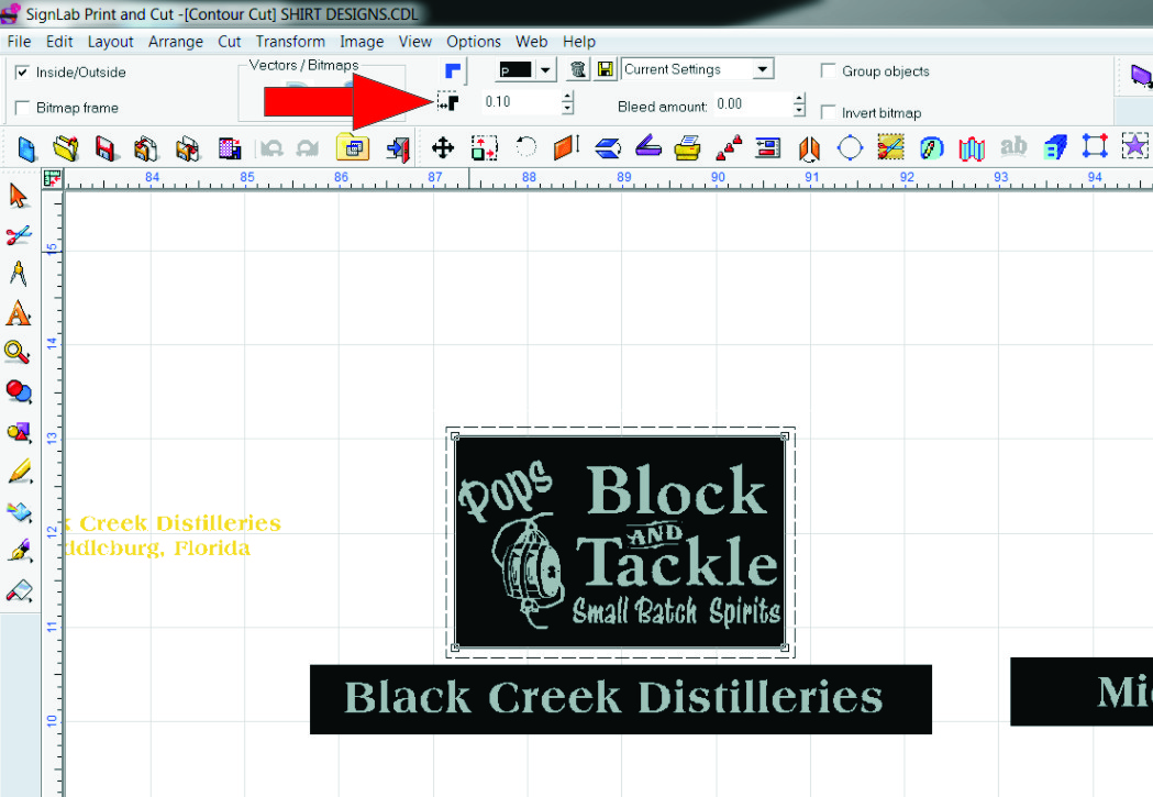

Using contour cut tool you can adjust bleed for contour.

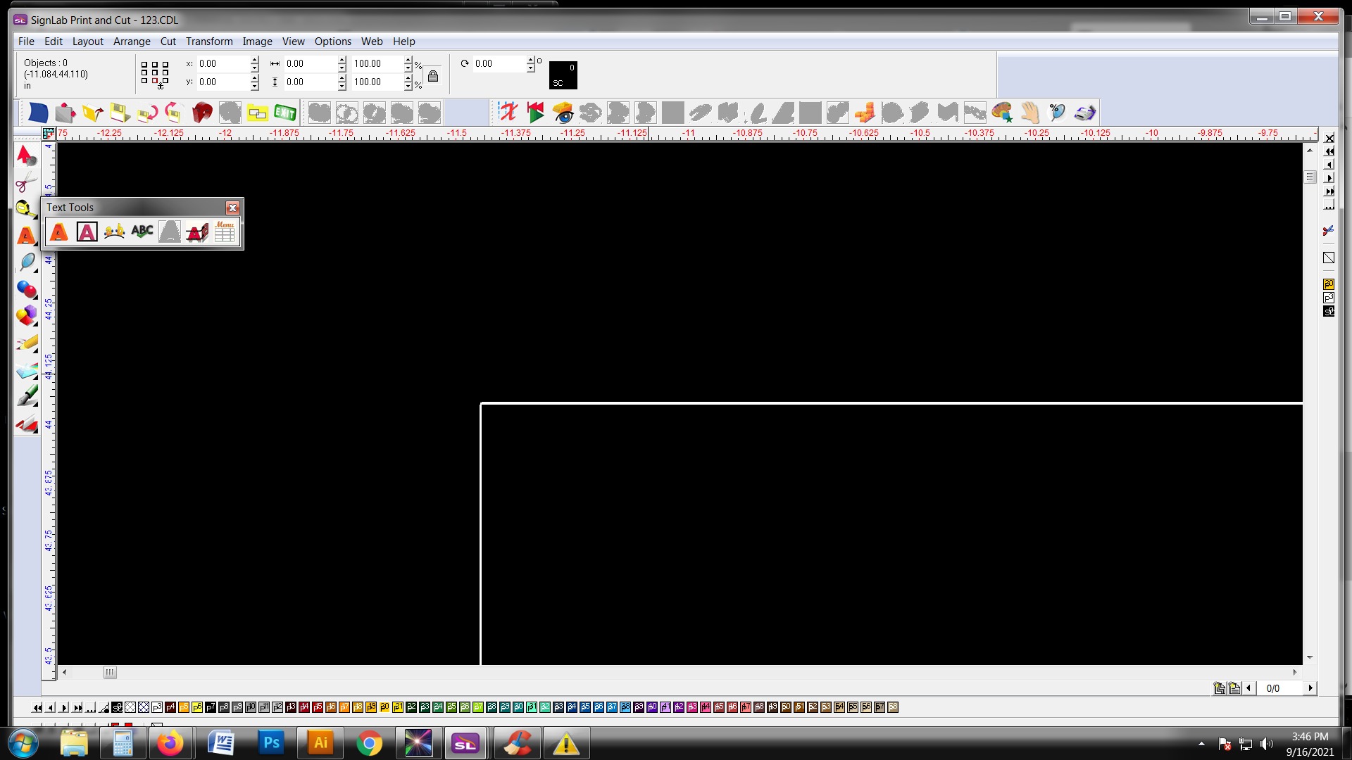

I have this problem too all of a sudden, actually I left work for a hip replacement & now my contour cut has a thin white line.
Any clues on how to avoid this, fix this?
