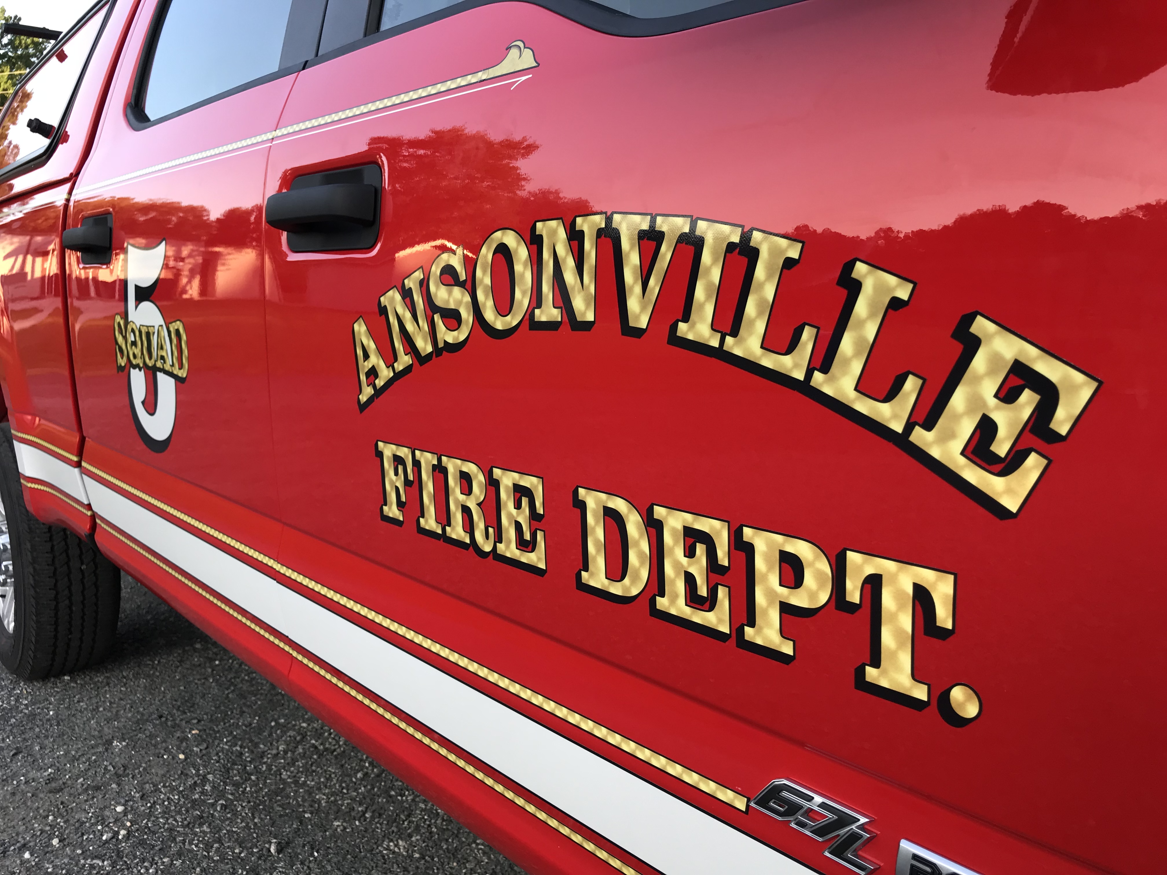

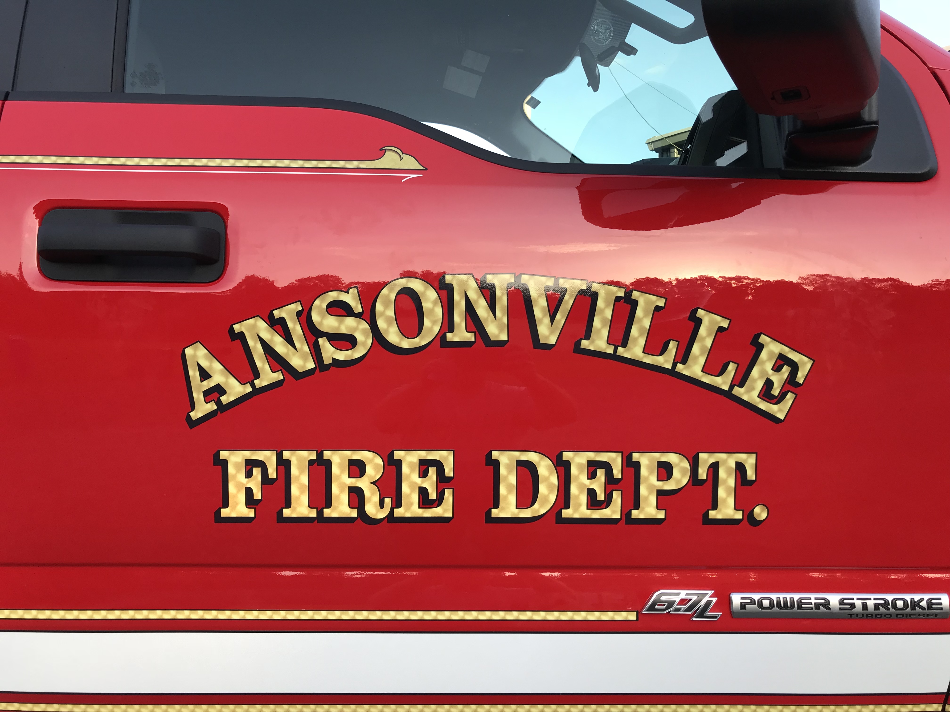

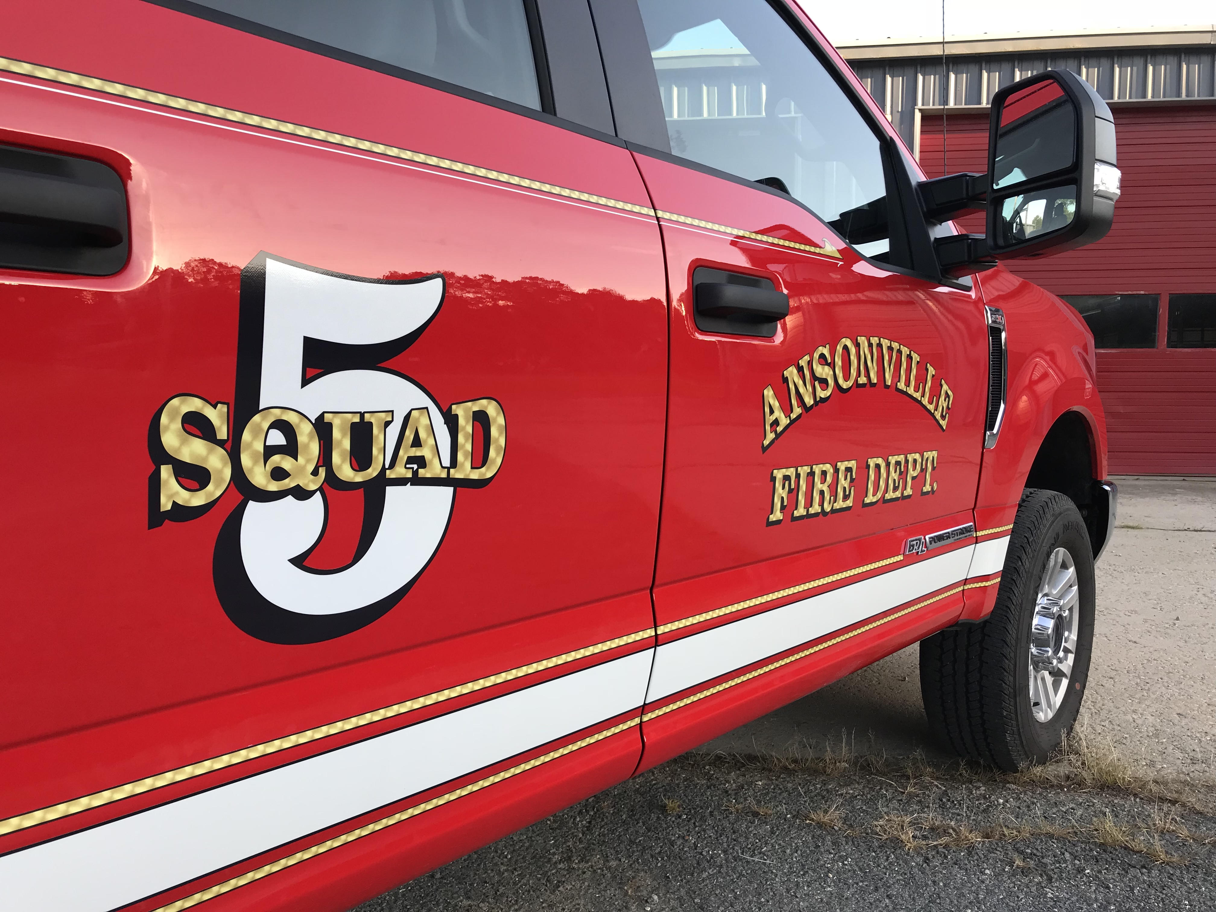

Thank you for the info letterman7
You wouldn't happen to have a photo that you could share of how it looks?
And would you consider selling your Hi-Rez seamless photo?
Thanks Gino, I was hoping Fred would chime in but most likely he's on vacation.
I tried looking for it on his site but I got lost.
Closest thing I have at the moment. I don't use it that often; the repeat fill is the pinstripe at the top of the door. The main image is the master "background" of the engine turn that I use all the time - I just adjust the color gamut a bit if I need to if there is a lot of other colors in the seal. I never said the photo was a high resolution :) Sometime having the image a little "dirty" helps hide the edges better.
