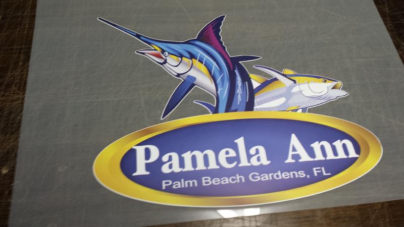

This is my second attempt to use this siser color print PU, I cant get it to transfer to the TTD Easy Mask!! I even ran one through my laminator rollers three times.
Siser you tube shows a effortless 123 done. doing 4 x 3.5 pocket logo and 2 out of 5 don't mask. Tried doing two 13 x 11 back shirt and just wasted two in a row.
TDD Mask is what Siser recommends, print weeds nice at 30 force and prints great, its just useless after that.
desperately in need of some help, thanks
attachment is before mask

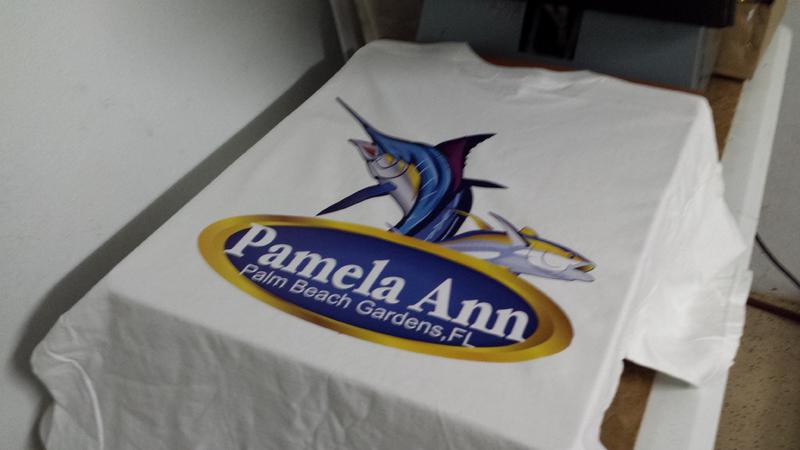

I tried this sharp edged table method, only added another step, I heated the TTD mask on the hix 800 to approx 100 deg then removed from backing flipped over and continued to heat tack side up,No I did not close the lid lol, Used my temp gun to monitor heat, This made it very pliable and a lot easier to apply,then used your table method it was still a little trickie to get started but I was able to do a 13.5 x 11.5 transfer,
with all that said WAY TO TIME CONSUMING for ony one shirt
