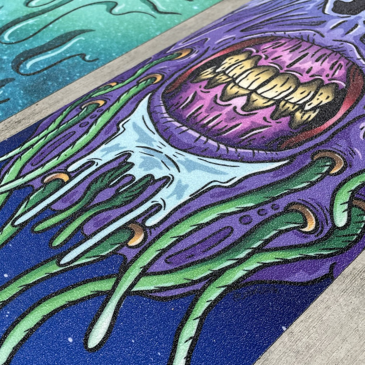

That's because you're using a non surface curing ink technology. I've attached a photo of what we can achieve on UltraGrip via direct to surface, 6 color UV.
bteifeld
Substratia Consulting & Printing;Ergosoft Reseller
Thank you for that nice image of your printwork.
I was wondering- are you using a CMYKcm or CMYKOG as a six ink configuration?
Also- do you clearcoat on top of the print, or just print and out it goes to the customer?
SGC
I'm not aware of any individual color options in UV yet, but it's a CMYKlclm
UV curable ink, in regards to anti slip tape, when it leaves the print head, it falls into the grains and groves of the surface, then the light hard cures it to the surface. Nothing is done after this. It's cut and shipped to customer.
Graphic grip tape sold in skate shops by the big brands is printed one of two ways:
UV curable directly to the surface of the off-the-shelf grip tape sheet - this is what's considered the correct way to print the product.
or
Solvent printed to the adhesive liner prior to adding the resin and grain to the liner, so the graphic is underneath the clear resin and grip grains. This is a massive undertaking and is only common in China, as you have to have a legitimate manufacturing facility since you're dealing with mass-applying the grain yourself. This also yields a lower image quality, since you're viewing the image underneath a cloudy layer of resin and grip-grain. But, for facilities in china that mass produce this stuff, the faster speed of production solvent machines, the significantly cheaper ink costs and not having to risk damaging printers and print heads by exposing them to grit-sand make this the low-cost manufacturing choice.

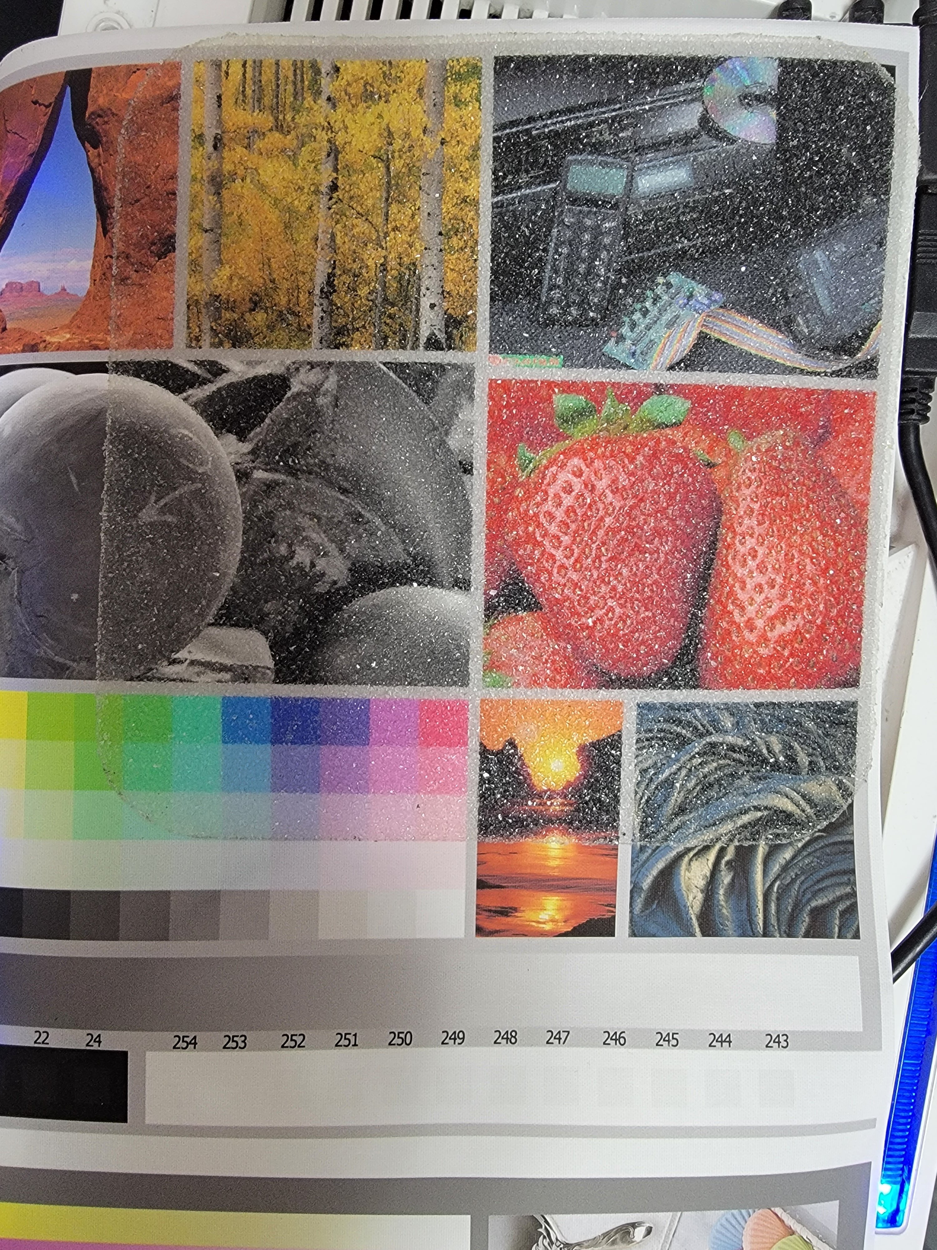

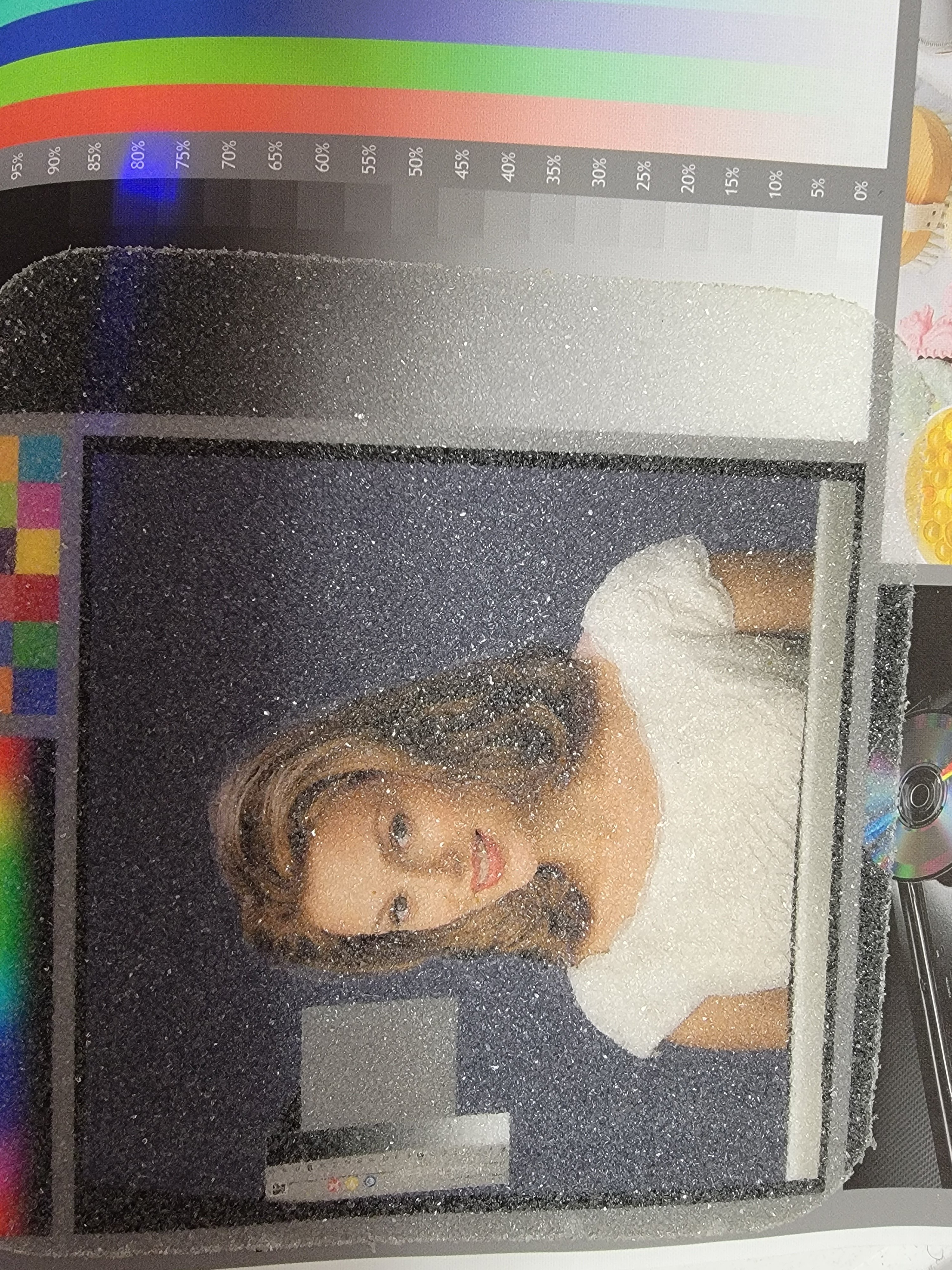

I hope this message finds you well.
Thank you for mentioning Wooster Products to me. I was pleasantly surprised by their
coarse clear griptape product as to how well it preserved details on some printer
test images I use to check my media configuration work on my print process.
It is not as good as my roll-my-own solution, but it looks like it might be good enough
to let me be a bit lazier/more efficient by avoiding manufacturing. I have attached the
areas of imagery I used for my testing.
SGC
That's what I love to hear!
I don't know if you're using a rubber laminator or not to marry these, but something tells me a heat assist laminator would get you an even better visual output.
bteifeld
I don't know if you saw the version of my message with the test images attached, but you may want to look at my message again.
I presently have a GBC slot laminator that has heat assist, so once the roll comes in, I will try that too.
I remain grateful for your comments/help.
