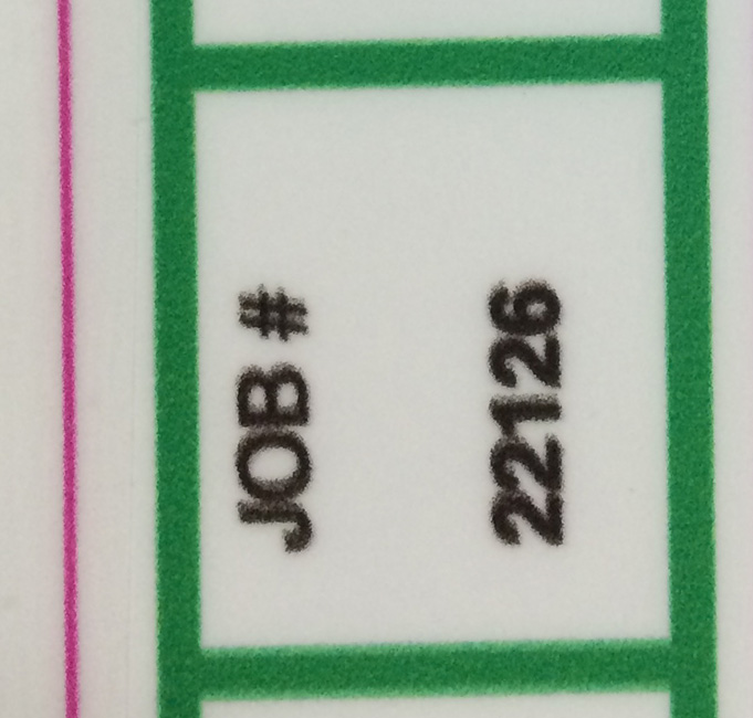

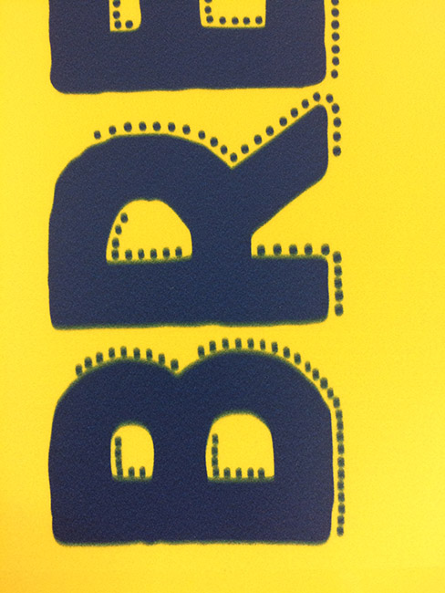

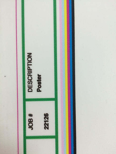

Just yesterday it all came together. Printing a poster that was only 1000 x 700mm, one of the workshop guys brought it back to me and said it's not straight, it doesn't fit the frame. We measured it, and sure enough one edge was 8mm shorter than the opposite edge. Thinking the guy had trimmed it wrong (I never make mistakes of course, it couldn't be the file...), I asked to see the scrap, and sure enough he'd cut it to the exact crop marks. And looking closer at the print, there was a definite alignment issue on one side. Here's the kicker though - the alignment issue wasn't on the scan axis, it was on the feed. One side of the media had fed 8mm more then the other, over just 700mm of print length.
Here are the pics:
attachment.php
attachment.php
attachment.php
As you can see, scan axis is pretty good. But you can definitely see inconsistencies in the feed axis, especially with the blue on yellow, where the top of the pic has okay alignment but the bottom is way out. Restarted the printer, printed it again (same file from the rip, just dragged back up and hit print again), and it's perfect.
So this has me thinking that it's all related. For some reason, after the printer has been on for a while, it starts having brain farts and glitching. Maybe it has something to do with how it comes out of sleep mode??? How a software glitch could cause one side of the media to feed at a different rate to the other I don't know. I would have thought for sure that the rate that the rollers move the media would be locked. And it can't be a mechanical issue, like the media is somehow slipping, otherwise why would simply restarting the printer fix it?

I appreciate all that feedback, but you must have missed the part where it only happens after the printer has been on for a while, the same as the lag. When you first turn the printer on, and for the first couple of hours, it is perfect. No lag, no skew, no head strikes.

As I mentioned earlier it shouldn't be because of the take-up. The issue occurs whether we're using it or not. That poster from the photos was so short that it didn't even touch the ground hanging out of the printer.
FTR, did another poster last night, 1600mm long. One edge measured 1589mm (crop mark to crop mark), the other 1566mm. So it's running short, with 23mm difference on one side to the other. I've left the printer off all night and am about to print it again with a cool fresh machine. Will see what happens.

This is not the issue. What you're describing would be the media itself shrinking or distorting. That's not the issue - the ink is being dropped in the wrong position because the media is feeding unevenly and skewing.

I see where you're coming from, but I don't think this is the issue. For one, this recent media has never been on the takeup reel. Secondly, after that first dodgy print, the media on the roll had a big crinkle from the uneven feed, so I trimmed off a good 1.5 to 2 metres of it before feeding it back in to the machine.
The nail in the coffin though is the media that first did this - it's a typical roll of grey-back pull-up film. We'd gone through probably 10 rolls of the stuff, sometimes on the takeup, sometimes not, and it had always printed flawlessly. Out of the blue it did the uneven feed. I'm absolutely positive that this is a software / electronic glitch, not a mechanical limitation.
