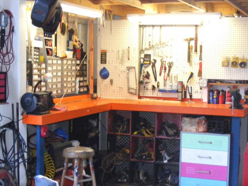

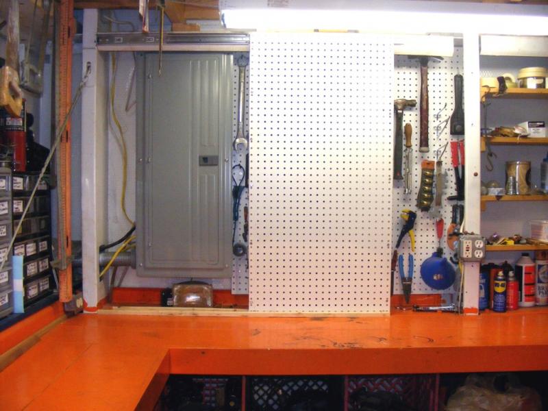

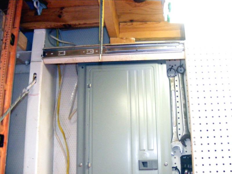

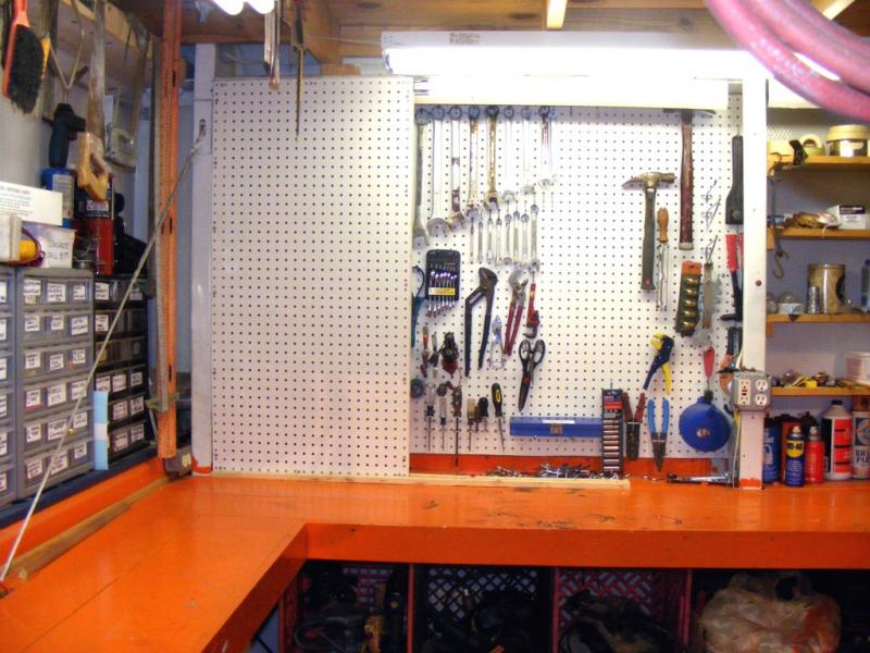

finished a small project today in the shop. my L-shaped shop workbench is also where my 200 amp electrical breaker box resides. its dead space that i figured out how to use. got a 24" cabinet drawer ball bearing track, mounted it to steel grit above electric box. built a 22" x 43" peg board with 1"x1" wood frame. attached drawer side of track to this. put a 3/4" x 3/4" wood tracking guide to workbench so pegboard stays in the track. now i gota figure out what iam gona put on it)))))

OldPaint
124L..... 1 shot!!!!!!!!!
i really hate workbenchs that when you drop a screw/bolt/nut/washer or some small dark part, it blends in with the workbench. with an ORANGE bench, the only thing you wont find with ease......is an ORANGE PART))))))
Dentafrice
Looks great, but I'd keep it slid over when the inspector comes... def against electrical code as that doesn't provide working space in front of the panel with it closed.
OldPaint
now thats news to me. as long as electrical box integrity has not been compromised...... which is the case here, ive seen these same boxes in metal buildings enclosed and hidden,behind panels, but with total access, not be a problem with inspectors.
Dentafrice
I've not read up on the NEC in a few years, but I could have swore all disconnects and panels needed to have a certain amount of working space in front of them..
OldPaint
this still has the "working space" available to access the box. its no different then putting an access DOOR over it if you wanted to hide the box.

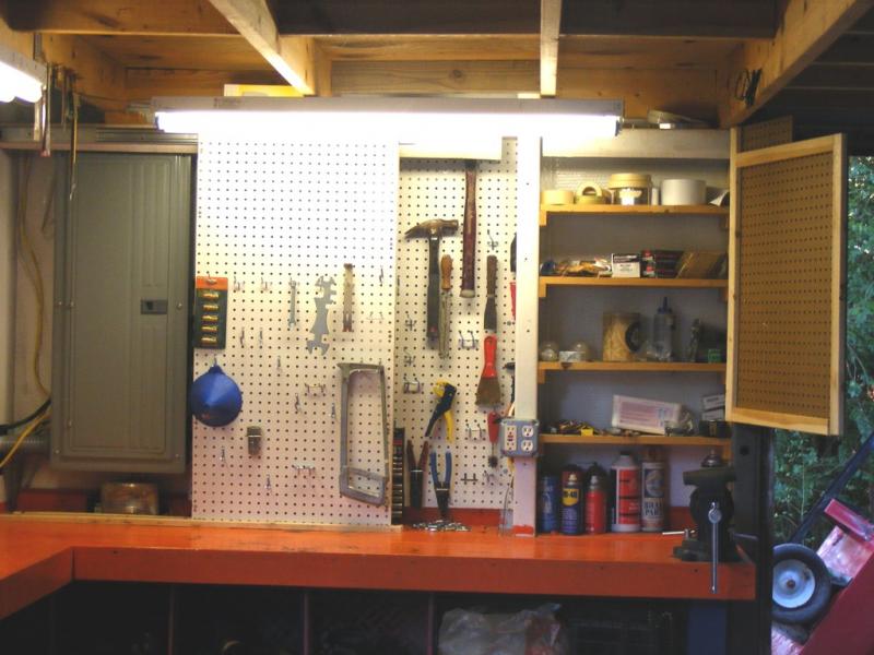

added this little 23" x 31" swinging door like pegboard panel over some existing shelves i had to the right of the workbench.

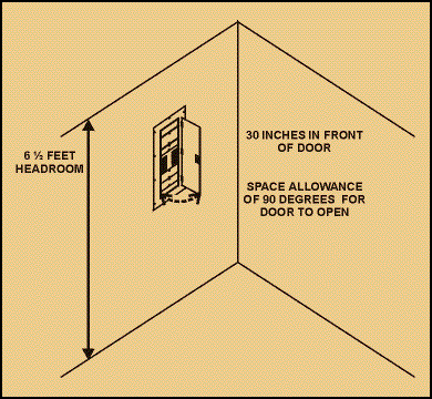

phototec
You are in violation of the National Electrial Code
OP, you are defently in violation of the National Electrial Code (NEC).
The National Electric Code requires min. 3'0"
there are several rules defined in section 110.26 of the NEC; for 600 volts or less it is:
  • left to right the minimum clearance is 30" or the width of the equipment, whichever is larger
  • in height, there should be 6' 6'' minimum height to stand in front of the equipment
  • the depth in front of the equipment varies depending on the voltage and surfaces of the opposite wall behind you: if the voltage is 150 volts to ground or less the depth of clearance is 30": as stated above; if the voltage is higher it depends of whether the opposite wall is insulated or not: if insulated the depth is 3' 6", if not insulated (such as cement block) the depth is 48"
I refer to these rules as the "refrigerator rule": the clearance in front of the panel in question requires a dedicated clear space roughly the size of a large refrigerator.​
Your orange work counter is a violation of the NEC, you can't have any structure in front of the panel, for servicing, you need to stand directly in front of it, not bending over the work counter.
I'm not trying to argue or debate with you, only siting the NEC, because I'm very familiar with the regulations regarding the area in front of the load center panel and have been dinged by inspectors in the past.
You can't have anything blocking access to the panel!

OldPaint
there is a sticker inside the panel...............PASSED ELECTRICAL INSPECTION! i was instructed by the ELECTRICAL INSPECTOR as how to mount, where it was mounted, clearances and i had to have 1 GFI plug-in receptacle and 1 light wired with a switch to pass inspection. it did that. same inspector told me whatever i want to wire after that was none of his concern. also this is NOT a COMMERCIAL building. it is on RESIDENTIAL status. so fire inspector never come here. as for the workbench being in the way, it was there when it PASSED INSPECTION. you can still stand directly in front of it the workbench is only 16" wide. this is not the 1st electrical install i have done. i worked as a draftsman and did many metal buildings. some like i said, the panels was covered by a door, so the interior wall looked finishd.
