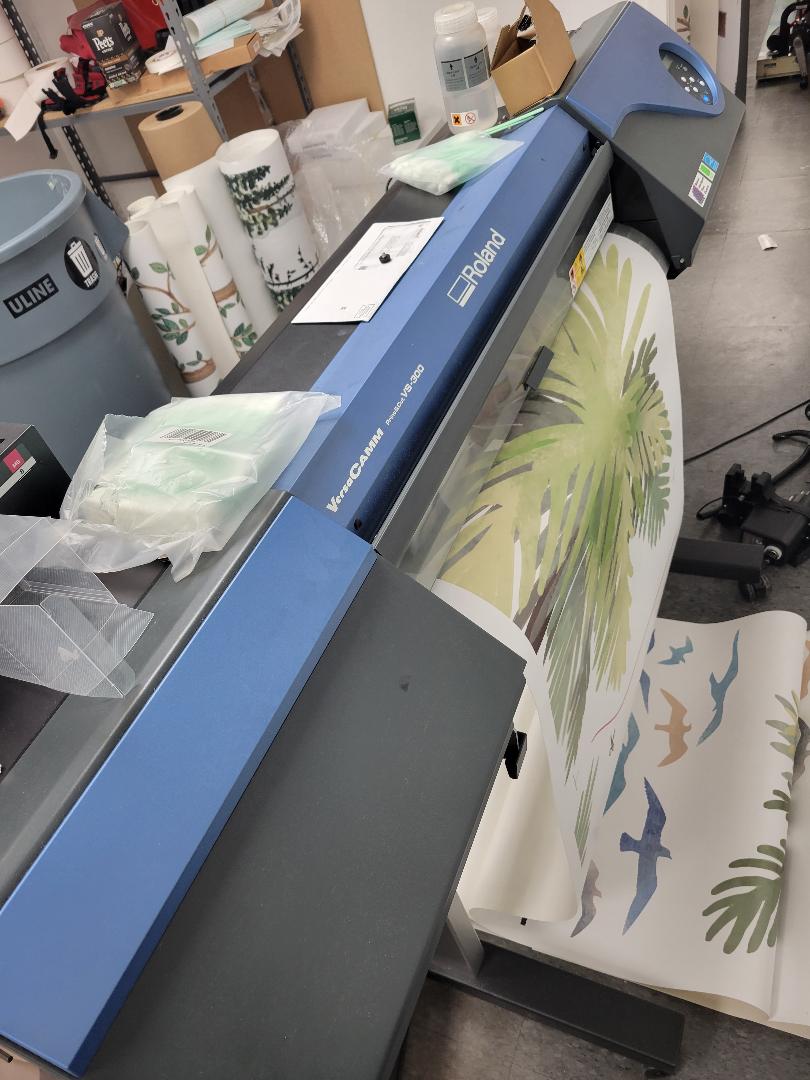

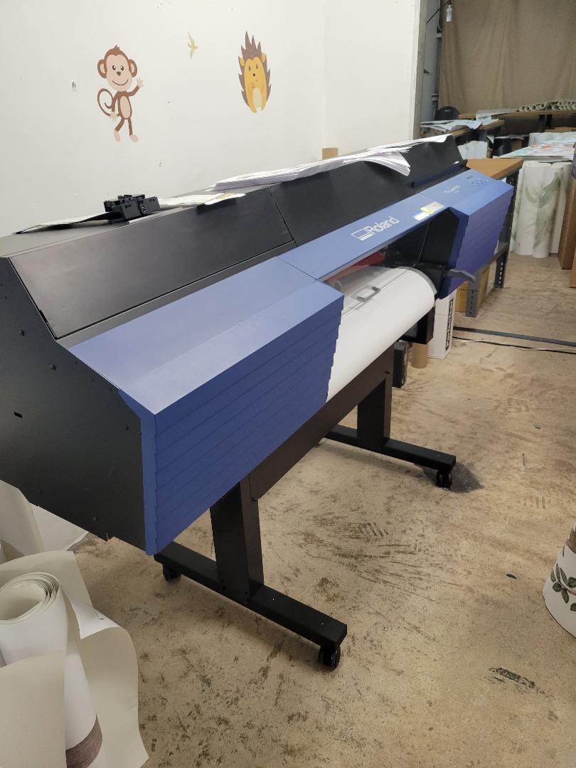

I think finding a used 30" roland would be a better long term solution as those machines can print fast enough to make decent profit and take on bigger jobs. Also you can easily cut 60" rolls or 54" rolls in half to use on the 30" machines greatly expanding the materials you can print without waste compared to the BN20.
I see you are in the Houston area - I have a vs300 or a SG2 300 I could sell
