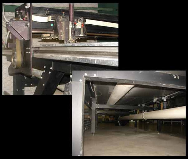

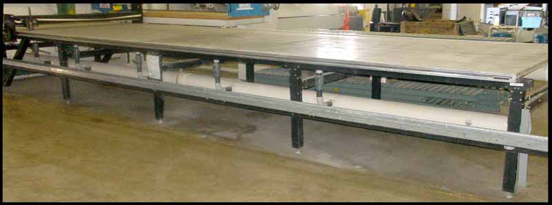

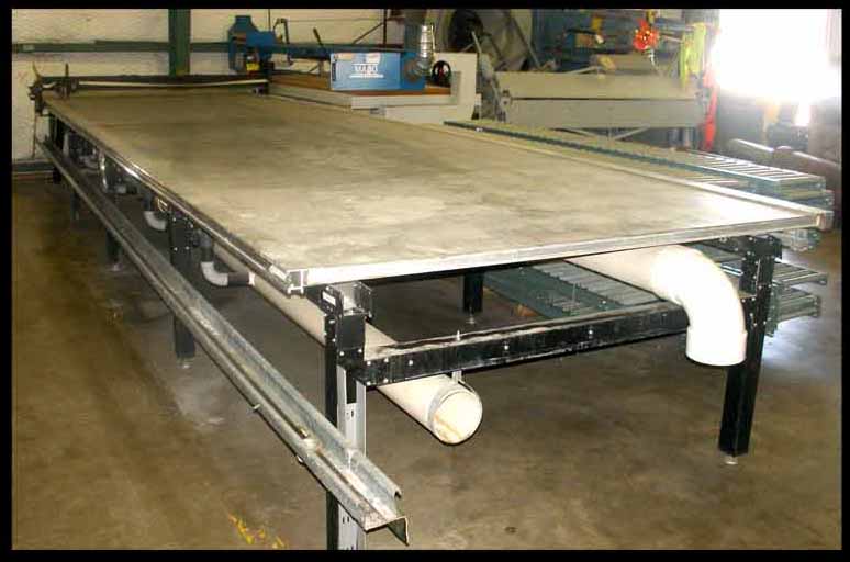

i finally decided to build my own. i bought this gantry table yesterday on ebay and now i'm figuring out which printer to strap to it. after 10 years of pinch roller flatbeds i am done. it's hurting my business, holding back my product options. i thought i could master the beast but it can't be done.
you't think that these printer manufacturers would at least add a fore and aft pinch roller. that would really straighten things out between the head carraige. but that would require actual RE-engineering.
i saw this funny thing as SGIA. there was mutoh 1304 perched on a glass flatbed marked as "prototype". they must be joking. chinese companies have been strapping these to that exact table for years. maybe they bought it off of alibaba and plopped it in the booth?

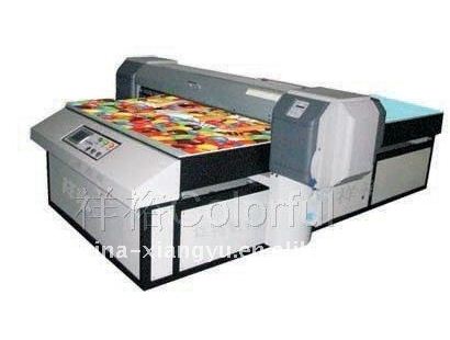

no matter what you or what you spend FLATBED ONLY. the worst flatbed from china for $14,000 can do things a $30,000 pinch roller from roland or mutoh can only dream of.
check out the 7' x 24' table! arrrgh!!!!!! i can smell the money!

MikeD
Brilliant!
You will be way ahead of the game...you will have the ability to control virtually every variable that interacts with your production. This will certainly pay off for you, good luck!
Great Job!
