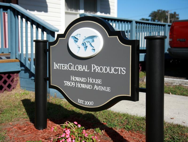

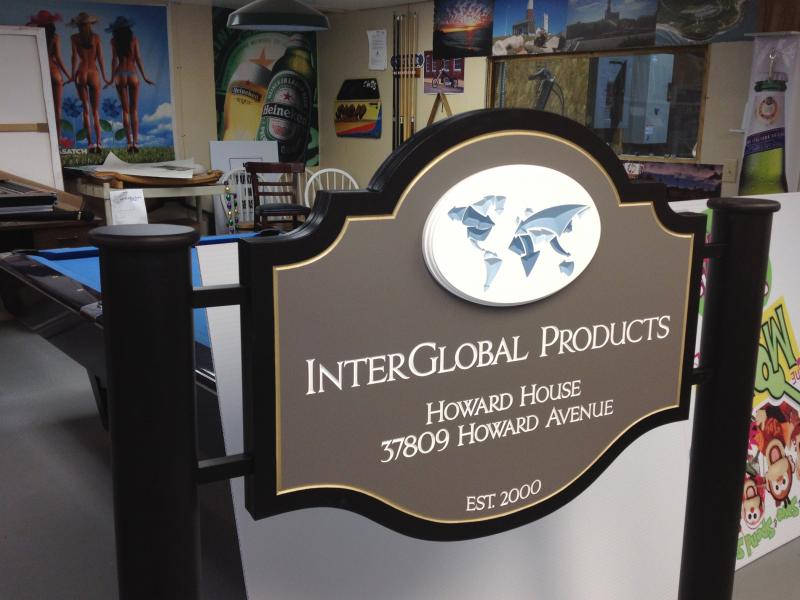

What technique did you use to do the carved parts?
I sandwiched 1/2" threaded rod between two faces that go through the post with aluminum square tube spacers between the sign and the posts. The post are made of 4" PVC pipe and the caps are made from 3/4" pvc. All carving is v-carved into the face. The logo is separate 3/4" plaque also v-carved. All paint finish is exterior latex premium.
