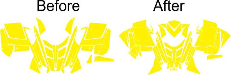

Nope, no easier way. I do have 2 sleds sitting in my shop right now. All areas that i will be adding to the template will be done with pre-mask tape & pencil. After that all pieces getting stuck on white board, writing real measurement for every piece. After that, simply snap a picture with the phone, drag it to software, trace & size it up. Takes time, but for me its worth it when you see that your customers getting 30-50% more coverage compare to competition wraps whos using regular templates.
reQ
Here is the difference for example on RMK template that you can get online & the one with addons.

Well, that depends on how good you did with tracing. I am doing it for 2nd year already and my stencils are usually spot on after 1st try, but sometimes still need some adjustments.
What i would suggest you to do - cut your template from cheap vinyl, install it, then trace pieces that you would like to add, that way you will see where it has to be.
