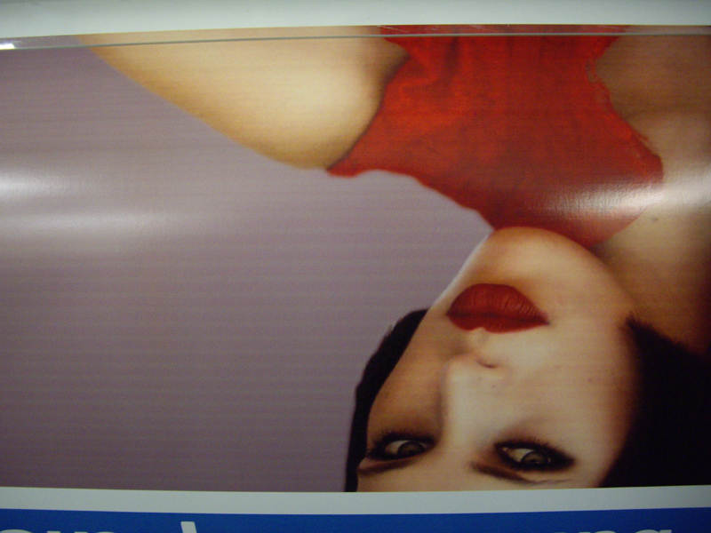

I've had a SJ-745EX for several years now, running it with Onyx Postershop.
I find to get prints that are free of banding on vinyl I have to run it at 1440x720 which is slow. 720 bands noticeably especially on solid fill areas.
Banners print fine at 720 though.
So is this just the nature of the beast or are there tricks I'm missing?
I'm doing print for pay and have to pass on large jobs because it would take a ridiculous amount of time to deliver.

Banding is caused mainly due to incorrect feed calibration. Missing firing nozzles can also contribute to this also.
You should be able to print in 720x720 on vinyl with no banding.

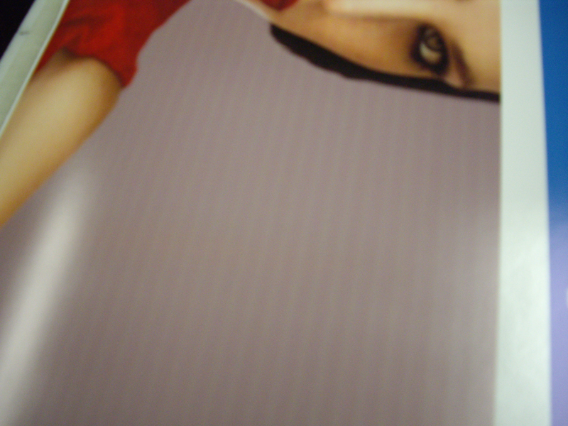

Yes I know.. "should" being the operative word.
As an example. A couple of pics 720 on photo paper.

Is your RIP software controling the feed speed? If so turn it off .. let the printer itself control that.
Jack Knight1979
that looks like bad dampers to me.
if you have old/bad dampers your test prints will be fine because there is ink in the heads, but as you print your heads are being starved due to poor through-put from the dampers.
To find out what dampers are in question create 12"x12" tiles of each color CMYK in illustrator. Start printing these until you see which heads are missing color.
If you start to get banding stop the print job (pause, setup) and then to a test print right after. If you have auto clean on make sure to turn it off before you do this. You don't want the heads to do through a cycle before you can isolate the bad head.
Once you've found the head in question which looks like a LC or C from the picture change out the dampers and try again.
If you're using aftermarket ink you're in a whole new world of isolating the problem. I use triangle inks my faults are usually pressure related to the bulk tanks.
I also keep a service log keeping track of changed dampers and other parts. It's good practice to swap out your dampers every six months or sooner depending on how much printing you're doing.
I hope this helped. I don't think it's a problem from your rip. Although another factor could be that you are not putting enough ink down on the paper and causing the head to starve out. that has happened to me when I first started building profiles.
So if the dampers look good in your color bar test than you may want to pump up the ink flow by 10-20%.

Alright I printed a series of single ink swatches and the magenta looks in pretty bad shape. Maybe time for a new head since it's almost 5 years old.
Pretty sure the dampers got swapped last service.
Just wondering - if it's out of warranty is there some info on doing your own service on these beasts and best place to buy parts.
TIA guys you're a great help.
Check HEAD Alignments and Shot count...maybe your heads are worn out (6 billion shots is an "average" life of a head...more or less). Call your Roland Service Tech, he will get it printing great, and save you time, wasted media, frustration, and money as well.

Anyways I feel a bit foolish.
The tech came and did a proper clean of the heads etc and now it prints fine.
I'd only ever did a clean exactly as the video on the install Roland CD showed. He actually showed me how to clean the heads properly. He swabbed underneath them with the foam swabs which I had never done before.
So I need to clean more frequently it seems.
I had been only cleaning when ink drops started appearing on the media.
