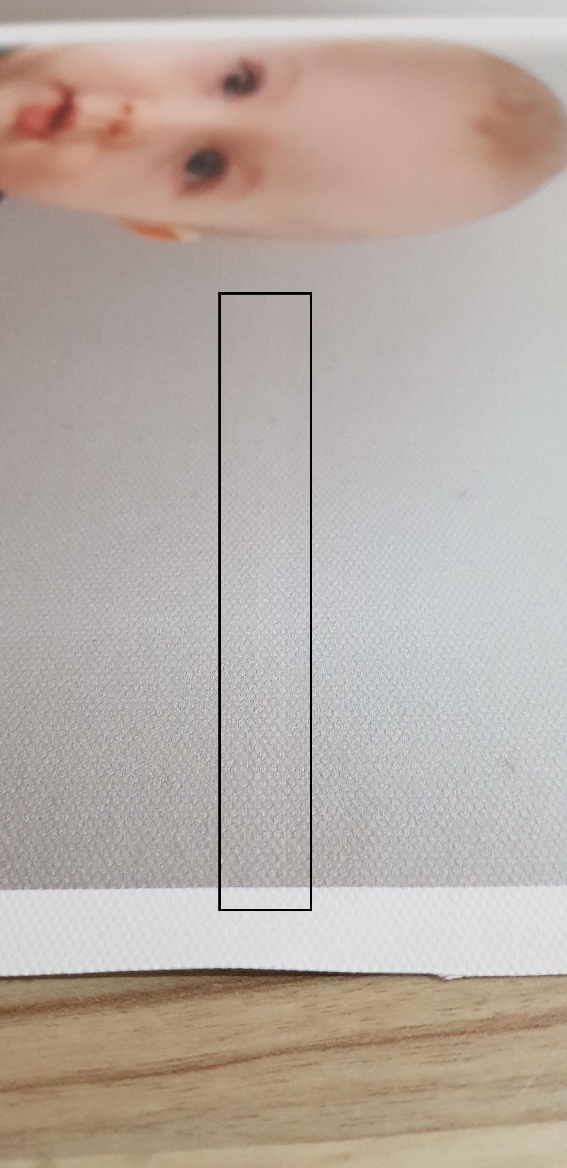

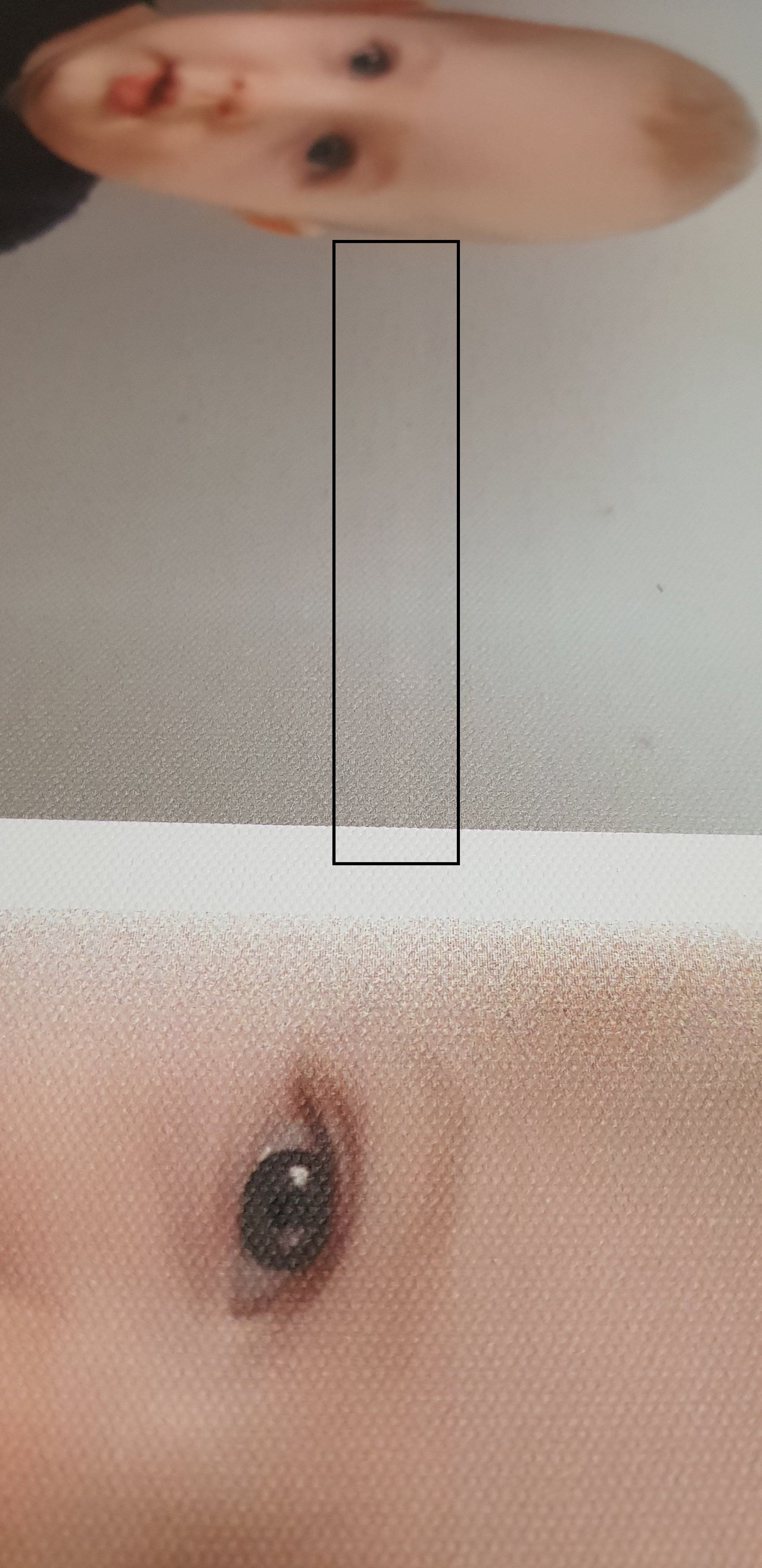

Hello, i need a little help, sorry for my bad english :)
If i print some graphic on canvas or vinyl or other material i have a line on grapic after printing (see in attachement).
What is wrong can someone help for me. Thanke you very much.

Hello Norman1987,
That looks like banding, when you do a nozzle test, are you missing any nozzles. If you are it could be that is causing the issue and you may need to reach out to the local tech to replace the head as a worst case. Also if that happens on this file alone it could be something in the file that the software is picking up.If you have any other questions please reach out to Roland or your local Dealer.

Thanke you. I take out a encoder strip after a make a hard cleaning with alcohol pads and take a encoder back after i make a encoder sensor clean and now is everythink ok. For short time because on encoder strip are missing some line. I think this is a problem. I order a new strip and monday i replace a strip and i think after was been ok. :)
Head noozlle is ok
