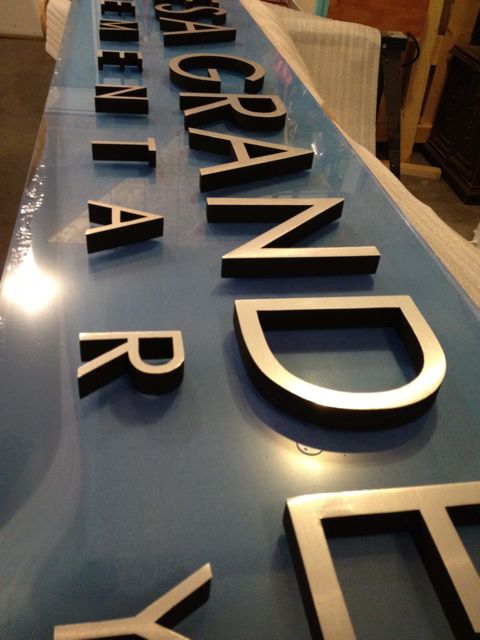

The First Sign is 1" HDU with brushed silver Vinyl faced Mounted to 1/2" Clear Plexi, going to be installed with 1" silver standoffs. 20" x 96"
This is for a movie set so I can't show the whole sign!

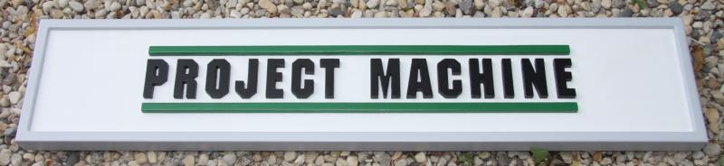

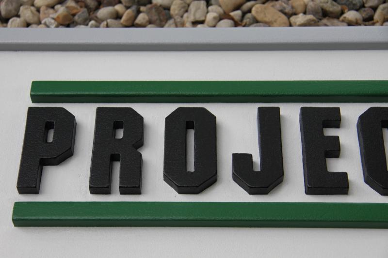

The second sign is 1" HDU hand carved out of one piece of stock. 10" x 48
