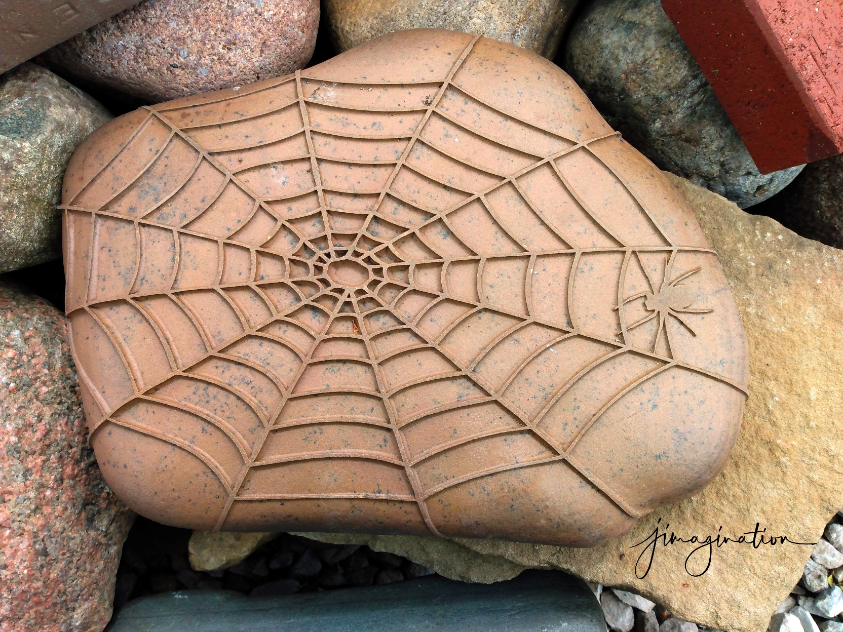

I've worked with CNC as a toolmaker since the mid 80s, and there's no way it could duplicate something like this.
16" River stone, reverse etched - approx. 3/32" to 1/8" depth. Sign vinyl stencil. Approx. 20 minutes blast time. I'm assuming roughly 90% of the stone's original surface was etched away.

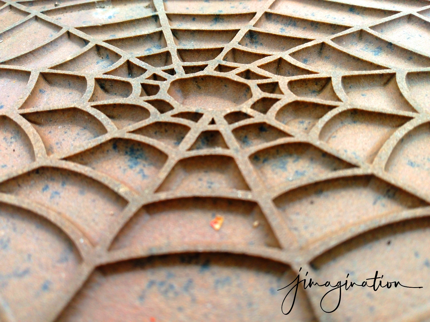

It's a hard, dense stone with extremely small grain structure...the perfect combination for obtaining fine detail. It also permits the abrasive to flow across the surface like water...producing those awesome looking corner radii and blends.
I especially like how the mooring (anchor) threads seem to "hug" the stone inward in various places.
